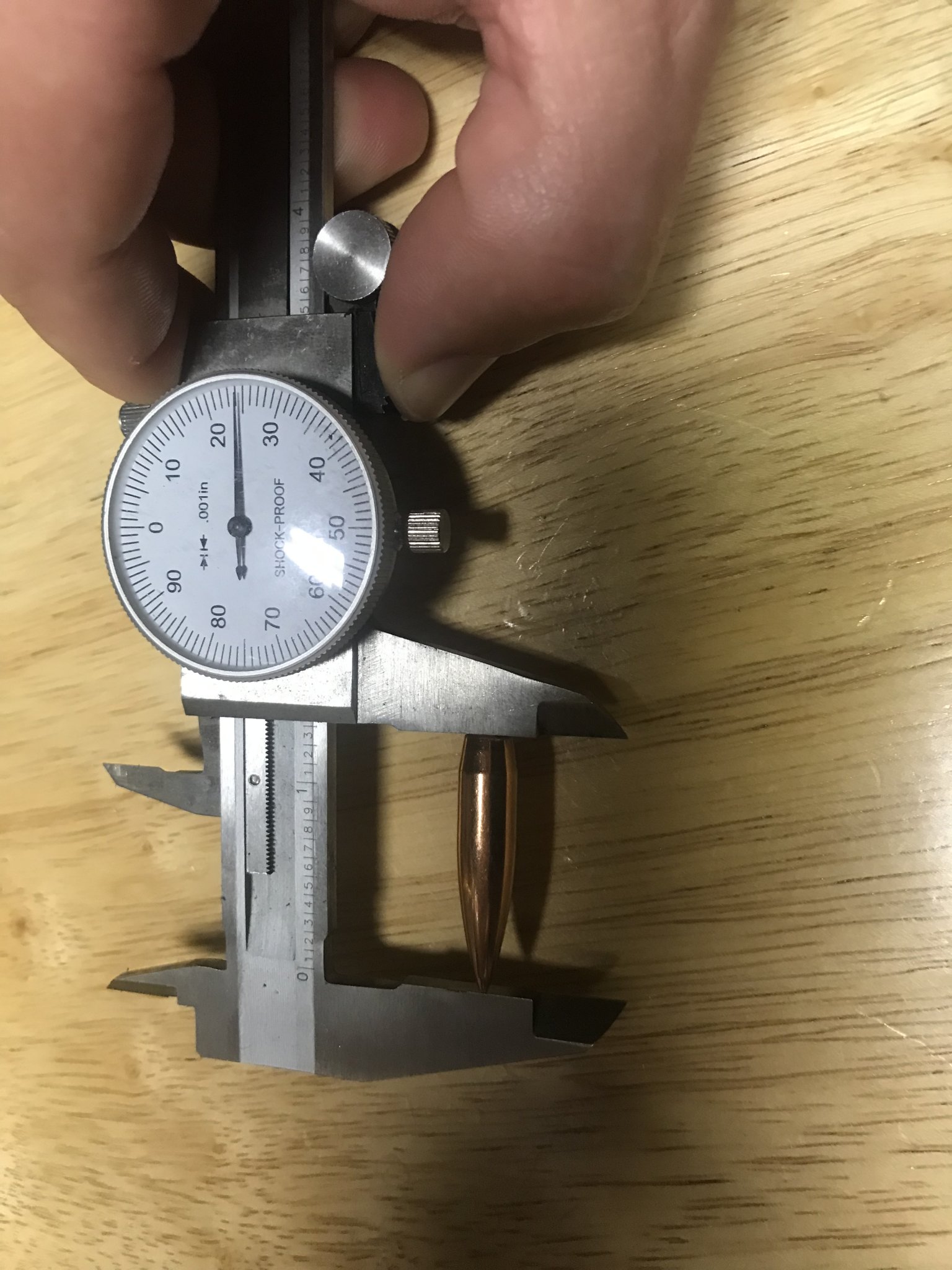

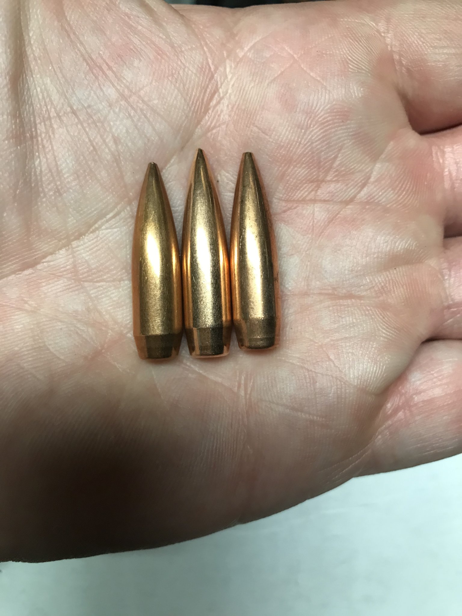

That’s a 168, 169, and a 175.

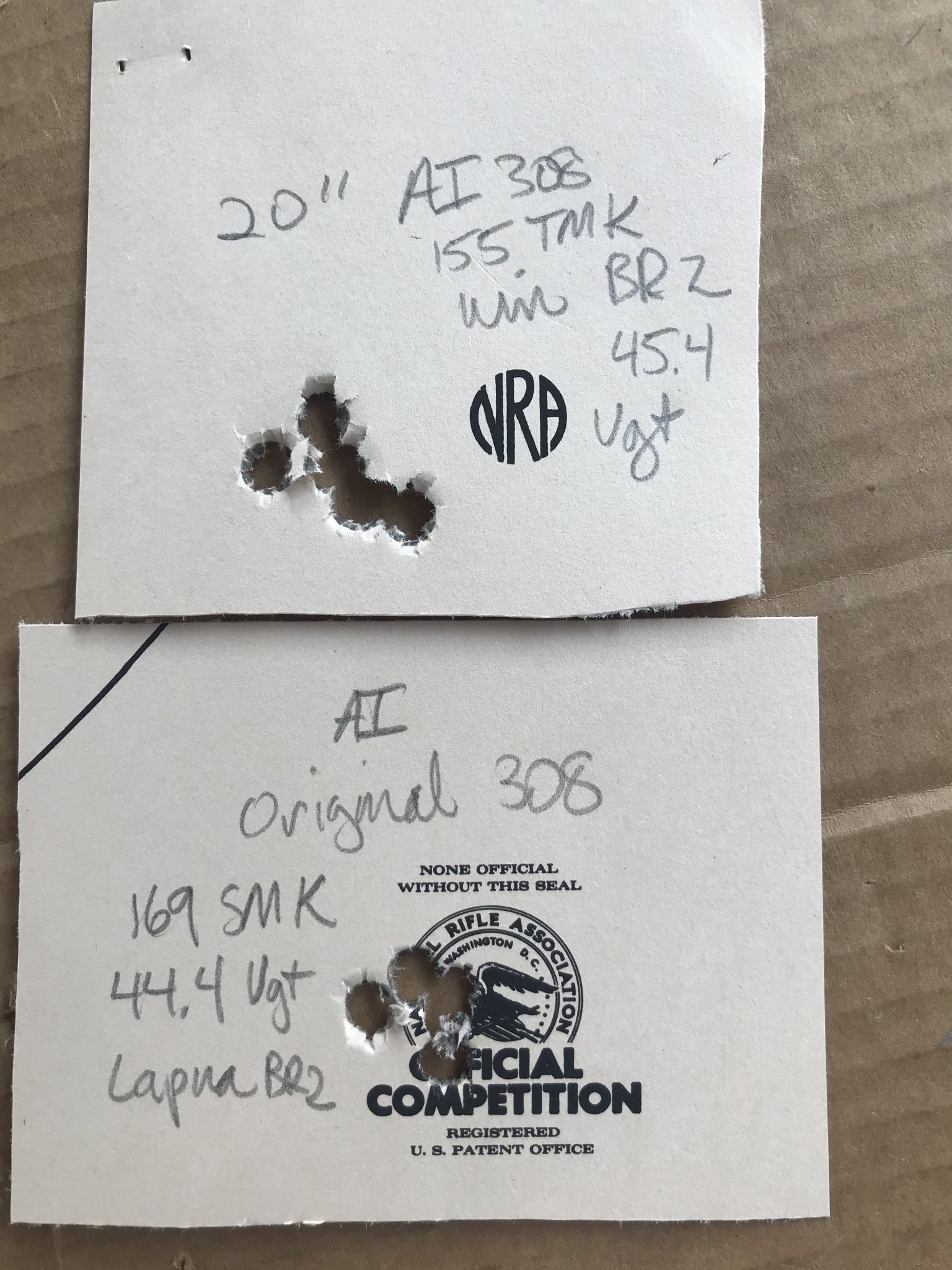

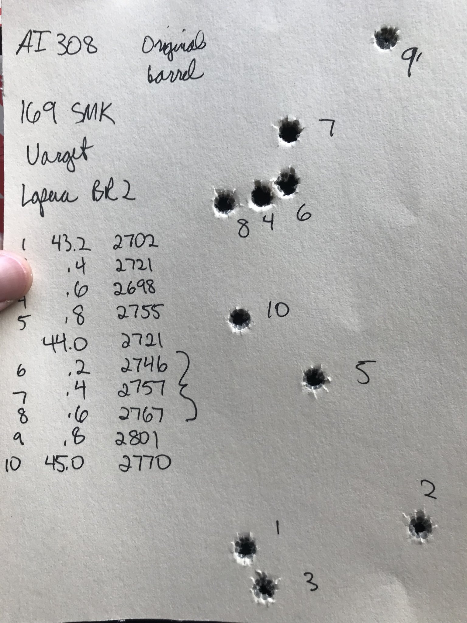

I’ve had a chance to shoot these. Sierra has done well.
I’m using 44.4 grains of Varget and getting around 2,750.

2750 out of a 20” barrel? Not bad.
I’m running 45.3g Varget with virgin Lapua brass and getting around 2650 over a Federal 210M primer.
24” barrel. That 20” note refers to a different barrel.
I was also checking return to zero for different AI barrels.

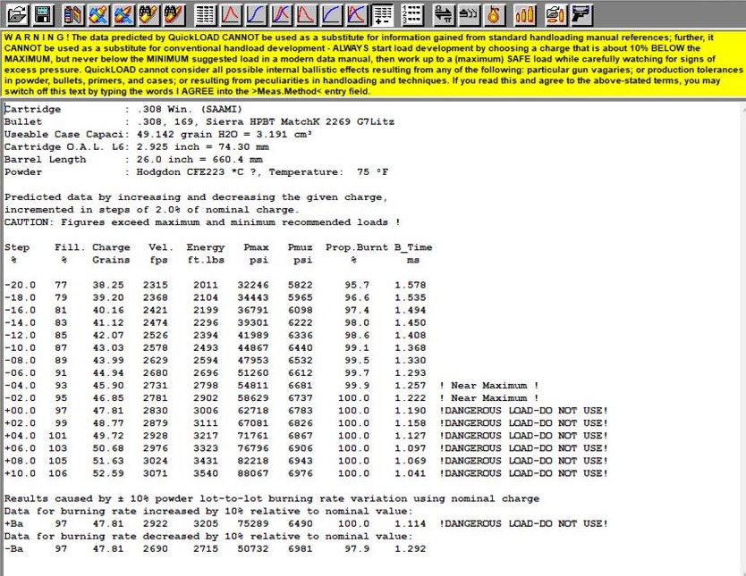

It'll be interesting to see yours compares to the CFE223 I had. I haven't use this powder for my 169 SMK's, but this is how I estimate my CFE223 would perform with them the way I tend load them:

Yes.. we‘ll see. always work up a load. I also have Varget, XBR, TAC to try.
