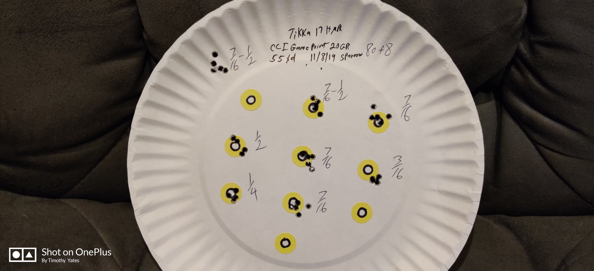

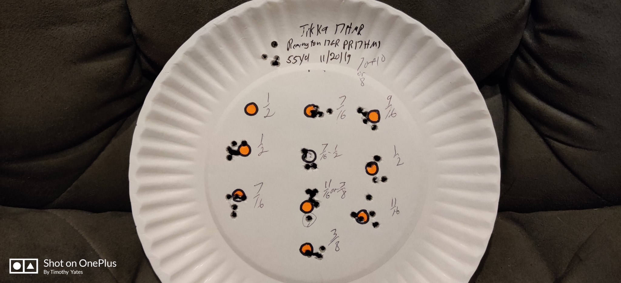

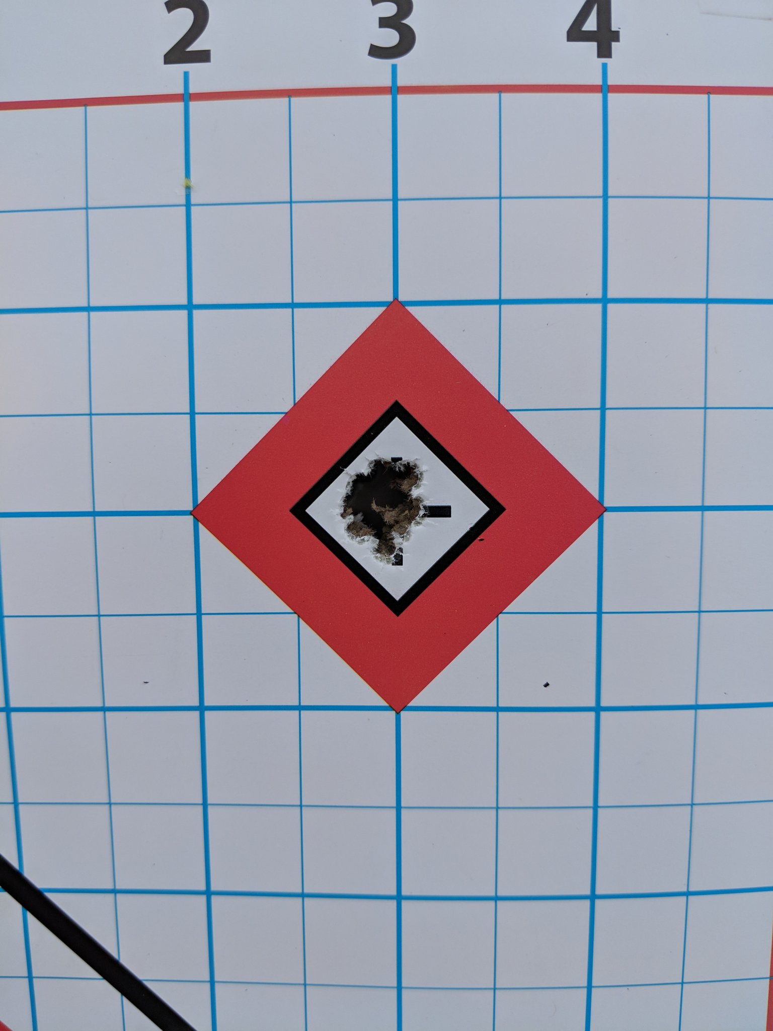

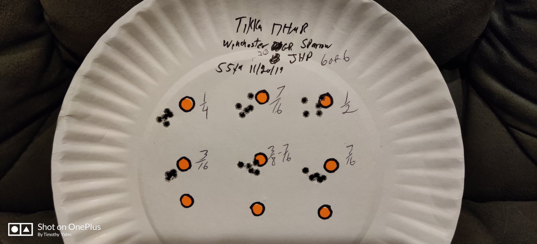

Recently shot Tikka 17 HMR results at 55 yards. I was low on ammo on two. All shot with my Silencerco Sparrow except the 2nd group. I was comparing the Remington with and without the Sparrow. It was the only brand of ammo that I had enough of to this. What I am trying to show here is that the Tikka 17 HMR shoot pretty good. At least mine satisfies me.

Looking at y'er results, that's not the rifle or you.
Those odd fliers are poorly assembled cartridges.
Canted seating, bent plastic tips, uneven seating depths, variations in oal.
Ammo quality is messing with your results.
