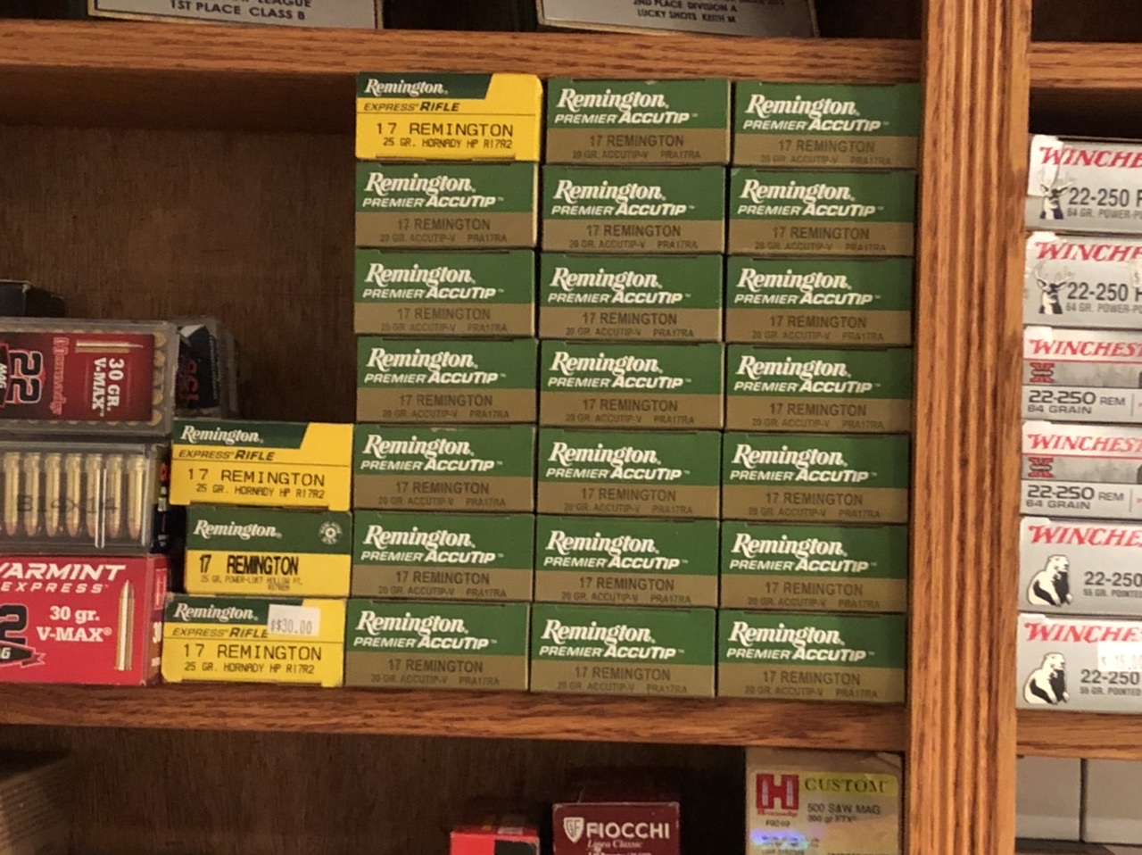

I have acquired a 17 Rem in 700 BDL.
It has a 24” barrel, don’t currently know the twist rate. I have lots of factory Remington ammo in 25 and 20 grain.
Curious how far you can consistently push these little guys?
The 20gr peter out fast because the BC is quite low, maybe by 400Y??? and they will blow in the wind a lot??
25gr will do a little better. I've seen pics of guys hitting steel at 500Y with the Vmax but it was an improved 17R version.
I used the Kindler 30gr Golds with .28BC in my 9 twist and those actually are quite impressive at 550Y, we shot them at 675Y but it was hard to spot hits on the steel.
Reactions: Deets
Maybe when I start reloading I’ll try some heavier ones. My son loves shooting it.
