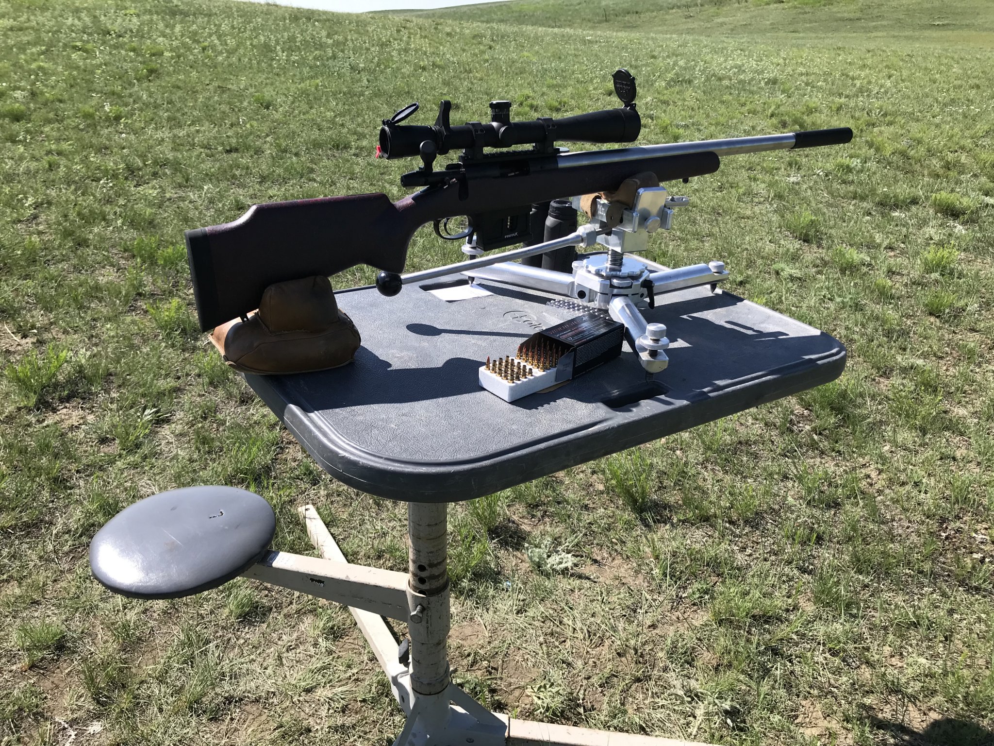

Great little cartridge - although - the 17 HMR is probably / generally more accurate. I used mine on last years PD shoot and had a blast - shot it more than all of my centerfires combined. Was killing PD's from 50 to 250 yards. But - I saw the writing on the wall and had bought a truck load of ammo for it when I got my rifle built. Ammo is currently somewhat hard to get but Winchester did a production run a couple of months ago so there should still be some out there.
Just got my 17 wsm RimX action in and ordered the 17 hmr/22 mag bolt as well. Figured when i ran out of my several thousand rounds of wsm i can swap bolts and barrel and shoot either 17hmr or 22 mags. Basically whatever i have ammo for at the time.
Any feeding issues with your setup or advice going forward with my build? Have yet to acquire barrel blanks. What grove/twist you running?
The Rim-X magazine allows you to tune it's position slightly up / down to allow for the best feeding ( it was fairly easy to set that up ). So, I 've got it feeding very smoothly. No issues feeding or extracting.
The barrel is a 9 twist. (y)
