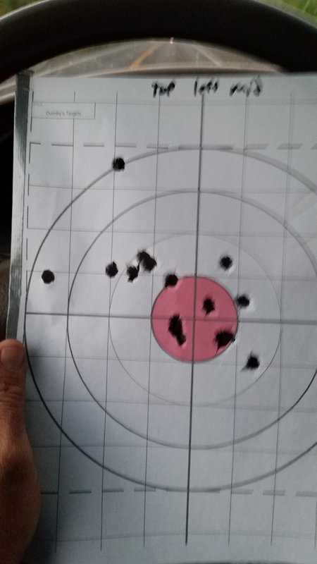

So here's what the 175 rdf does in my savage 12fvss. Stock gun mounted in a bell and Carlson medalist. Shot from prone no rear bag. It's pretty comparable to th 178 hornady bthp I have been running but cheaper. I'm sure it drops less out farther though and bucks wind way better. I haven't been able to try that load any further out yet. Will post bk when I get the data
cheers, Andy
Can't see in pic details but first white ring outside bull is 4inches OD. Load is 5x win brass, 175rdf, win Lr primer, 43.5 grain imr 4895. Think velocity was right abouts 2670fps. Es of 12 or so. I know I can refine that a bit.
