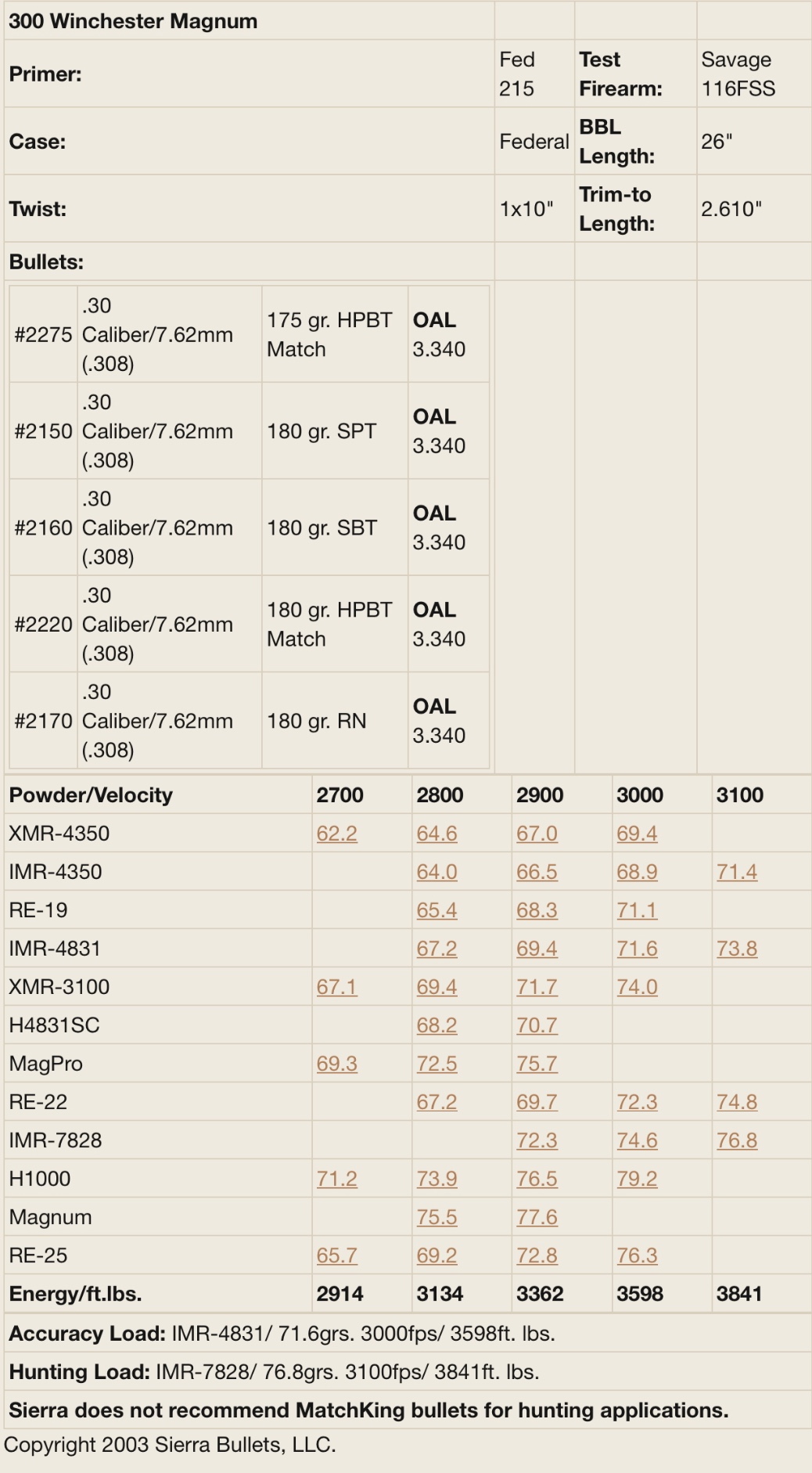

I was wandering if anyone has reloaded any 175 smk in a 300 win mag. I'm getting ready to do some playing around and thought about loading the 175's in a 300 since I have a bunch and shoot them in my 308.
I am looking at using two powders to start out with. The Sierra manaul has 71.6grs of IMR 4831 as their accuracy load. I also am going to try using 76.5 grs of H1000. Both will be pushing the bullet around 2900 to 3000 fps.
I'll set the bullet to be about .010 from jam lenght as a start.
If you guys have loaded a 300 with the 175's let me know what your findings have been.

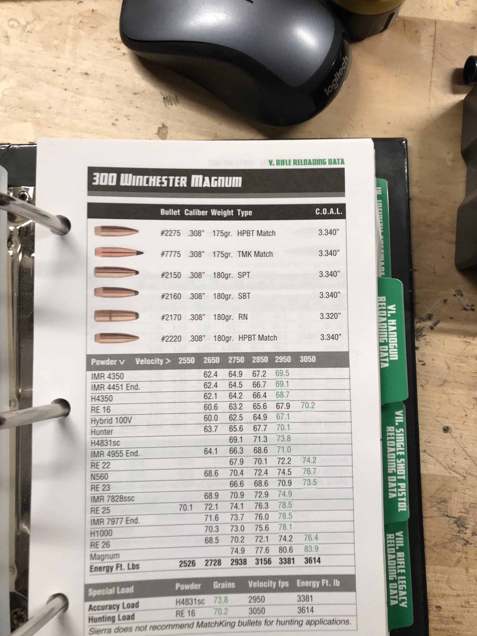

Was planning on doing this and bumped into this ancient thread during a search.
Thought it would be awesome to bring it back to life…
It reeks of the stench of a dozen years!…
Not with a .300 win mag but just got done doing it in a .300 RUM. I had a few hundred 175 TMK left over from trying to get my .308 to a 1000 yards and I had recently picked up a Remington RUM in a hunting chassis. I did a little swapping around and now have it in a MagPul stock and slapped a Nikon FX scope on it, Worked up some loads ( that sucker eats a LOT of H1000 ) and it does great at 1000 ! If I'm not mistaking it was pushing them at about 3200 fps

Rifle’s really not meant for any of that.
It’s a Tikka T3x SS Lite in an aluminum chassis, unthreaded barrel without a brake.
Magazines are length - constrained, can’t “load long” unless chambered individually.
Not really built for the “heavies…”
Probably going to be unpleasant to use.
It’s more of a “might as well make something out of it” build.
Hoping that lighter bullets would be less punishing.
And, I don’t really want to buy more bullets :ROFLMAO:
