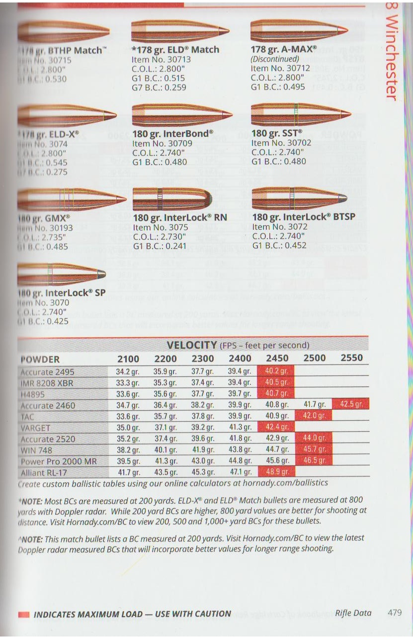

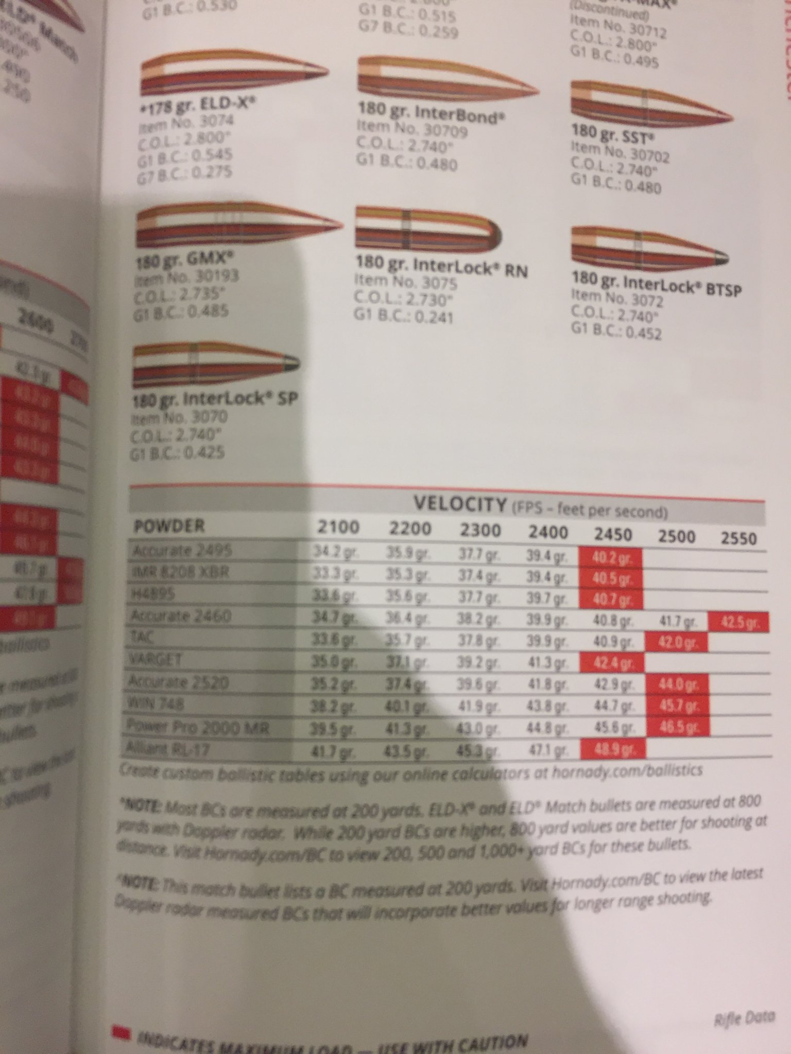

I am having trouble finding established load data for the 178gr ELD-X bullet for my .308
Anyone have a min and max load from Hornady in the 10th edition or elsewhere? I’m using 9th and nothing. I generally use Varget but I wouldn’t mind seeing 4064 as well even though i should get a higher FPS with the Varget.
In addition I wouldn’t mind seeing the minimum and maximum FPS if it’s not too much trouble.

From Hornady max was 42.1 of Varget. Probably in Hornady brass.
I am slow at about 41.3 in Win brass.

Thanks everyone for the info. The hornady data has a extremely low charge for the max charge for Varget and I started getting pressure signs just above their max load. I'm also using Federal brass. Going to try some norma brass and also get a magneto speed or lad radar to see if my fps is above hornady's listed speeds, I've heard that hornady is notorious for posting them low.

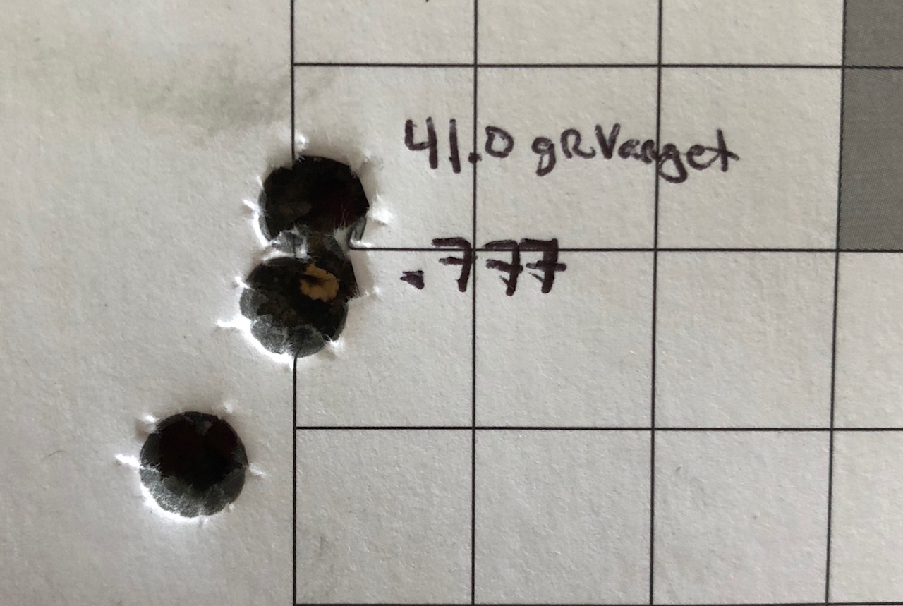

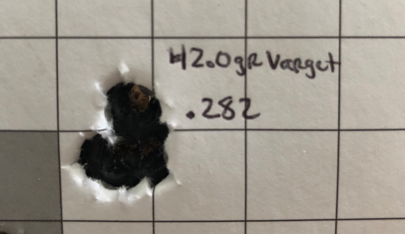

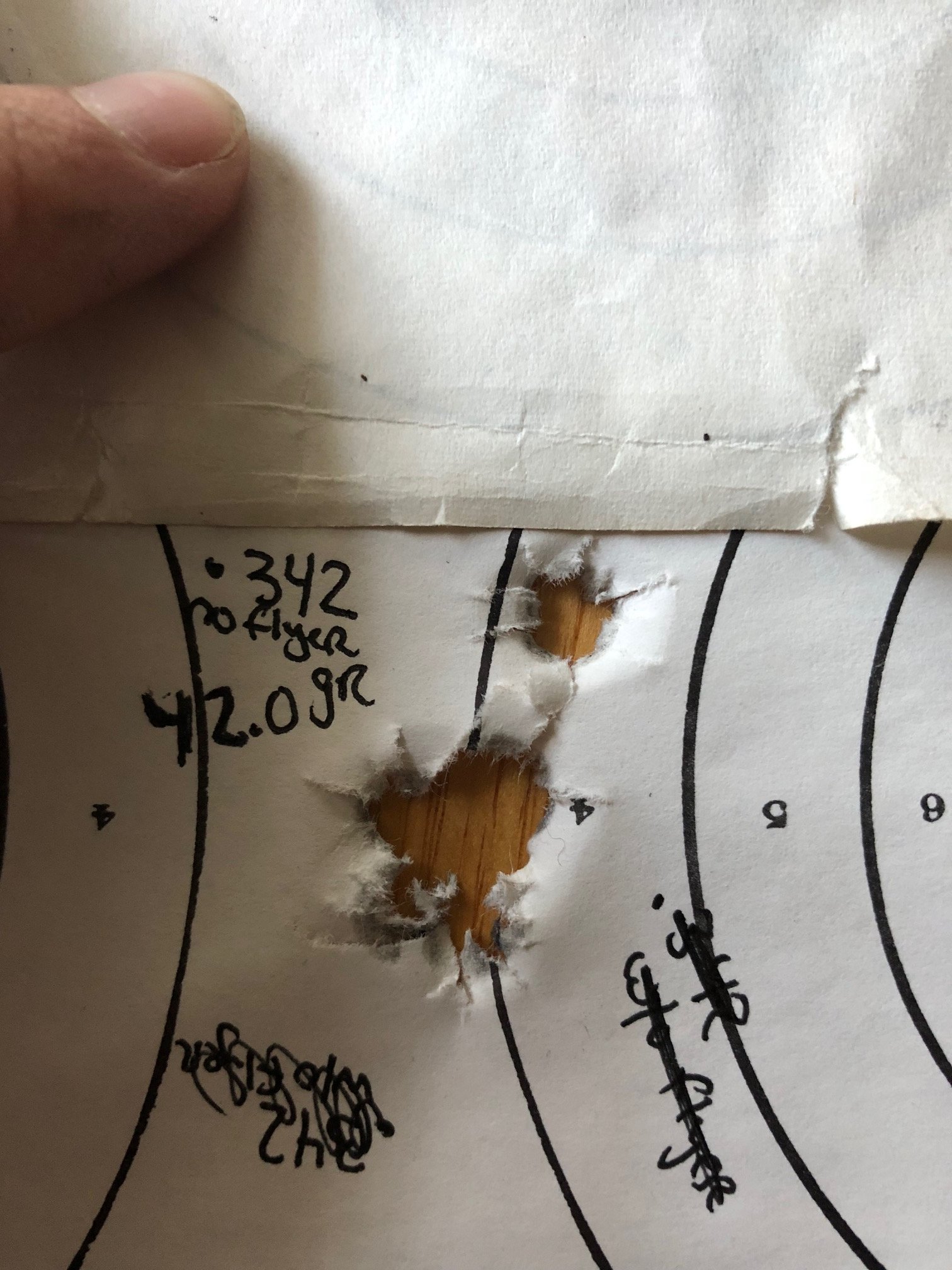

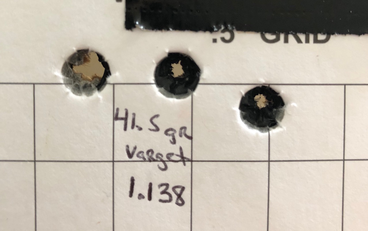

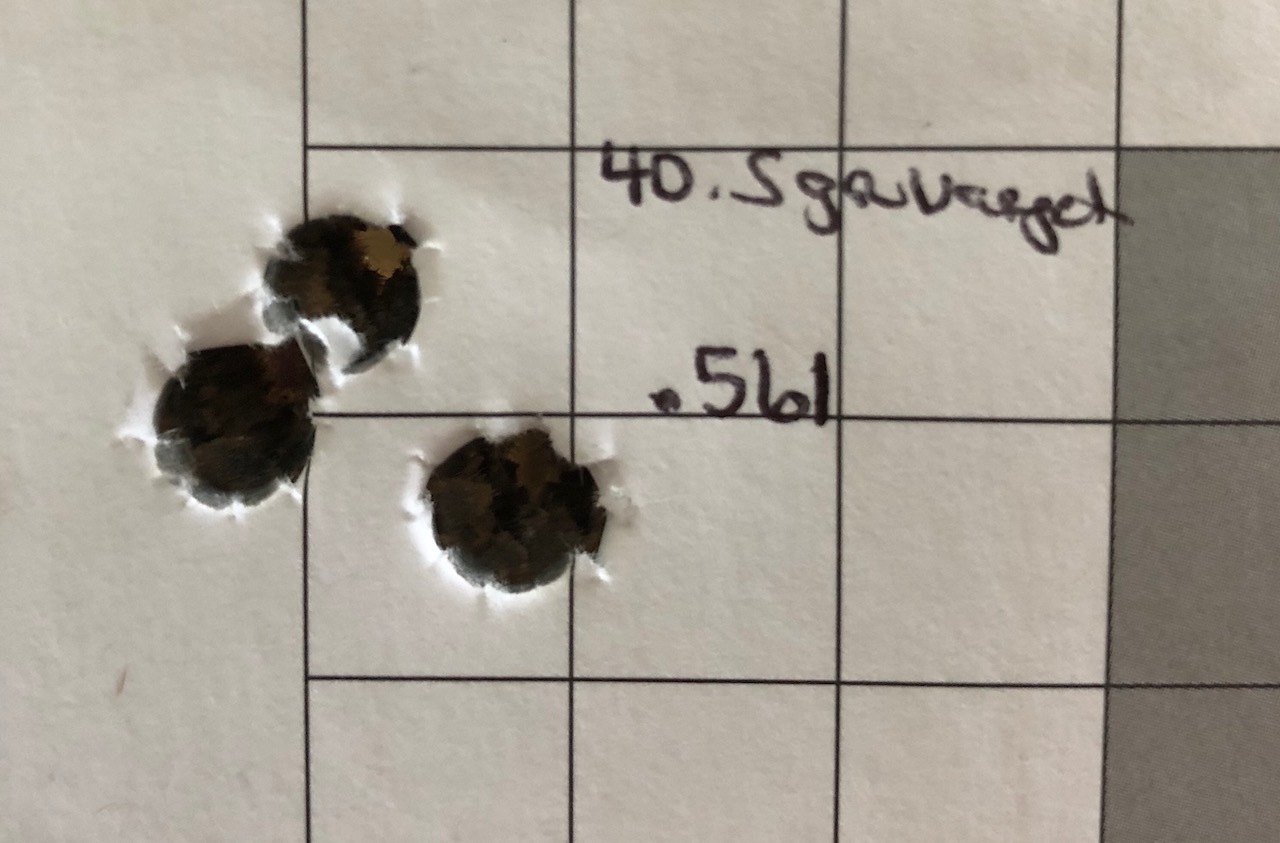

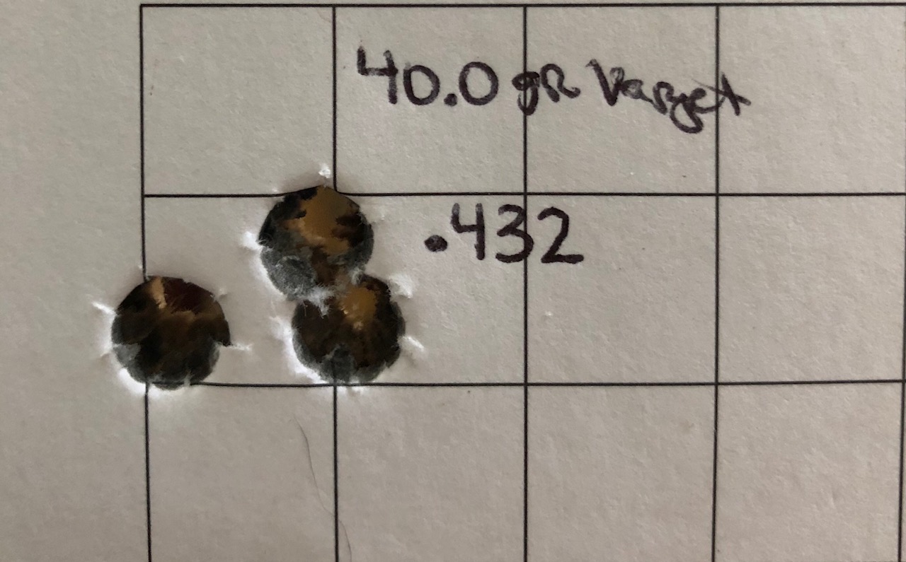

I was able to load up three rounds of varying charge weights from 40.0 to 42.0 (.5 increments) today to check initial accuracy and velocity in the 178 ELD-X's.
Velocity was measured using a Labradar. ES and SD are to be taken with a grain of salt due to the low amount of shots taken per charge weight.
Accuracy is measured edge to edge subtracting bullet diameter with a caliper.
Brass: Prime (Norma) 2.008 +- .005
Primer: Federal Gold Medal Match 210M
Bullet: Hornady ELD-X 178 Grain
Powder: Varget
OAL: 2.858 +- .001
Rifle: McMillan Tac-308 Schneider 11.25 Twist 26"
Scope: Bushnell DMRII 3.5-21x50
40.0 gr Varget
Average FPS 2528
SD 11.2
ES 20.34
Group Size .432
40.5 gr Varget
Average FPS 2560
SD 14.3
ES 26.96
Group Size .561
41.0 gr Varget
Average FPS 2606
SD 30.69
ES 54.77
Group Size .777
41.5 gr Varget
Average FPS 2622
SD 14.07
ES 26.89
Group Size 1.138
42.0 gr Varget
Average FPS 2666
SD 3.64
ES 7.26
Group Size .282
Promising results at 42.0 grains. Next step will be to load from 41.8 to 42.4 in .2 increments in 5 shot groups.

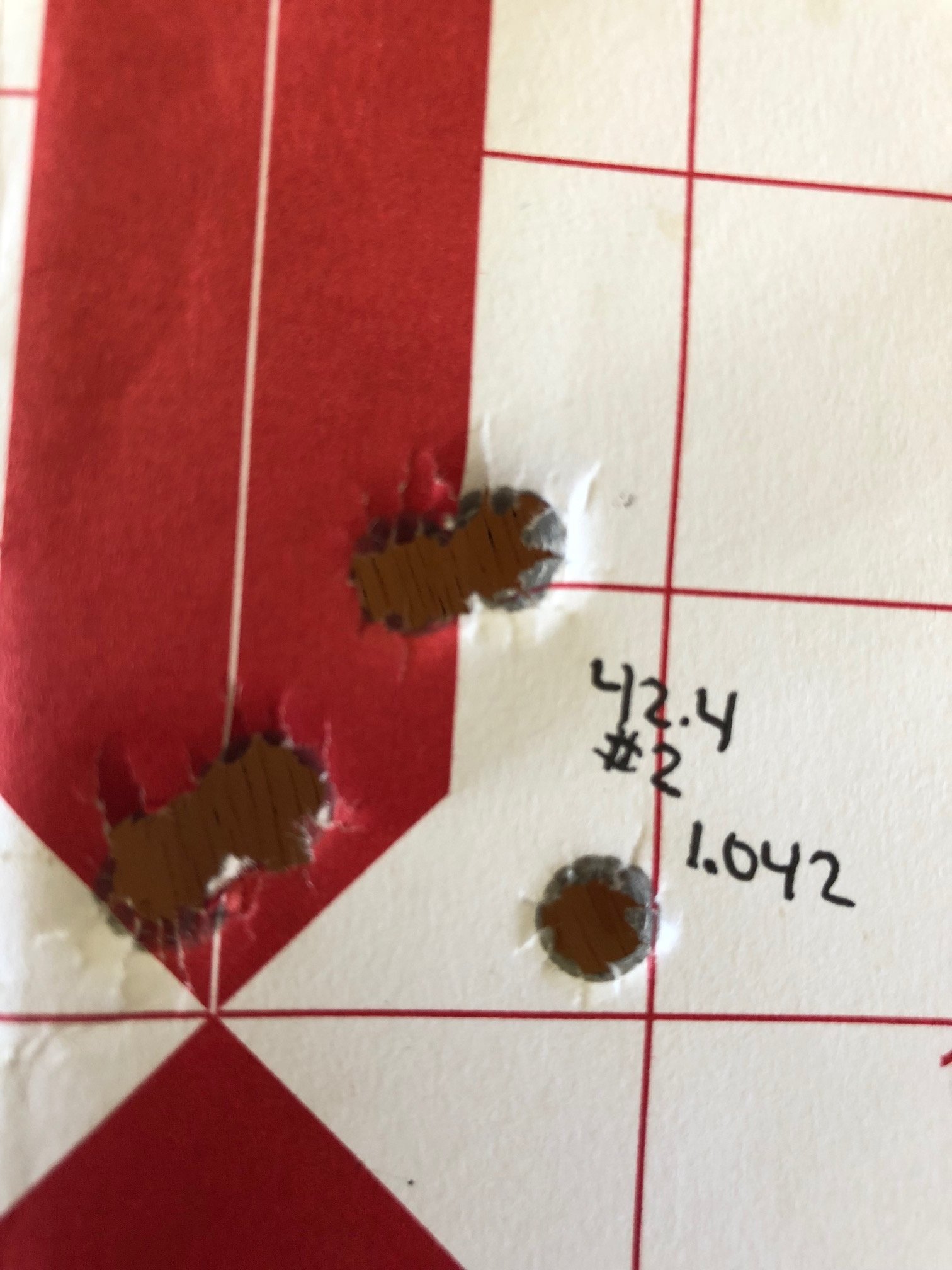

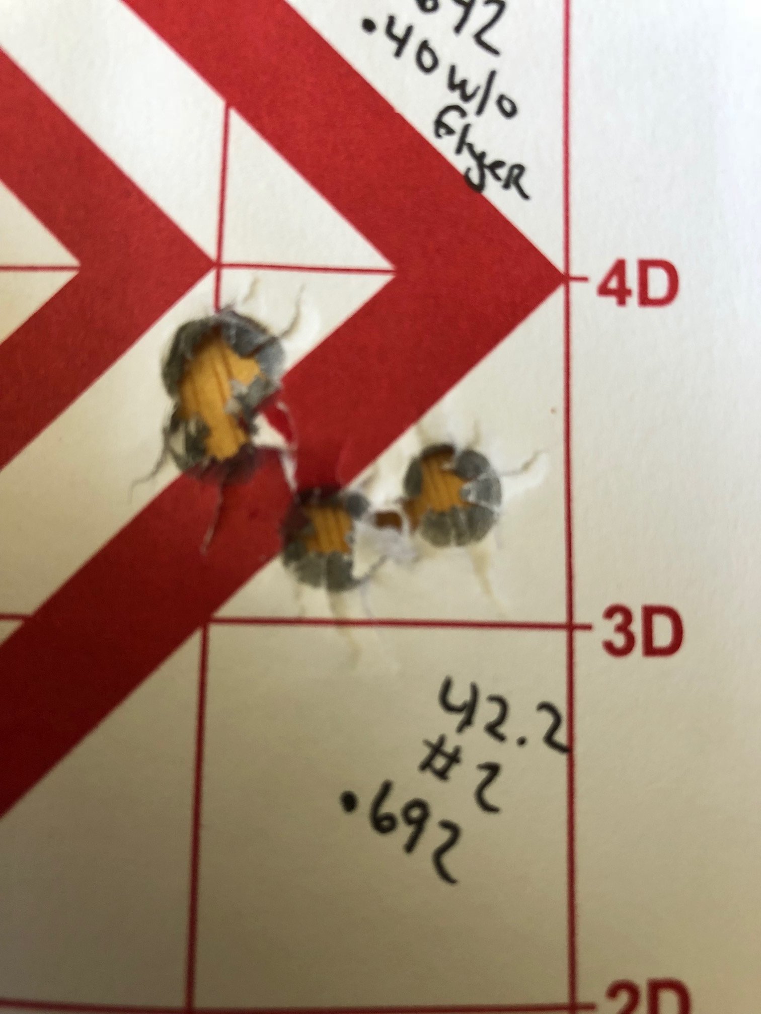

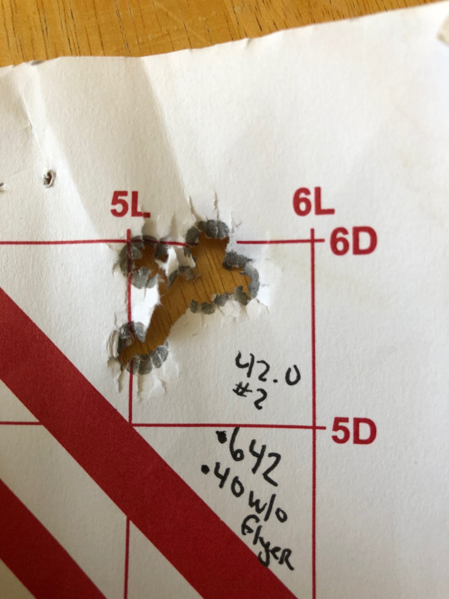

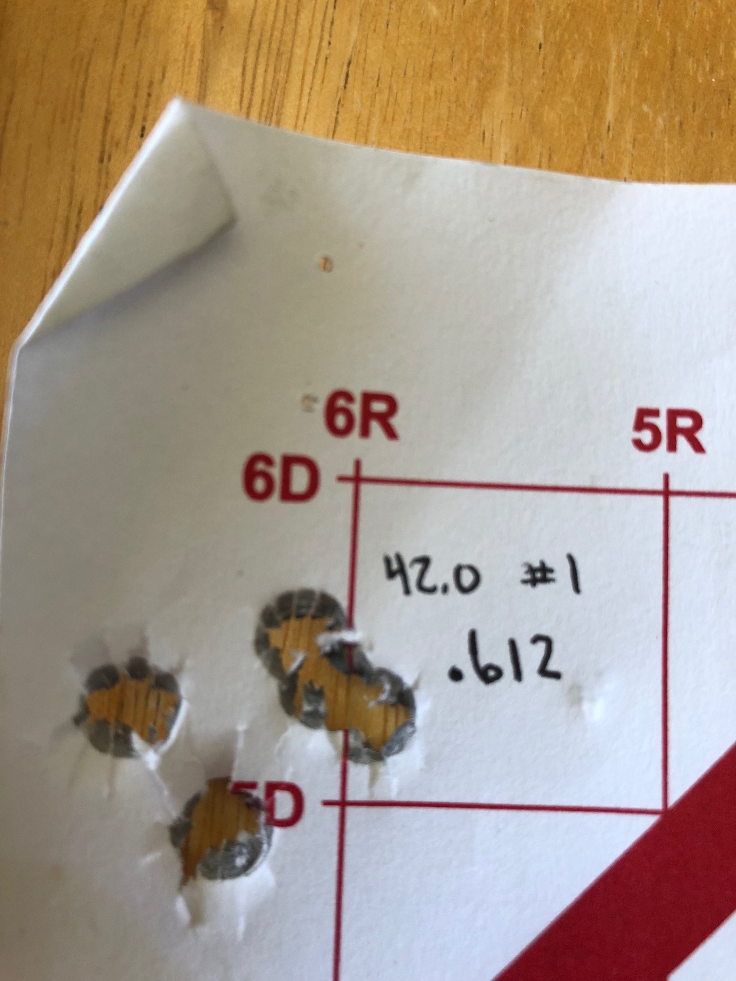

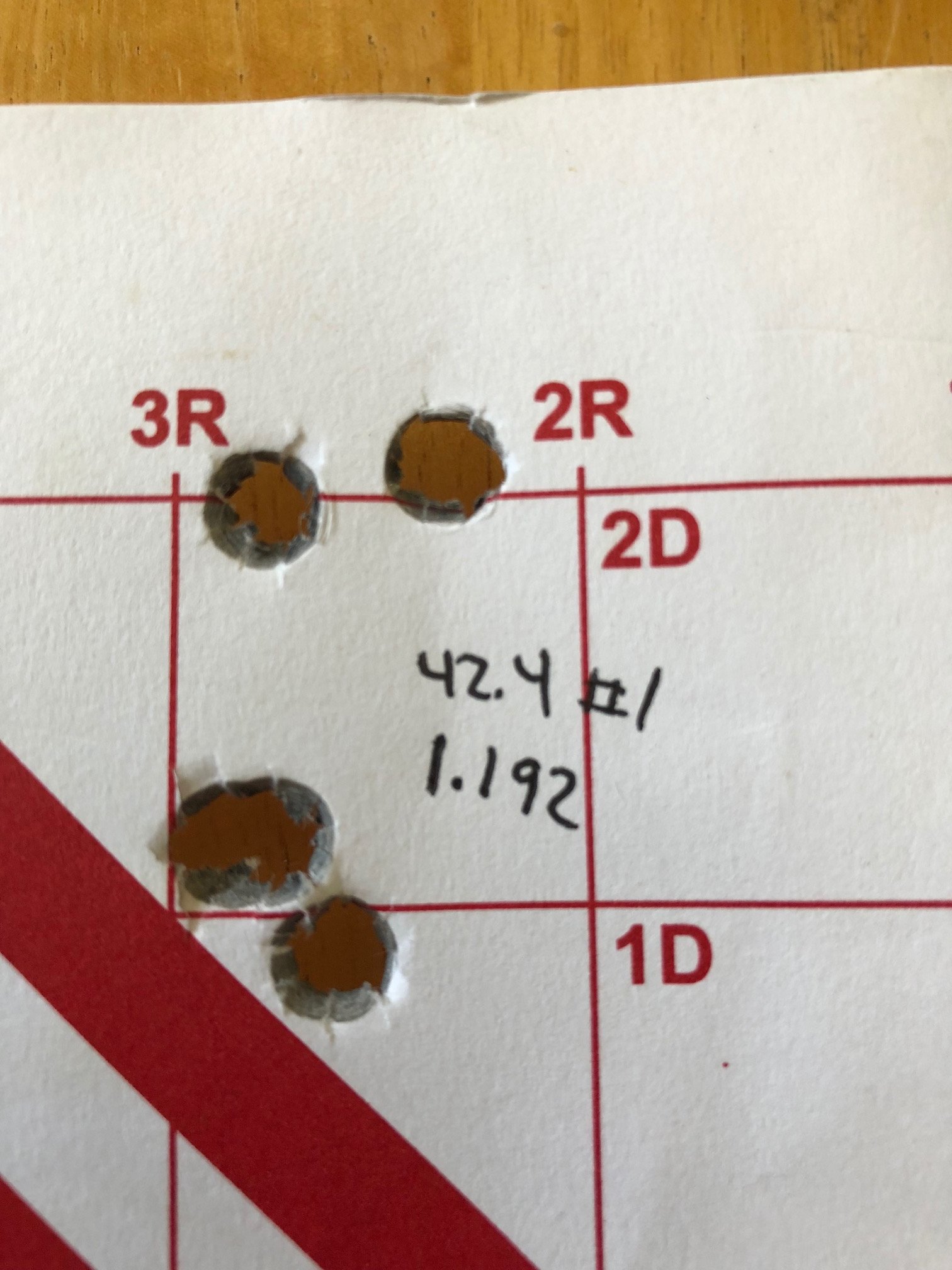

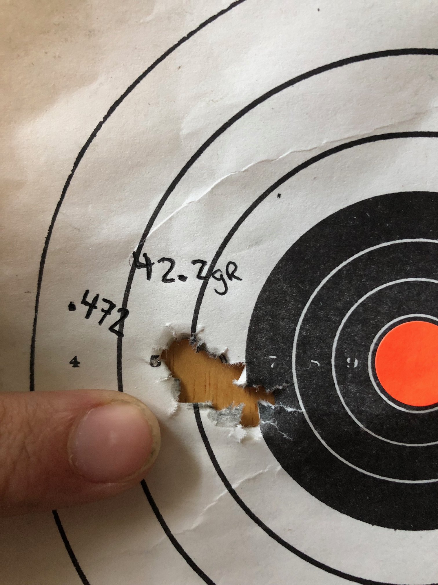

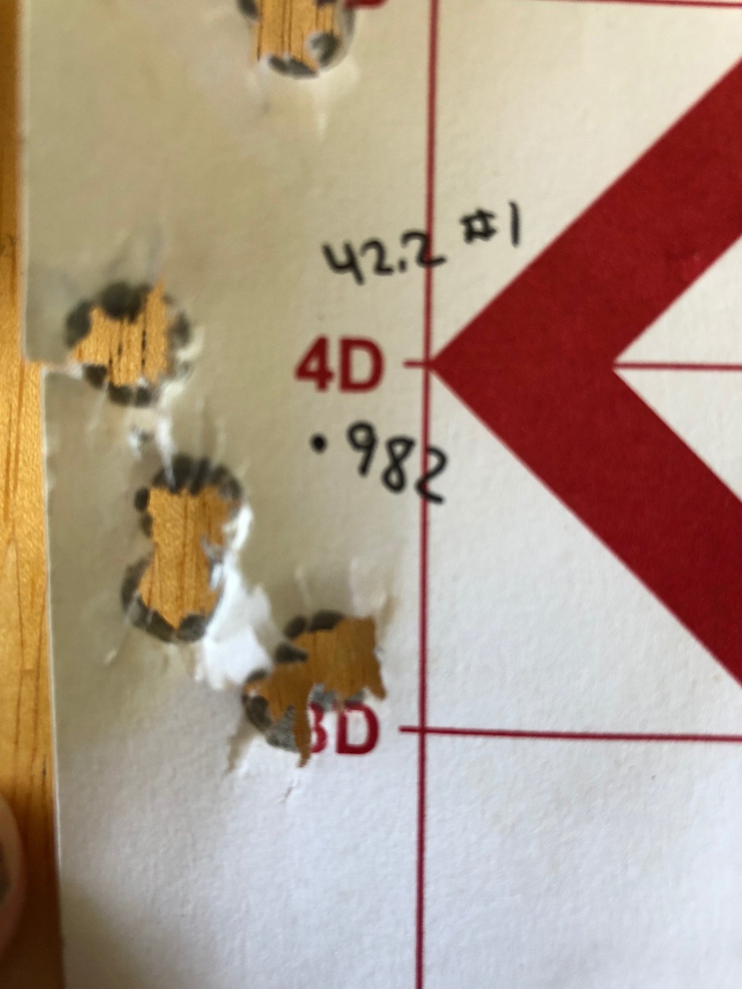

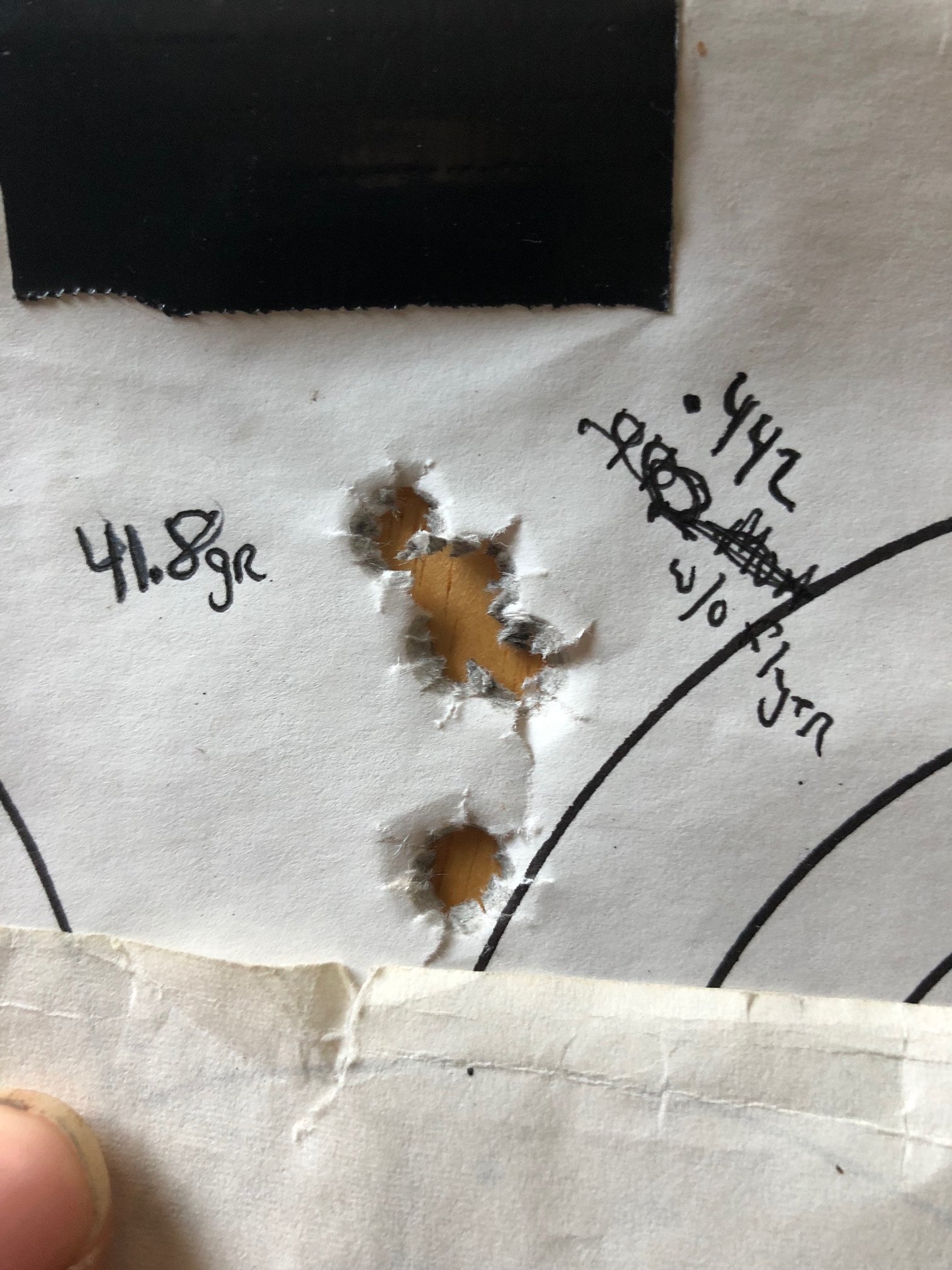

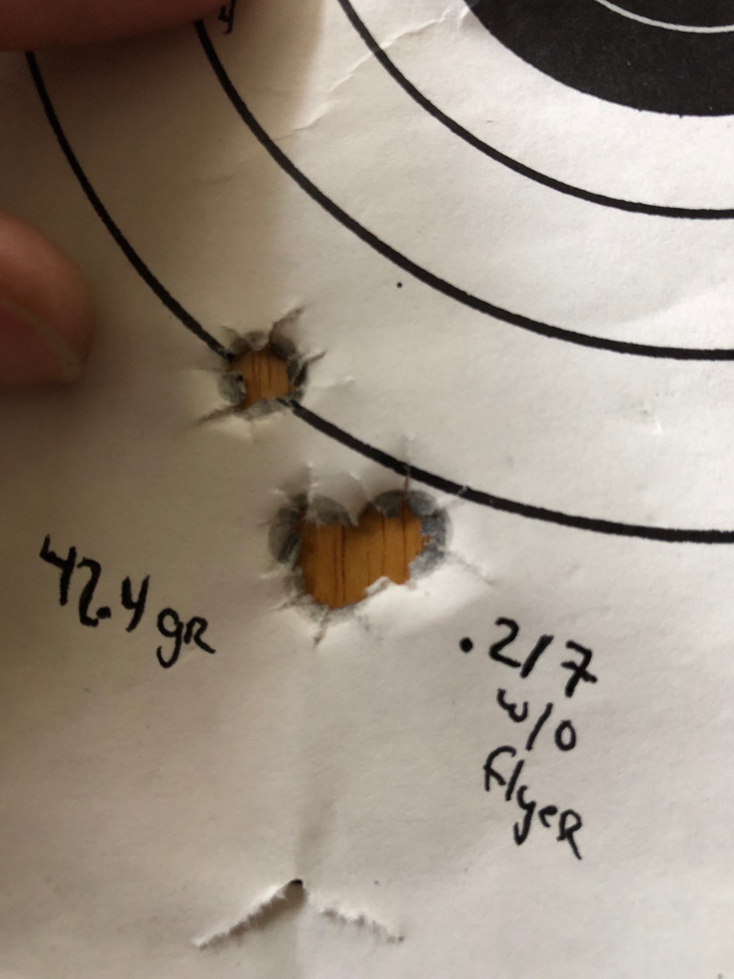

I was finally able to get some rounds loaded in continuance from the work up with Varget I posted a few weeks back. Last time I determined a node around 42.0 grains of Varget when I was loading three rounds in .5gr increments.
Today I was able to load up 5 rounds each of charge weights from 41.8 to 42.4 (.2 increments) today to further test accuracy and velocity in the 178 ELD-X's.
Also two groups in I got caught in a huge thunderstorm, causing me to rush my shots before, and be wet and perturbed on the two groups afterwards. I also shoot extremely good 4 shot groups, and usually tend to shoot what I believe to be a flyer out of the 5 shots I take. Go figure... Because of such I measure the group without the flyer and with.
Brass: Prime (Norma) 2.008 +- .005 2x Fired
Powder: Varget
OAL: 2.858 +- .002
Rifle: McMillan Tac-308 Schneider 11.00 Twist 26"
Temp: 75 F
Altitude 1321ft
Humidity 82.8 %
41.8 gr Varget
Average FPS 2624
SD 10.15
ES 24.09
Group Size .442 w/o flyer
.892 w/ flyer
42.0 gr Varget
Average FPS 2629
SD 6.72
ES 18.44
Group Size .342 w/o flyer
.842 w/ flyer

42.4 gr Varget
Average FPS 2664
SD 17.88
ES 44.12
Group Size .217 w/o flyer
.592 w/ flyer

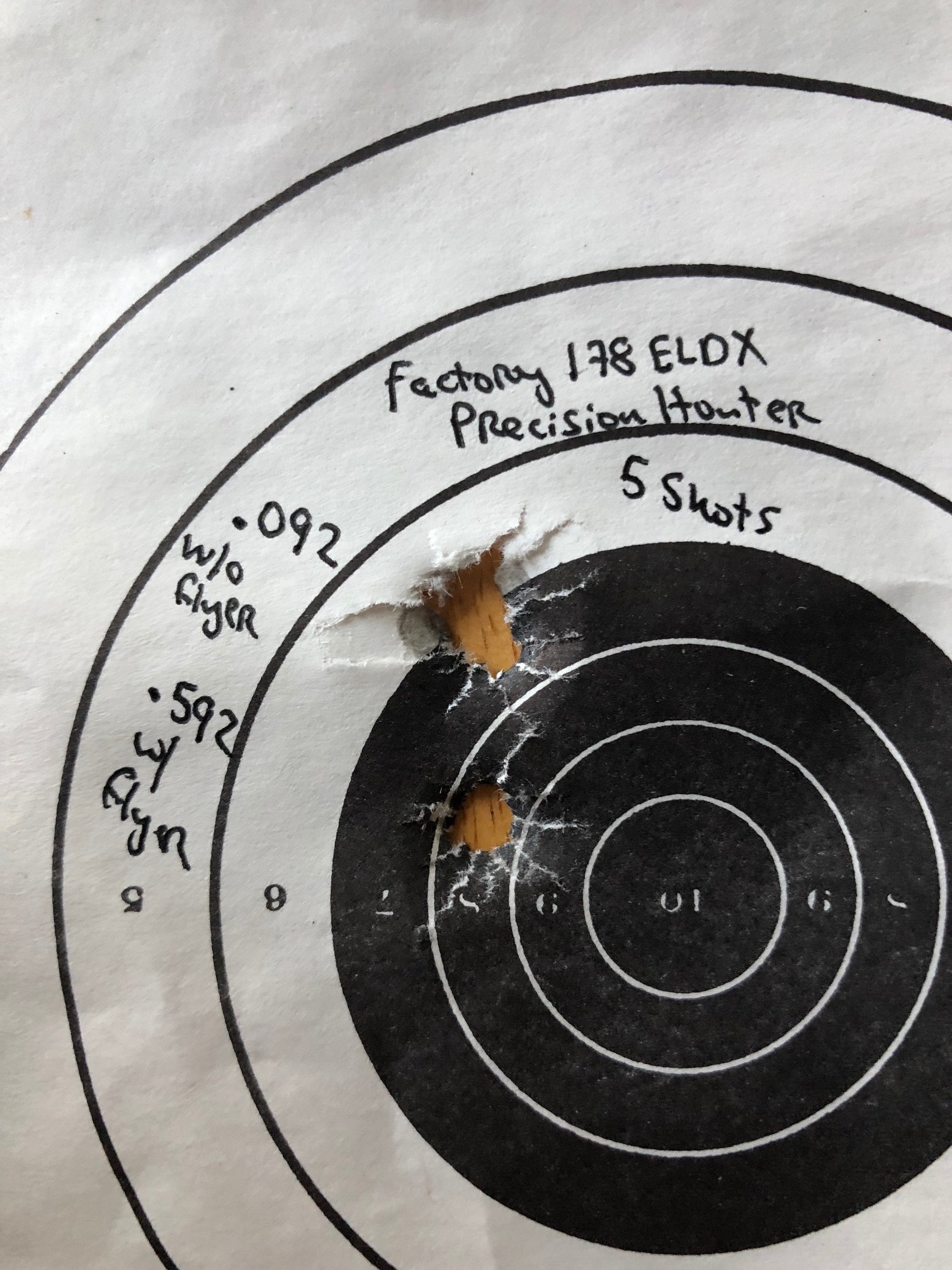

Also an astounding group from factory Hornady 178gr ELD-X Precision Hunter
Average FPS 2644
SD 9.76
ES 23.48
Group Size .092 w/o flyer
.592 w/ flyer
Decent groups with each load, starting to get a stiff bolt at 42.4 but nothing major. Due to the storms interrupting my shoot, I'll likely load 10 rounds of 42.0, 10 rounds of 42.2, and 10 rounds of 42.4 and shoot them again in 5 round increments to get a more precise measurement of overall accuracy. I'm pretty happy with the results considering I'm over 2600fps and the round seems to be capable of .5 MOA or less dependent on if I do my part.

So .092 is the mark to beat. Guess I've got to dust off the R5 milspec and get serious. Again nice shooting Chief!
Hahaha thanks! You’re allowed a flyer! As is obvious in almost all of my 5 shot groups. I didn’t shoot as well today but did get some solid info in regards to velocity, SD, and ES. Once I get all the data crunched I’ll share it all!

I was finally able to finish the load testing in continuance from the work up with Varget I posted a few weeks back. The time before last I determined a node around 42.0 grains of Varget when I was loading three rounds in .5gr increments. I then loaded 5 shots each in increments of 41.8, 42.0, 42.2, and 42.4. There were promising results in all of the groups from 42.0-42.4.
I was able to load up 10 rounds each of charge weights from 42.0 to 42.4 (.2 increments) today to further test accuracy and velocity in the 178 ELD-X's. I shot two 5 shot groups with each charge weight and shot them in the order 42.0, 42.2, 42.4, 42.0, 42.2, 42.4.
Velocity was measured using a Labradar. For this ES and SD I will use the average from each 5 shots. I also have provided an overall FPS, ES and SD from each group of shots of the listed charge weights I've shot over the last few months to give a better idea.
I hadn't cleaned my Mcmillan in quite awhile and decided to on a whim, I believe that to partially be why all the groups opened up a tad, or I also could have just sucked on the day I shot these groups. Either way, all of the groups were a bit larger than what I would normally like, but an average of all of the data from start to finish should still leave me with enough solid data to come to a decision.
Brass: Prime (Norma) 2.008 +- .005 1x Fired
Powder: Varget
OAL: 2.858 +- .002
Temp: 83.7 F
Altitude 1312ft
Humidity 73.1 %
42.0 gr Varget 1st 5 shots
Average FPS 2646
SD 8.92
ES 21.72
Group Size .612
42.0 gr Varget 2nd 5 shots
Average FPS 2643
SD 10.39
ES 26.98
Group Size .400 w/o flyer
.642 w/ flyer
42.2 gr Varget 1st 5 shots
Average FPS 2658
SD 13.45
ES 32.31
Group Size .982
42.2 gr Varget 2nd 5 shots
Average FPS 2658
SD 12.15
ES 30.59
Group Size .692
42.4 gr Varget 1st 5 shots
Average FPS 2671
SD 9.07
ES 22.27
Group Size 1.192
42.4 gr Varget 2nd 5 shots
Average FPS 2671
SD 7.95
ES 18.14
Group Size 1.042
Several things of emphasis to note. I believe the results from the Labradar to be fairly consistent being as average FPS, ES, and SD are all similar in regards to charge weight even though the two separate groups (of same charge weight) weren't shot consecutively.
Group size was also relatively similar between each group of same charge weight, meaning I was shooting fairly consistent. If you look at the photos, even the way the groups look bear some similarity. Not sure if thats just coincidence or what...
Now onto cumulative data:
42.0gr Varget (4 data sets)
Overall FPS: 2645
Overall SD: 7.41
Overall ES: 18.6
Overall Average Group Size: .409 w/o called flyers
Overall Impressions: Although I do have an extra data set in this charge weight due to the initial testing from 40.0-42.0, this was my most stable load in terms of lowest SD, ES, and group size overall. Although the other charge weights did turn out smaller groups, overall throughout the course of testing this was the most efficient overall.
42.2gr Varget (3 data sets, only 2 usable data sets due to Labradar not set up properly after storm)
Overall FPS: 2658
Overall SD: 11.34
Overall ES: 31
Overall Group Size: .837 w/o called flyers
Overall Impressions: Turned out two out of three respectable groups of .472 and .692. I wish I had usable data from the group that I shot right after it stormed. I think this charge weight definitely deserves to be shot more at a later time. Respectable SD, ES is a bit high but not outrageous.
42.4gr Varget (3 data sets)
Overall FPS: 2668
Overall SD: 11.63
Overall ES: 28.21
Overall Group Size: .817 w/o called flyers
Overall Impressions: Turned out a .217 group for the best overall without a called flyer, however the 2nd and 3rd group shot were each over an inch. SD and ES were also the highest overall, however without the 1st data set and only using the 2nd and 3rd they are quite low (under 10SD and 20ES respectively). However the groups shot with 2nd and 3rd data set are also the ones that shot over an inch. Primers are also starting to flatten a tad and I experienced an extremely minor stiff bolt in this charge weight.
