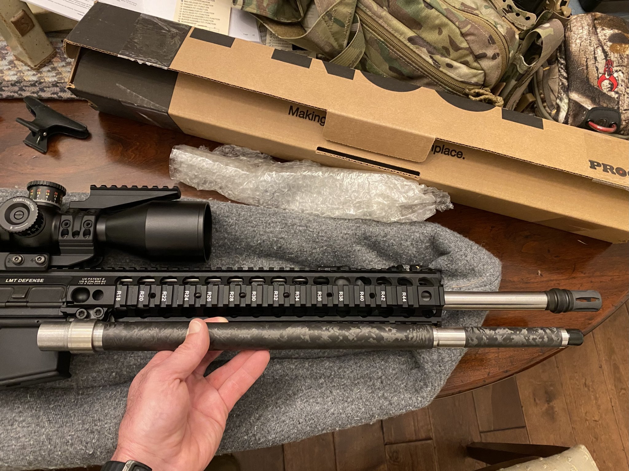

    I did decide to pick up another 18" 5.56 barrel. I decided on one of the Boss firearms D. Wilson modded Proof Carbon 5.56 18" barrels as the 6.5CM barrel has been very accurate. I also picked it up on sale recently during the holidays for a very reasonable price. I am waiting until after coyote season to install and work up loads for it however. It should lighten the load a little as most of the time this gun has the PVS-24 and a 3-12x56 on it. The LMT 18" SS barrel it wears now has been very accurate shooting the 53 V-max.

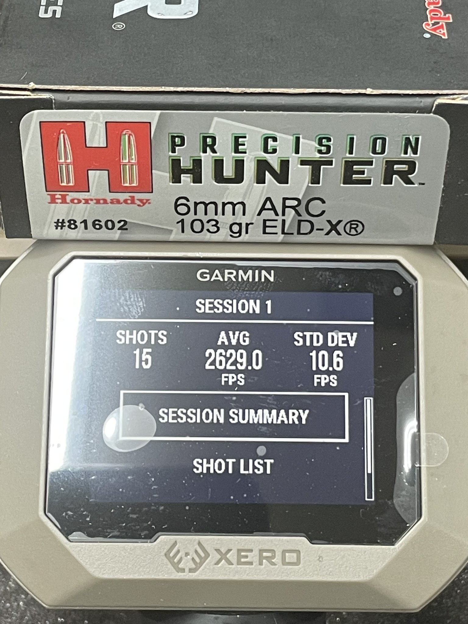

    My Seekins loves the 58 VMAX and A2230
    18” McGowen 1:7.5
    Magnetospeed V3
    Hornady 58 gr VMAX
    A2230
    Hornady brass x 5
    205M FGMM
    BTO 1.6650
    COL 1.4900
    32.2 3468, 3466, 3474, 3476 SD 4.6 0.5” no pressure
    32.5 3507, 3506, 3497, 3506 SD 4.6 1” mild pressure

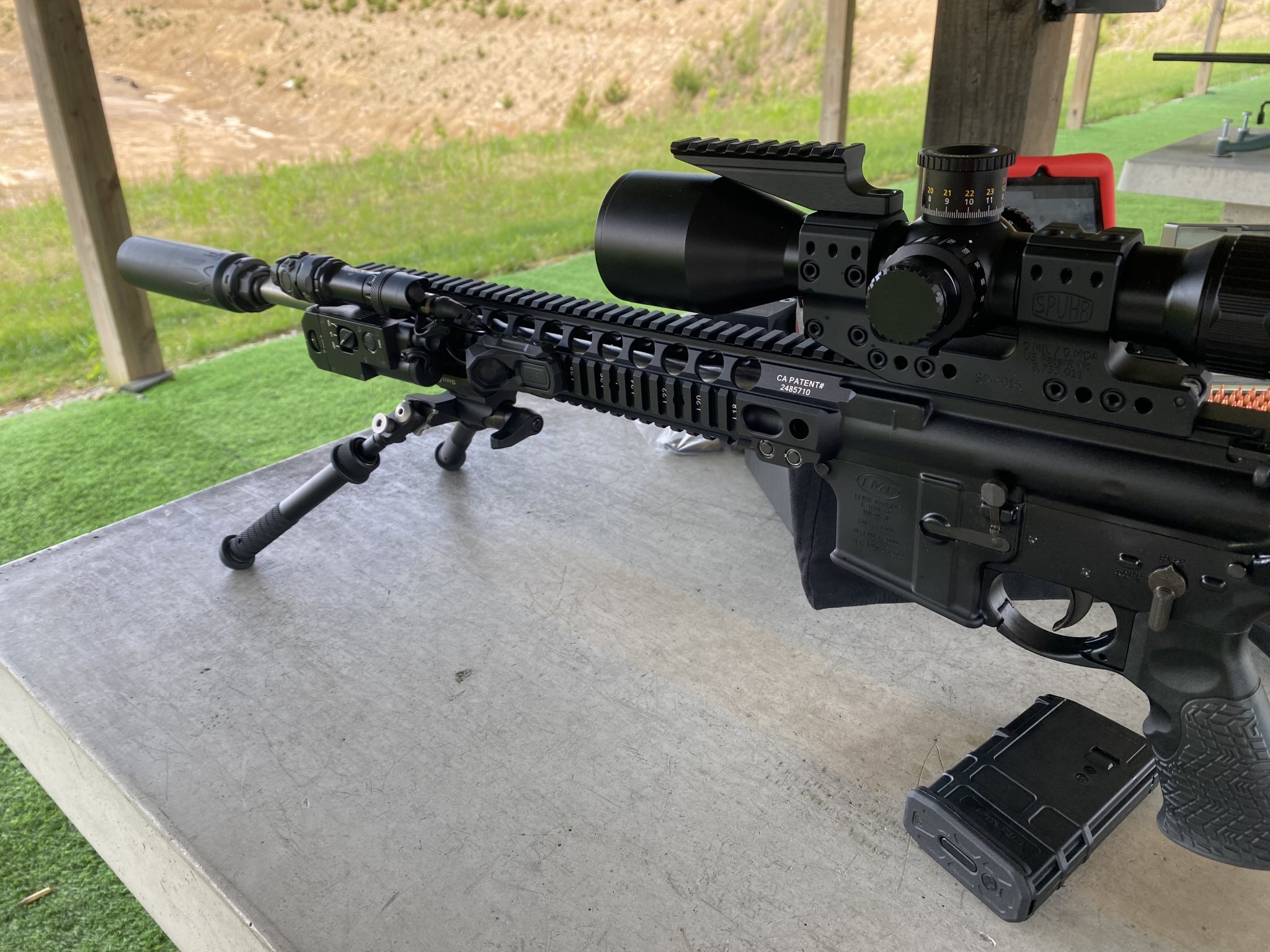

    Does the gas block tuck under the rail or does the leading edge stick out at the front edge on the MRP-L?

    Ok so regardless of 223 or 6 ARC, the rifle length and rifle +1 will have the gas block protruding out from underneath the rail. Thanks for the visual.
    Depending on where exactly the shoulder of the gas journal of a RLGS ends up in relation to the rail, an exposed gas block/AGB of the right type could look and work out pretty sweet. I hope you keep us updated on what you end up doing.

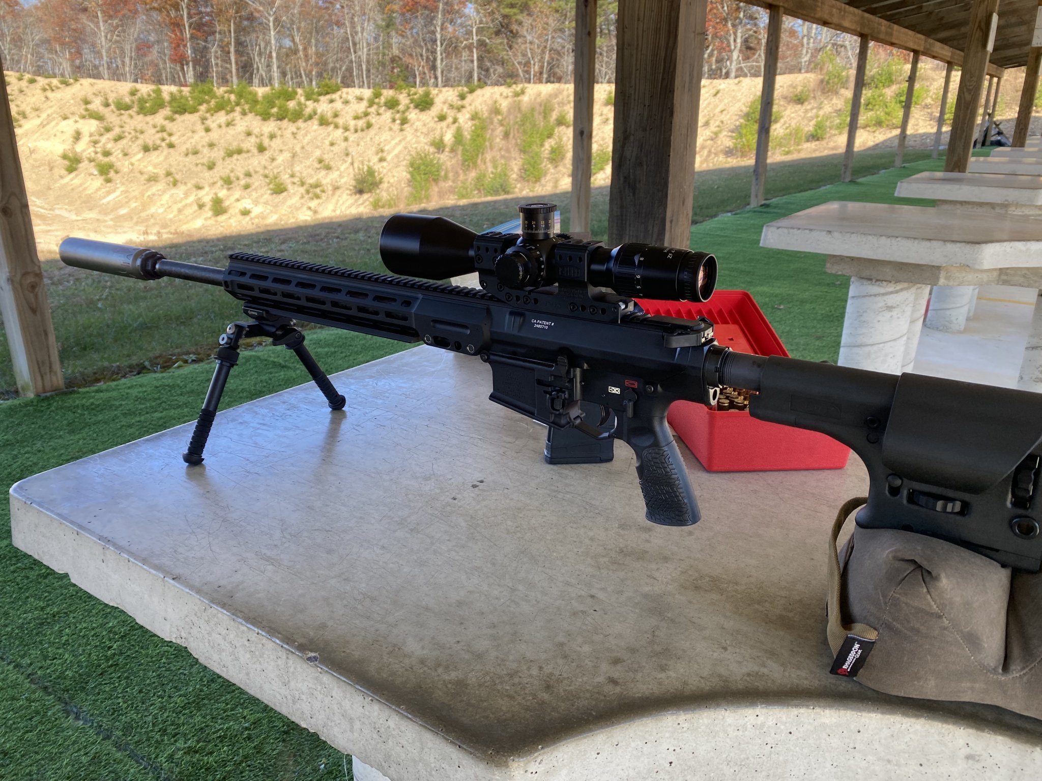

    Well I ended up going the 6 ARC route and here she is folks. The Rifle +1 length gas system has it looking a tad Mk12 like but I am ok with it. I am still waiting on the Geissele SD-E trigger and for my AAC SDN-6 to get back from Echo Machine for the HUB conversion, but other than that the 6 ARC is done.
    • LMT MARS- L MRP
    • Proof Research Carbon 18" 6 ARC barrel 1:7.5 twist Rifle +1, D. Wilson LMT Barrel conversion w/SLR Micro Gas Block
    • Rearden SPB .375/HUB
    • JP Enterprises 6mm ARC Bolt
    • Night Force ATACR 4-16x42 Mil-XT
    • Reptilia AUS 34mm 0 moa
