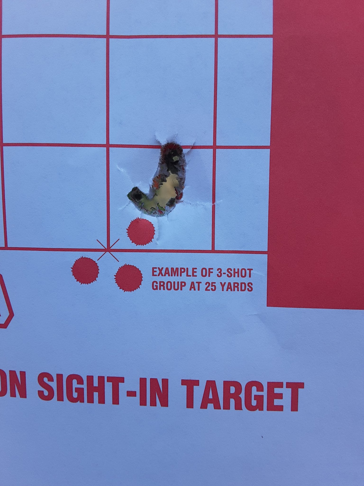

I doubt you'll get a 180 ELD-M to fly from a tight twist with any speed behind it. I'm losing at least 10% from a 28 Nosler at 3100fps and 1:8 twist. They shoot lights out......but some lose the jacket before 100 yards.
