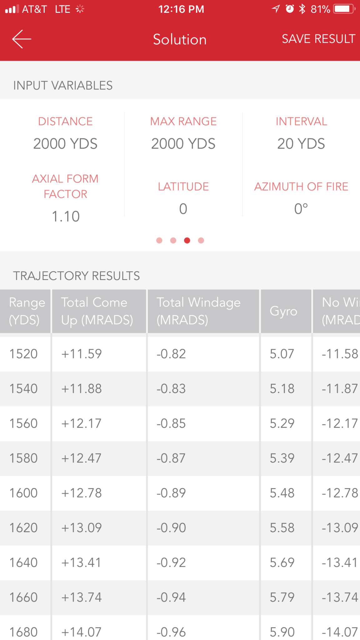

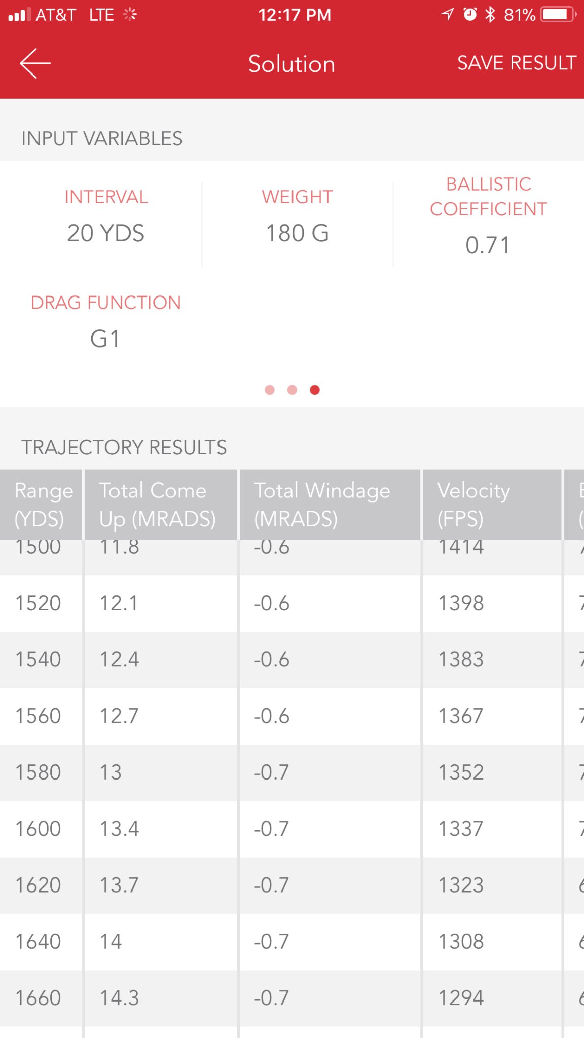

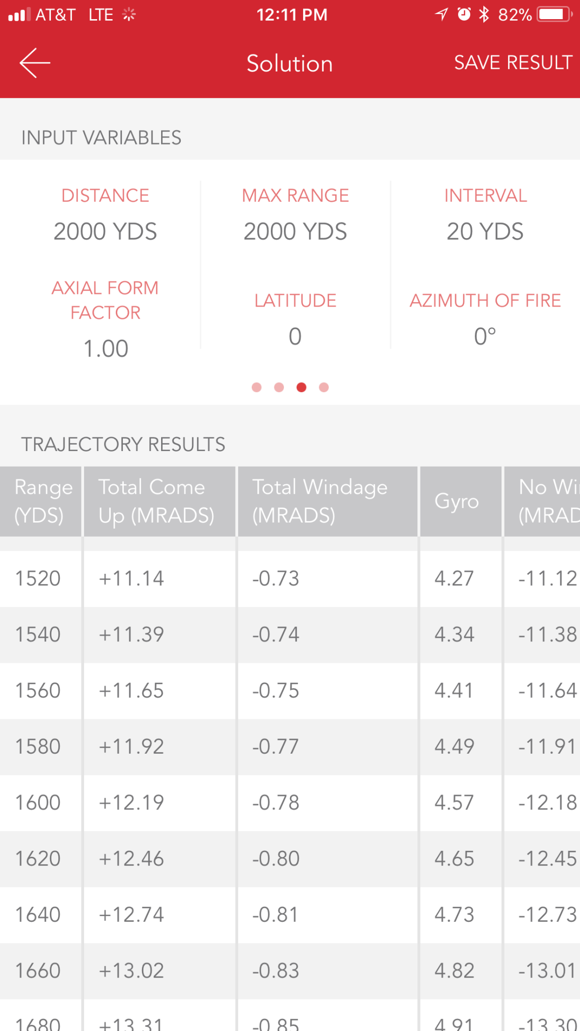

I posted on this in another thread here but if you go into the Hornady 4DOF app and use the plain BC calculator and generate a drop chart, then Scroll to the right across the top where all the inputs are you will see the G1 BC listed at 0.71 which is lower than advertised. Then if you run the 180 ELDM in the 4DOF calculator you will see the drops are much more optimistic vs the BC calculator. I took the 180 ELDM to 1535 the other day with my last 3 rounds of load development. 1:8 twist at 3080 FPS and I hit 0.8 to 1 Mil low with the 4DOF data. DA was 2250 and I had synced kestrel to the app. Made a correction and got 2nd round hit. 3rd shot: elevation good, missed off left edge. Called it a day. Obviously I have more shooting to do as this was just 3 rounds, but I did have single digit SD on the previous 7 I put on paper prior.
Figured out all of the above later that evening and the BC calculator matched my dope. Even when I changed the axial form factor to 1.1 in 4DOF I still needed more elevation to match what I had previously seen in the field. Plugged 0.71 into Coldbore and it matched right up too. The bullets bughole, but something seems off between 4DOF data and the fact that Hornady is publishing a 0.71 BC in the app vs what they are advertising. I figured my set up would be taking advantage of the higher BC range, maybe not max, but higher.
