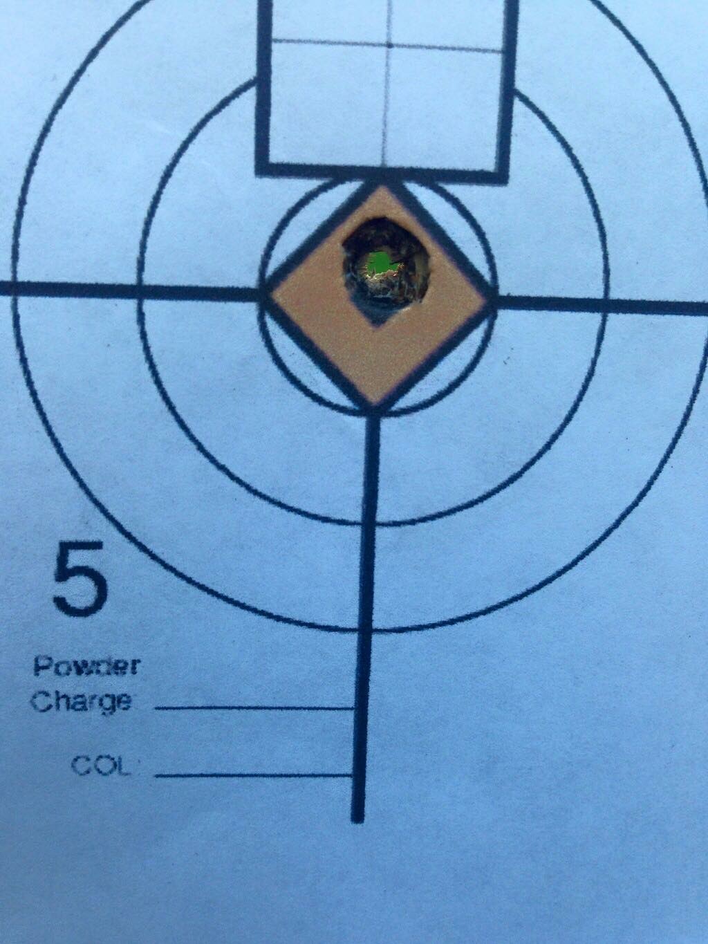

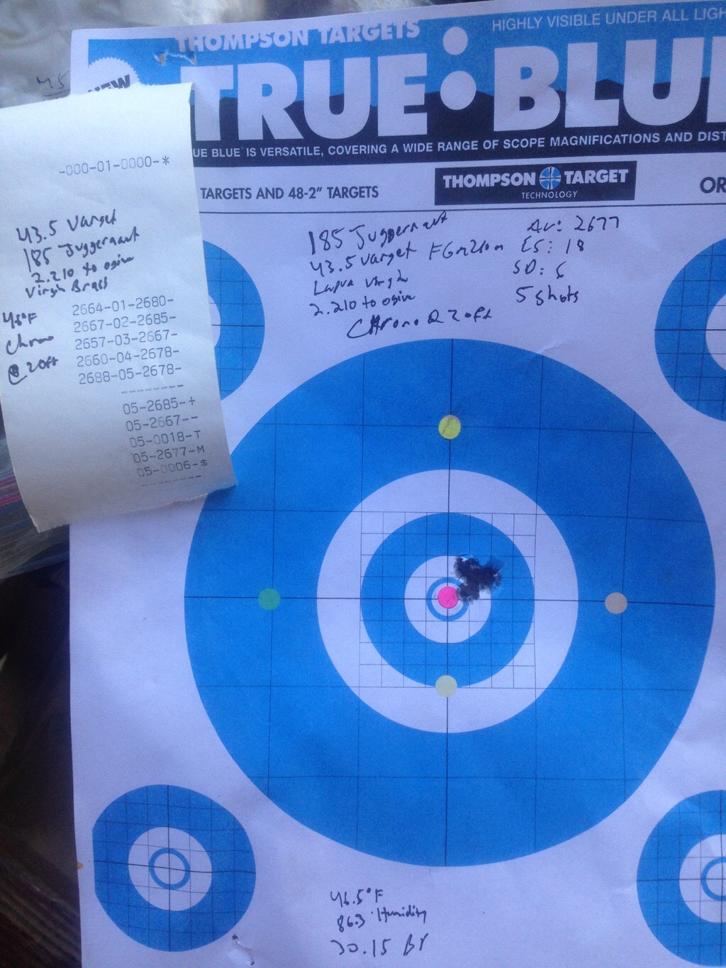

They are all I shoot out of a 28” Bartlein 1:11.25 bbl. 43.8 varget at 2.212” to the ogive. (Roughly 2.860”... fits in all my AI mags ) and they are a laser beams.
