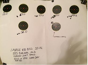

Here are powder charges I loaded for the test 56.0gr, 57.0gr, 57.5gr, 58.0gr, 58.5gr and 59.0gr of H-4350.

Test was performed over two days since I could only conduct this test after work and was racing against darkness. The loads were not fired round robin as per OCW, however, the barrel was allowed 1-2mins to cool between shots.

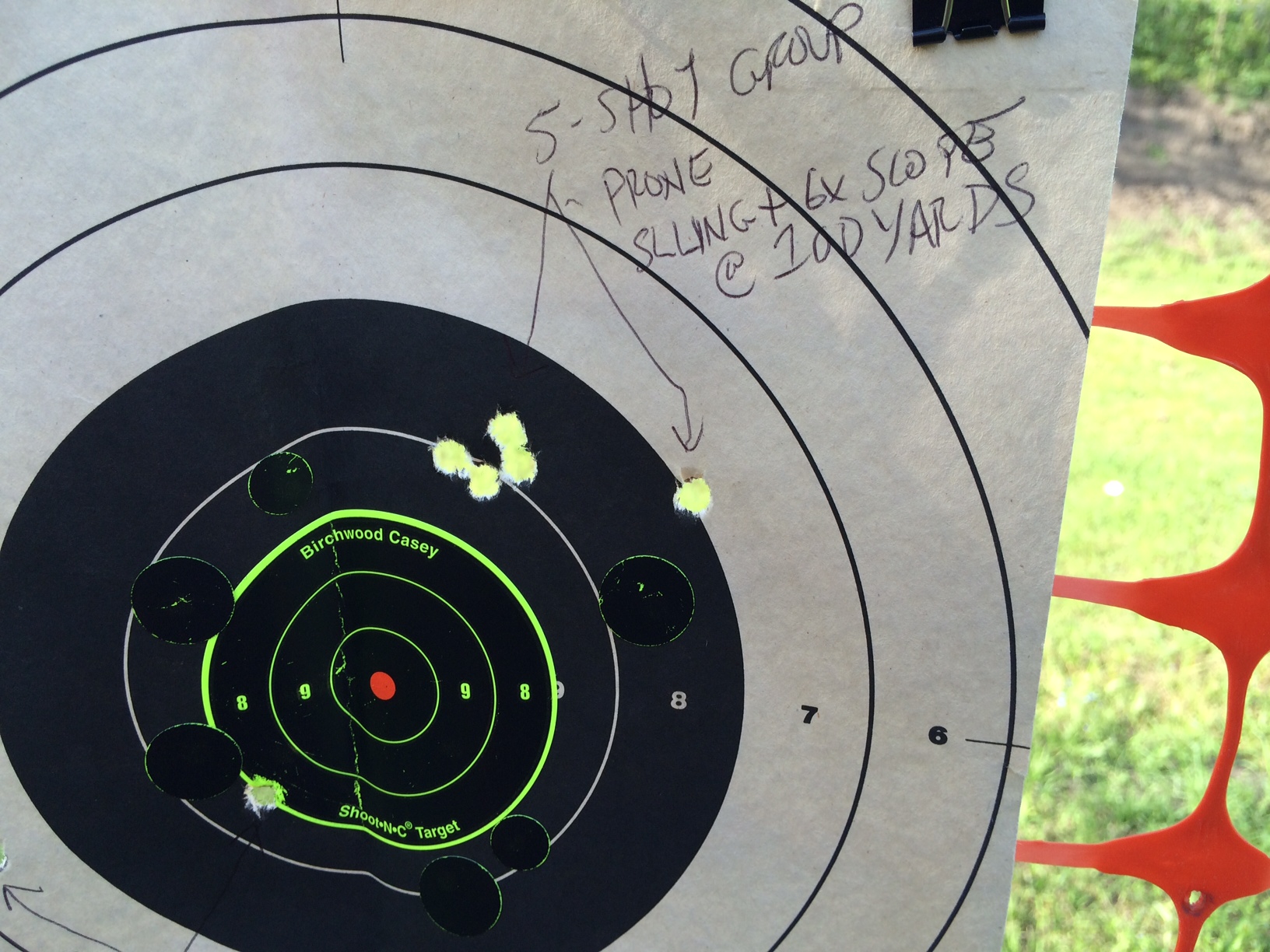

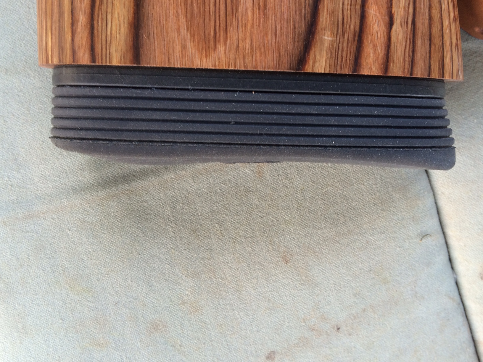

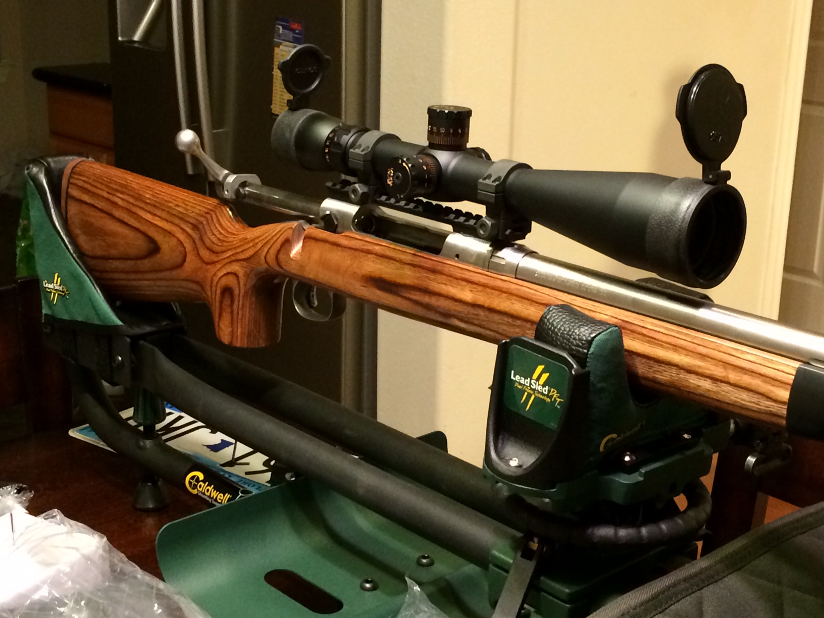

The rifle is a Savage Model 112 BVSS chambered in 30-06. It comes in a laminated stock with a 26” SS fluted varmint profile barrel and of course the wonderful accutrigger. My only dig at this rifle is it’s buttpad…it sucks. Recoil is punchy, not punishingly so, but not something I could stomach for 70+ rounds or so fired at our monthly 1,000yard match. I installed an ill-fitting (it does not fit laminated wood stocks) limbsaver recoil pad in its place and shot a 5-shot group today. HOLY COW!!! The recoil vanished. The advertised recoil reduction is 70%...I think it's more...I cant feel the recoil...at all...it recoils less than my 308AR with a muzzle brake!!!
Following are the result of the tests:
56gr H-4350:
2,843ft/s
2,842ft/s
2,828ft/s
2,802ft/s
Avg Velocity: 2,829ft/s
SD 19
ES 34
57gr H-4350
2,866ft/s
2,883ft/s
2,868ft/s
2,889ft/s
2,891ft/s
Avg Velocity: 2,877ft/s
SD: 10
ES: 25
57.5gr H-4350
2,891ft/s
2,895ft/s
2,901ft/s
2,920ft/s
2,890ft/s
Avg Velocity: 2,899ft/s
SD: 12
ES: 30
58.0gr H-4350
2,939ft/s
2,922ft/s
2,942ft/s
2,929ft/s
Avg Velocity: 2,933ft/s
SD: 8
ES: 20
58.5gr H-4350
2,915ft/s
2,963ft/s
2,956ft/s
2,947ft/s
2,929ft/s
Avg Velocity: 2,943ft/s
SD: 20
ES:48
59gr H-4350
2,956ft/s
2,972ft/s
2,958ft/s
2,951ft/s
Avg Velocity: 2,959ft/s
SD:10
ES: 21
Needless to say, I was very impressed with the results . I was hoping to get achieve an accuracy node with a velocity in the low 2,800s and almost fell off my chair when I saw the velocity readout after touching off the first 56.0gr load.
It appears from this crude test that I have an OCW around 57.5gr node. I will re-shoot this test at a latter date loading up from 57.0 up to 58.5 in 0.3gr increments to ensure that I am interpreting the results correctly.

Excellent job and a very nice write up with pictures too.Looks like a great LR load to me. I would work between 57.0 to 58grs, but that's my opinion. Stretch it out past 300 yards and see which one holds the best horizontal. Great job!

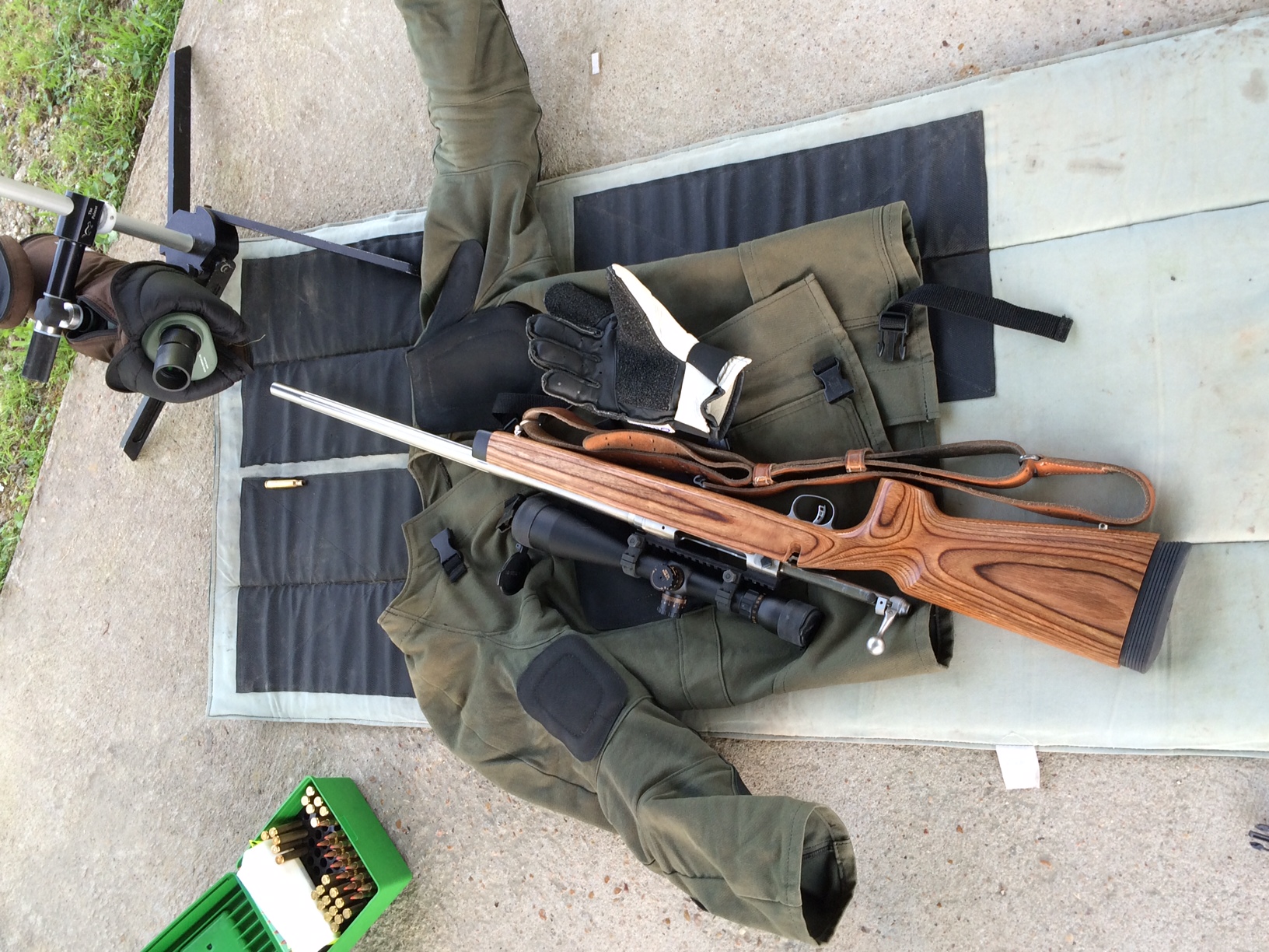

Well, the squadded practice did not go as i had planned. There were only four(4) of us, we all shot on the same targets, and I shot from prone slung position. Yes, i forgot to grab my secondary range bag which has my sandbags.
The session was very helpful. I got to confirm the velocity over the chrono. Ballistic app indicated i needed 28MOA from 1,000yard zero. I did not believe it. I dialed 30MOA and sent it downrange...sure enough, it was about 2MOA too high..I will not doubt my magnetospeed again :) I ended up needing 27.75MOA from a 100yard zero...that actually corresponds to 2,910 ft/s vs magneto speed's 2,899ft/s average velocity.
Shot several Xs, & 10s, i did have a couple of wide shots when the wind suddenly dropped off and switched directions, but this is to be expected.
I'll try to get out and shoot this load at 1,000yard with artificial support to gauge the elevation at a later date. But so far, I'm very happy with this load.
On a side note, a couple of the guys there primarily shoot 308s at 1,000yards. They did not believe you could get this much velocity from a 30-06...safely. One of them even suggested that i may be at the ragged edge of pressure. He came over and examined my brass and was surprised...nice and rounded corners without a hint of pressure....i just smiled. I think i may have convinced two very good shooters to give the -06 another go:) Not only did i need about 5-6MOA less elevation than the 308, but i needed about 2MOA less windage.

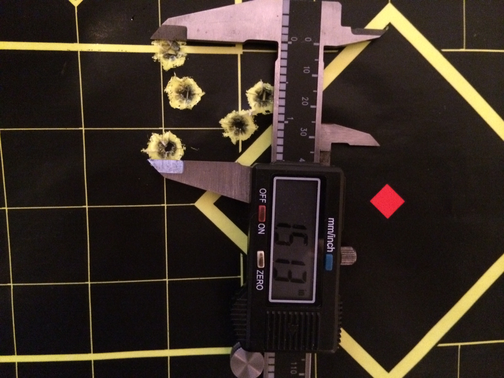

Below is a 5-shot at 300yards, shot in rain with no wind correction factored in...to say that i'm happy with this load is an understatement...
