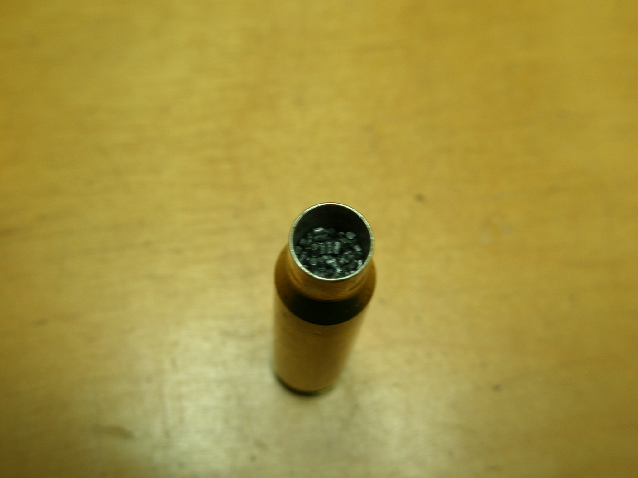

I have a 20" (Excaliber) 1-11 that I shoot 125gr. ballistic tips with.
ARcomp works very well. Average fps is just under 3000 (2995).
Fairly consistently 1/2" to 3/4" shooter. I used Quickload to develop.
Tried ARcomp, IMR3031,and IMR8208. Arcomp gave me the best sd/ fps/ consistant groups for an AR..
I use an adjustable gas block also.
Remington R25.

43.7 using LC15 (Packaged AmericanEagle sold by Federal 7.62x51) brass and Fed 210's... I use a small base die with the shoulders bumped way out. i'm not sure if it was the fastest, definitely the most consistent groups. I don't think 46 or 48gr. will work for me......
