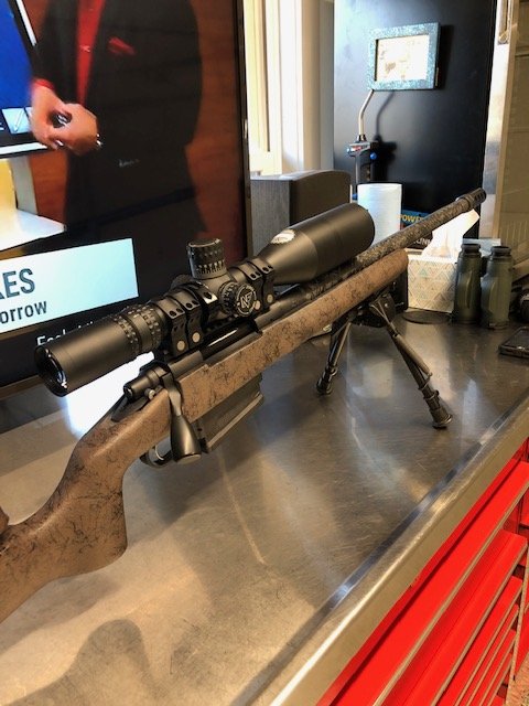

I built this gun for fun just to see what a 30 06 can do. I am pretty impressed with it so far. 22 inch Proof Barrel with a APA fat bastard brake seems to do the trick. Really impressed with RL26 so far.
I will try to post a picture of it. I did the bedding myself which turned out ok but learned a lot and could do a better job next time. It shoots great though now. I am using 215 primers but will try 210 also to see if there is any difference. My 5 shot group was 2849, 2840, 2842, 2839, and 2842. Not to bad for the first time out with that load. 62.2 grains RL26, Lapua brass and the 190 Berger hunting VLD seems to be a great load in this rifle. The 22 inch barrel is not handicapping it to much yet.

That is a good looking setup. I have a 30-06 as well and I am thinking of working up a new load. I might have to give ol' RL26 a try. If I can find it that is. Haha
