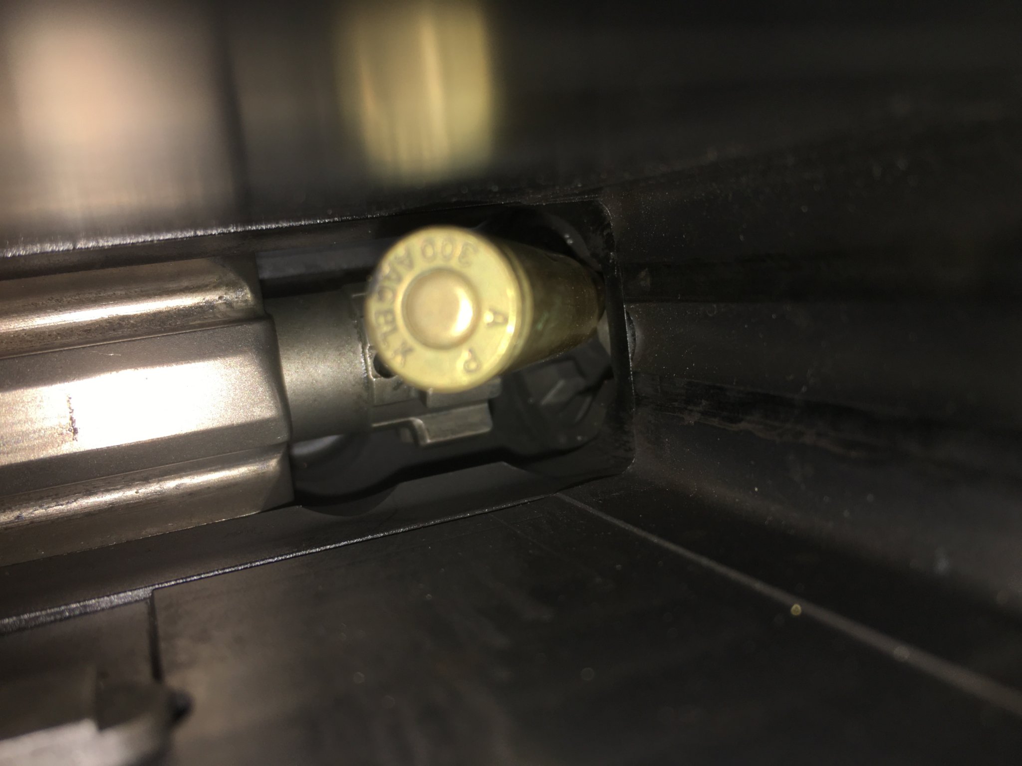

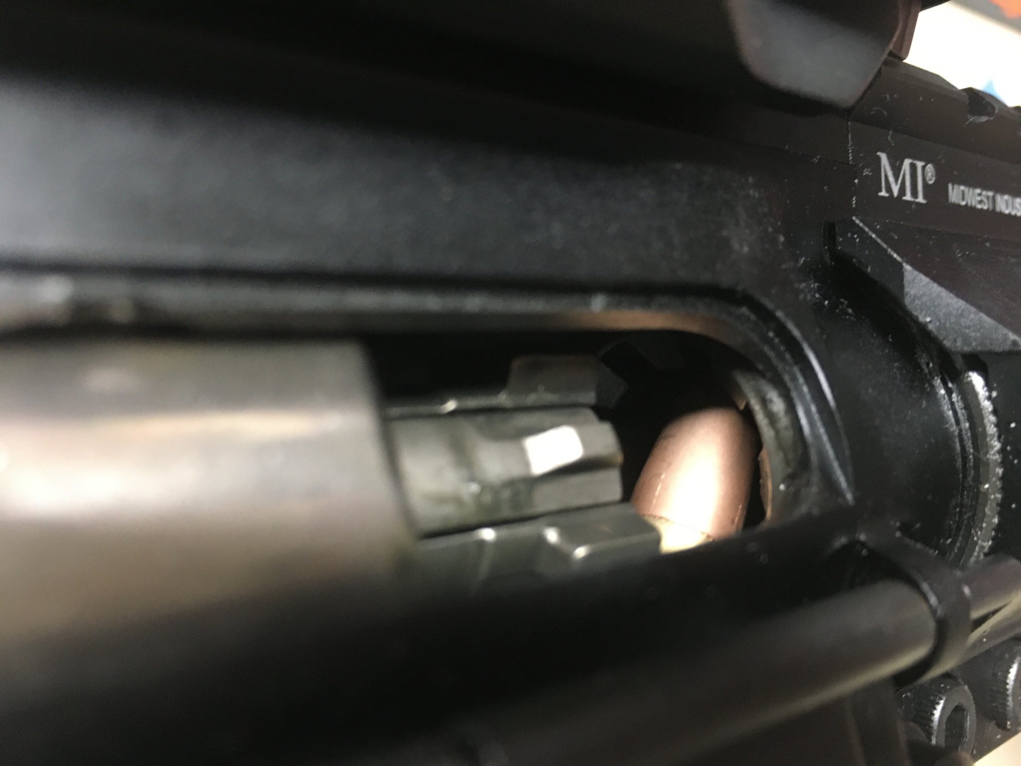

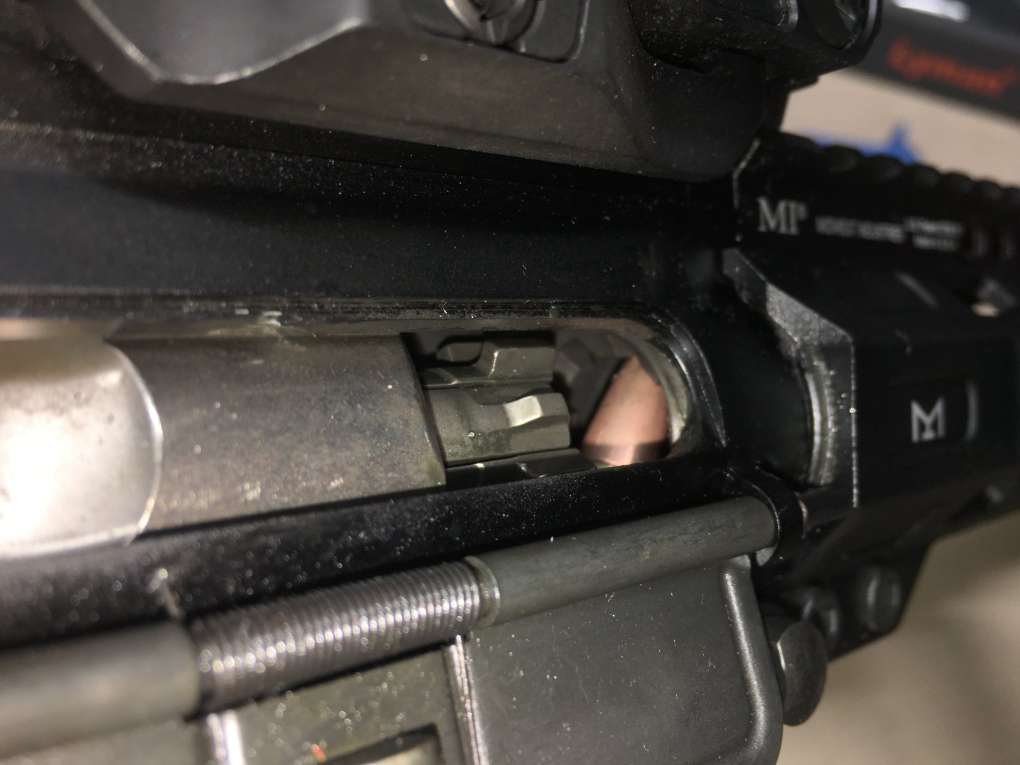

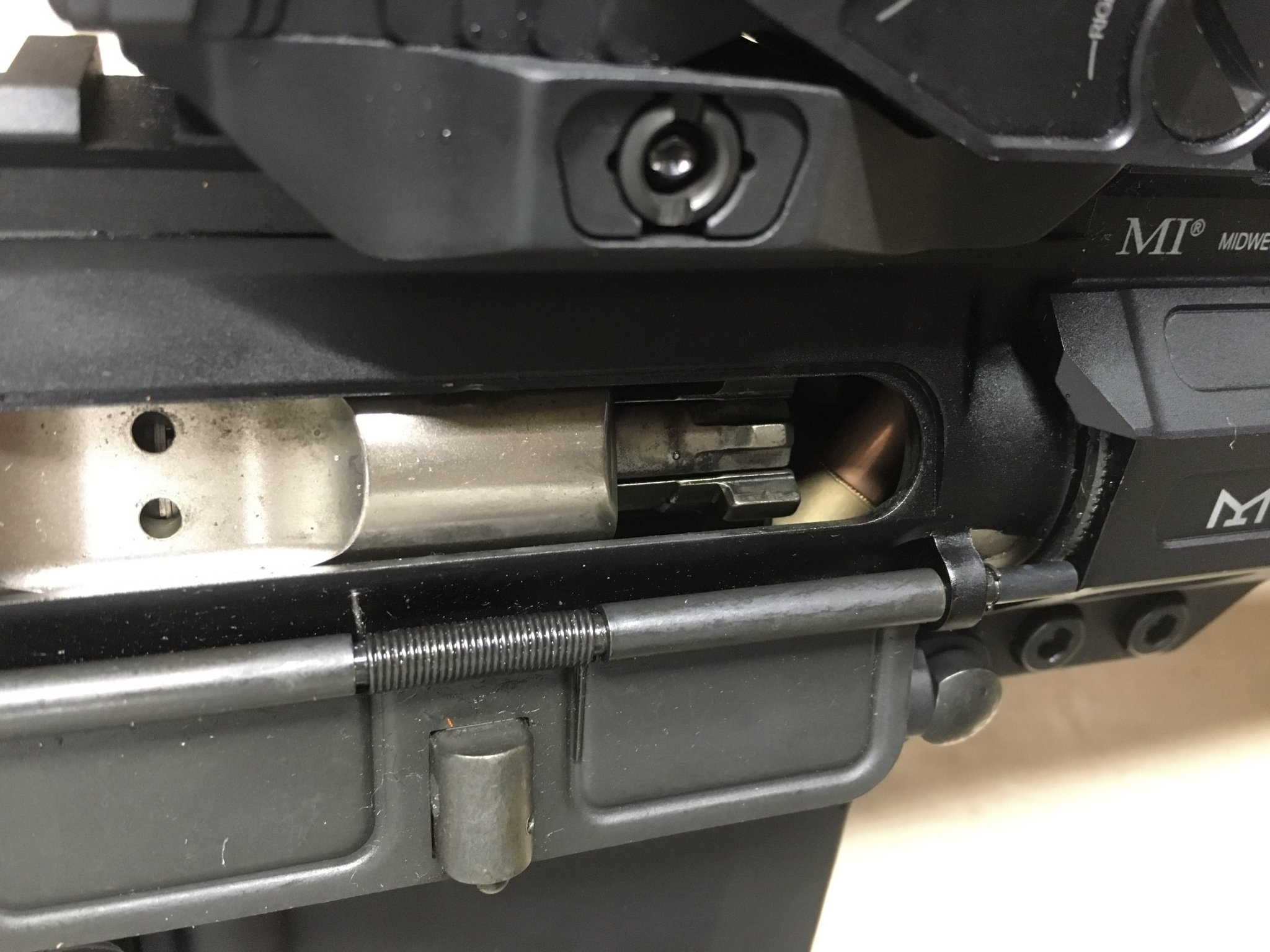

I’ve read about a few people having a similar issue I have been having. Ape_Factory has detailed what seems to be the same issue. The issue is that the bullet will sometimes jam in the feed ramp, and or start to jam in the feed ramp, but get forced past the feed ramp and then jam with the nose of the bullet at the shoulder of the fend ramp, never making it into the chamber.
Ive chased this problem probably way too long, as I’m determined to make this bullet work. Yes, I’m aware of solid copper bullets but am not ready to give up yet. I am scared of a baffle strike with the copper bullets being less stable. I’m at the point where I’m convinced the M4 feed ramps, which were designed to be used with a 556 round, do not work with the combined geometry of the flat nose and wider diameter of the bullet. Seems like the rubber plug of the bullet hits the feed ramp and steep angle, potentially initiating the problem. Or, the wider diameter of the bullet caused the round to be at a steeper angle when feeding, causing the bullet not to feed properly. I think the steep angle may be causing the round to prematurely leave the magazine, and thus jam in the barrel extension.
Here’s, what I’m looking for: for those of you using this bullet without issues (several hundred shots fired without having this issue or any FTF) what specific barrel do you have? I’m ready to take a Dremel to my feed ramp and potentially ruin it in trying to test my theory by taking the feed ramps down. That said, I’d like to buy a replacement barrel that other people have been using successfully as a backup to have on hand.
My upper has the proper feed ramps cut. No lip or overhang. This is the only bullet I have ever had this issue with.
Anderson lower. Wilson Combat 11.3” barrel. Trybe upper. Ive used 300blk pmags as well as lancers 300blk option. Issue is observed with both magazines. COAL has been played with extensively. Better and worse results, but never totally alleviated the problem.
My last notes say 2.04 - 2.08. I’ve gone shorter and longer and didnt record in my notes. Went back to the cannelure and continued troubleshooting. Same issues with varied frequency at all COAL variances. Do you use them without issue? If so, what barrel and lower do you use?

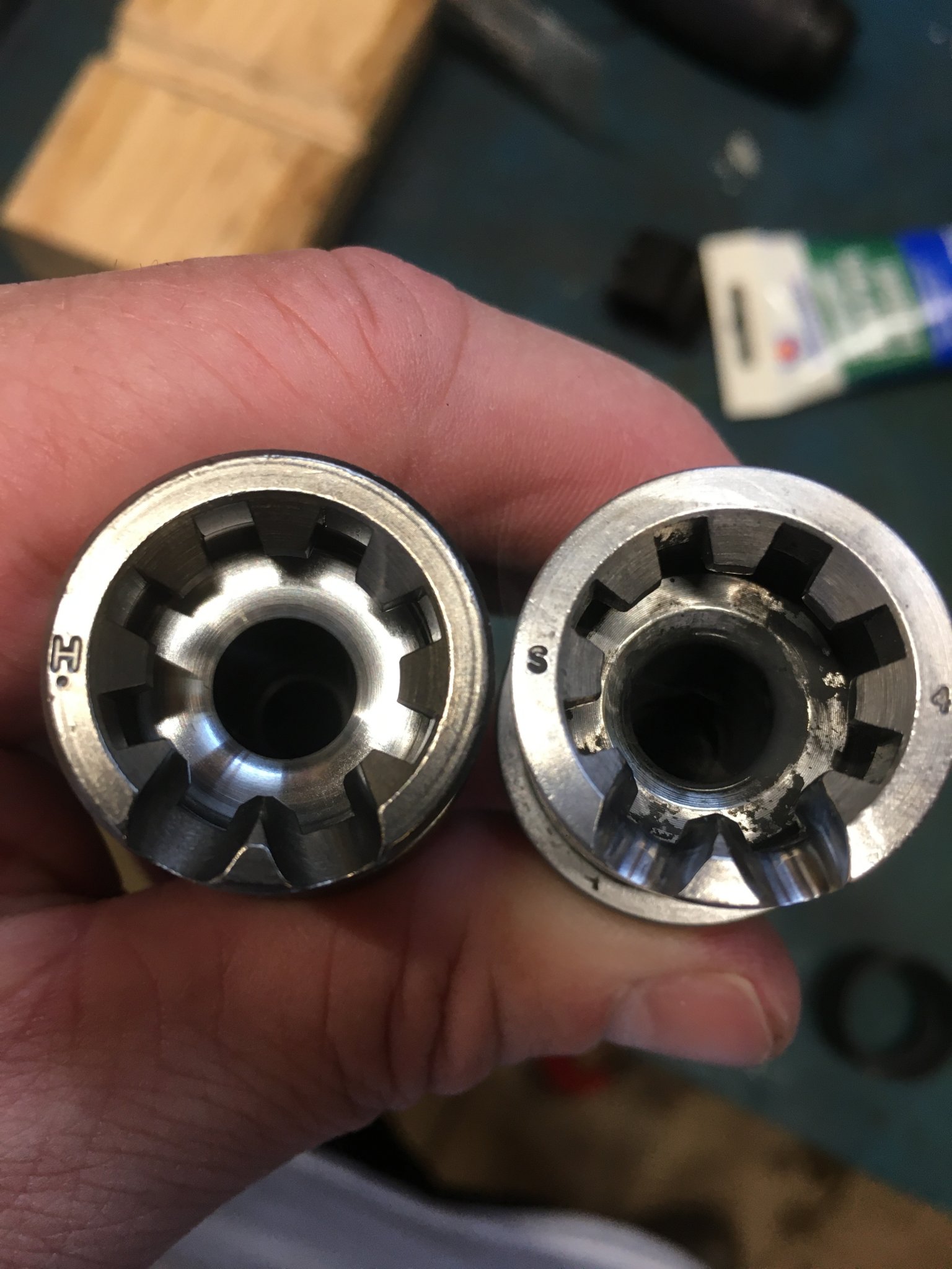

I did recently get the Rainier Arms barrel. I haven’t fully tested it out, but here’s what I have so far:
I manually cycled 480 rounds through. Zero FTF’s. This was not the case previously. I could manually induce the FTF with the other barrel.
I visually compared the two feed ramps. I was happy to see some minor differences. It does appear that the feed ramps in the Rainier barrel are very slightly wider. The notch between the two feed ramps has less of a profile on the Rainier. The Rainier barrel a “thinner gauge” or less thickness for the outside wall of the extension.
This is all very unscientific. I’m just some asshole. That said, I think the key takeaway from the feed ramp differences are that there is in fact some differences. We do have different geometry for the bullet as it is pushed through the extension. This is what I was hoping for, since I’m convinced/hoping that simply a different barrel extension would solve the problem. I believe that the nose of the bullet is “catching” in the feed ramp, disrupting the feed cycle. I‘ve got a little more evidence of this, but I will explain in another post more thoroughly. That said, I haven’t proved my theory as to why I think this problem was occurring yet. But, I am more convinced that I am correct.
I’ve got to shoot a few hundred rounds without any FTF before I’ll be confident. None of the suppliers that I checked have any in stock right now. I only have less than 200. Today, I will likely run some through to see how they do, but I wont be able to really do what I want until I can buy more bullets. Boy, this cheaper bullet option really is saving me some money! (money isn't the only reason I want this to work, but it is one)
I’m going to attach the photo. It’s not a great photo, but its the best one my IPhone 6 took. You have to look close to see the differences, but they are there. Wilson Combat barrel on right, Rainier on left. Keep in mind That I have worked the WC barrel with some polishing bits and a dremel. I did take some small amounts of metal out of the WC feed ramps already. So this isnt a true representation of a factory WC barrel extension anymore.
