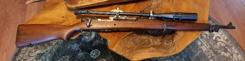

I posted this rifle up in the rimfire section but figured I'd bring it over here because it saved a low serial 1903 action and a lose m2 bolt.
As stated, low serial (jacked up heat treat) Springfield 1903. Bolt is a loose M2 from a Springfield M22. To make it work, a custom insert is machined to fit in the magazine well and fit the mag catch. The barrel is a 16 twist Douglas chambered with his match reamer. Stock is a Minelli with a custom made top side, milspec hardware. Inlet was cleaned up and barreled action was bedded. All the hard parts except the bolt are parkerized. Trigger was replaced with a Timney 209. Earle Unertl based added. Once assembled the mag insert and catch are hand fit and worked over to make the mags feed, catch/release and get the firing mechanism consistant.
It's a ton of work, but saves some history and I think makes one cool ass rimfire without tearing apart an M22.
Scopes are borrowed for the time being, but it'll wear a 16 or 20x 1.5" Unertl with calibrated head.
My buddy, who built this and most of my other rifles, spent the better part of a year acquiring all the parts and then a couple weeks on the fitting, stock work and tuning. I can't thank him enough. He's only making seven, split between single shot and repeaters. I badgered him into building it. Took a couple years for him to forget how much he hates building them for him to agree.
I really like it! I have one of the numrich .22 conversion kits for these, and use it all the time.
I think there would be a huge demand if someone would make a .22 conversion kit again.
But that looks really good, and I bet is a blast to shoot!
I actually haven't shot this one yet. I shot the original , which was an A3 that had Unertl mounts added. Tim said with SK standard they hold an inch at 100y if the wind is steady. I don't think he tried any other ammo. It'll be late next month before I can afford the scope. I'm hoping for a 20x Unertl with fine crosshair.

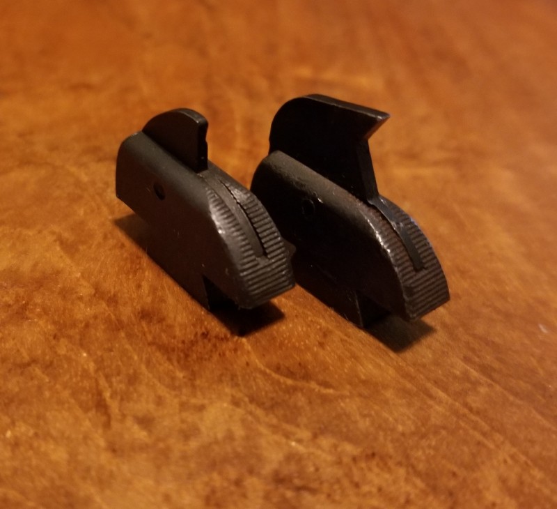

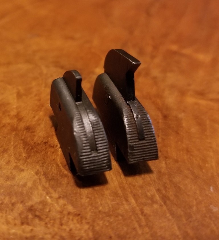

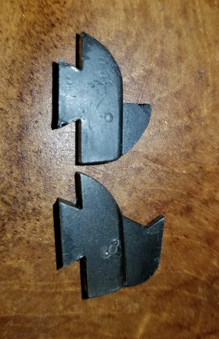

I notice a backcut USMC front sight on there is that original or a Bill Bentz repro.

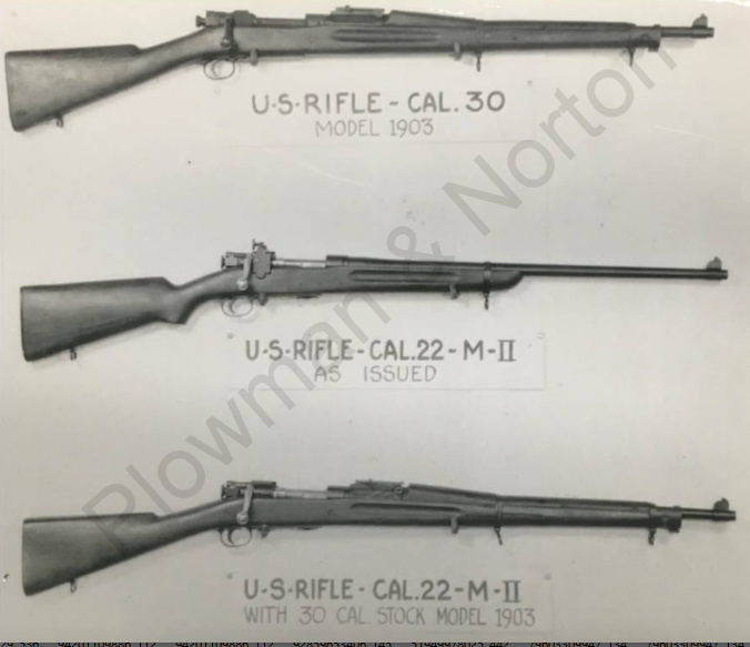

The USMC built there M2 into the "service rifle" configuration I understand. I guess their belief was that a "trainer" should look like the rifle you are training for.
Nice job. Must be a lot of fun to shoot.
I'll ask about the front sight. I have no idea.
edit: Tim made it, but pulled it off after that pic and put a non-back cut blade on. He only puts those on the centerfire rifles he builds. Now I have to bribe him into making me one :)
Do you know if the Corp used a single shot insert or if they used the 10 rounders like the Numrich kits? I don't often compliment the Corp, but I have to tip my hat to their marksmanship training and philosophy.
Pretty sure USMC just used standard stocks and used M2 magazines, 5 shots only.
The Marines used a lot of .22 rifles for training. But didn't do any inserts like the Numrich kit. They had the 1922 and the M2 .22's. As Pmclaine said at times they put the Rear sight base on the these, and used regular stock sets. To basically turn them into a .22 service rifle. But they had other training rifles too. The Remington 521T, the Model 65H&R, WRA 52C, MC-58, and Remington 40X to name a few. And I'm sure there are a lot I'm forgetting.
They actually used a lot of unserviceable stocks for these. Ones that had breaks and repairs that wouldn't hold up to .30 Caliber, but would hold up fine for .22.

I got my back cut sight. He puts standard blades up front of the rimfire because nobody is going to shoot irons with a Unertl or Lyman up top, and the standard blades are thin so why waste a back cut one a rimfire?
Here you PMClaine. Straight from the Marine docs. A 1922/M2 in a service rifle configuration.

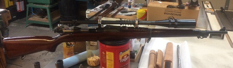

My M2.....
It shoots
My Springfield with telescopic sight...

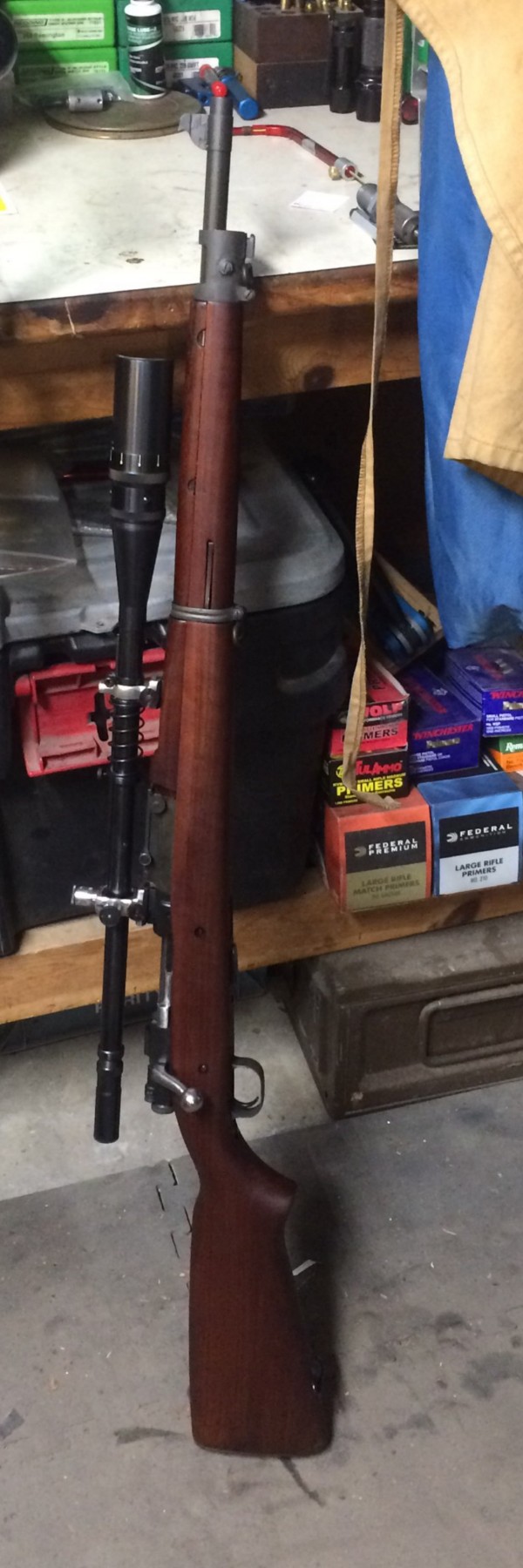

took it out yesterday. Need some tweaking. A stronger striker spring, possibly some clearance from the sear and maybe a little adjustment to the extractor. The misfires hindered grouping, but turkeys at 100 wasn't even fun. It's going to be a shooter when its sorted.

Can a standard 30-06 C stock be fitted to a 1922 M2?
You can but you will have a few problems. The major one the M1922 doesn't have the rear sight base on it. So there is no way to attach a normal handguard or even if you did, there would be a big hole missing where the RSB was.
The 2nd issue you would have to either remove the lyman receiver sight, or just cut the stock out for the lyman sight. There was a later style lyman sight that I believe would clear the stocks. But I'm not the best at that.
But the easiest way to do it, would be to remove the lyman sight all together and add a RSB. That is the what the Marines did on some of their's to make them a more accurate trainer.
