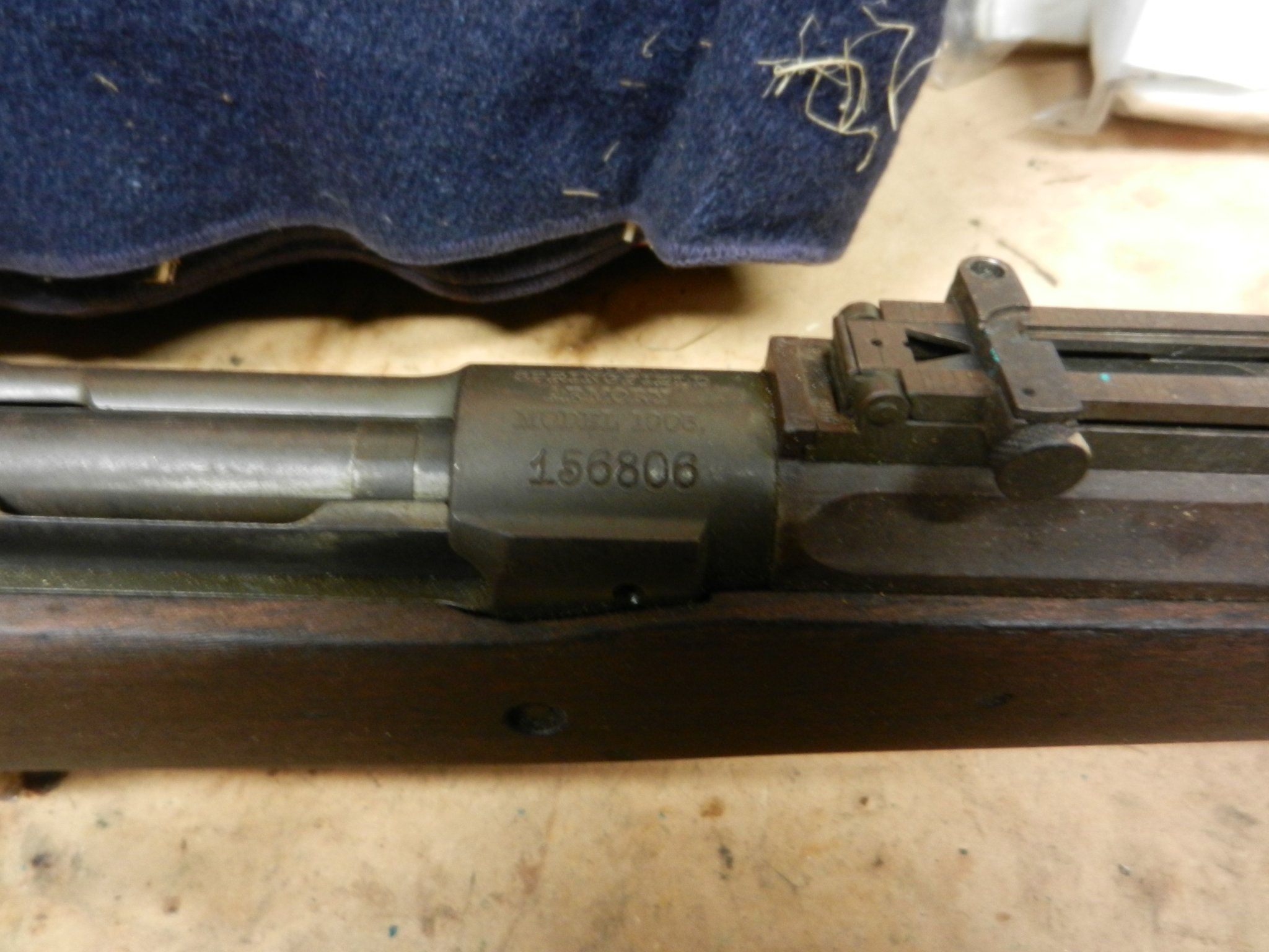

This one was produced in 1903. It's a mess for sure. I rebuilt a transmission for an older gentleman and he couldn't afford to pay me. I knew that going in but he insisted I take this instead of payment. I just put it in the safe years ago. I probably will just clean it up and make a wall hanger.
Reactions: sandwarrior
This one was produced in 1903. It's a mess for sure. I rebuilt a transmission for an older gentleman and he couldn't afford to pay me. I knew that going in but he insisted I take this instead of payment. I just put it in the safe years ago. I probably will just clean it up and make a wall hanger.View attachment 7010849
It would be a more fitting tribute to this rifle to make it into a 22 than a wall hanger. I am currently looking for an early one to do this with.
