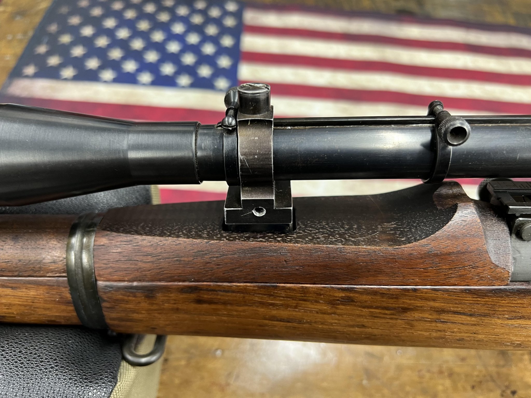

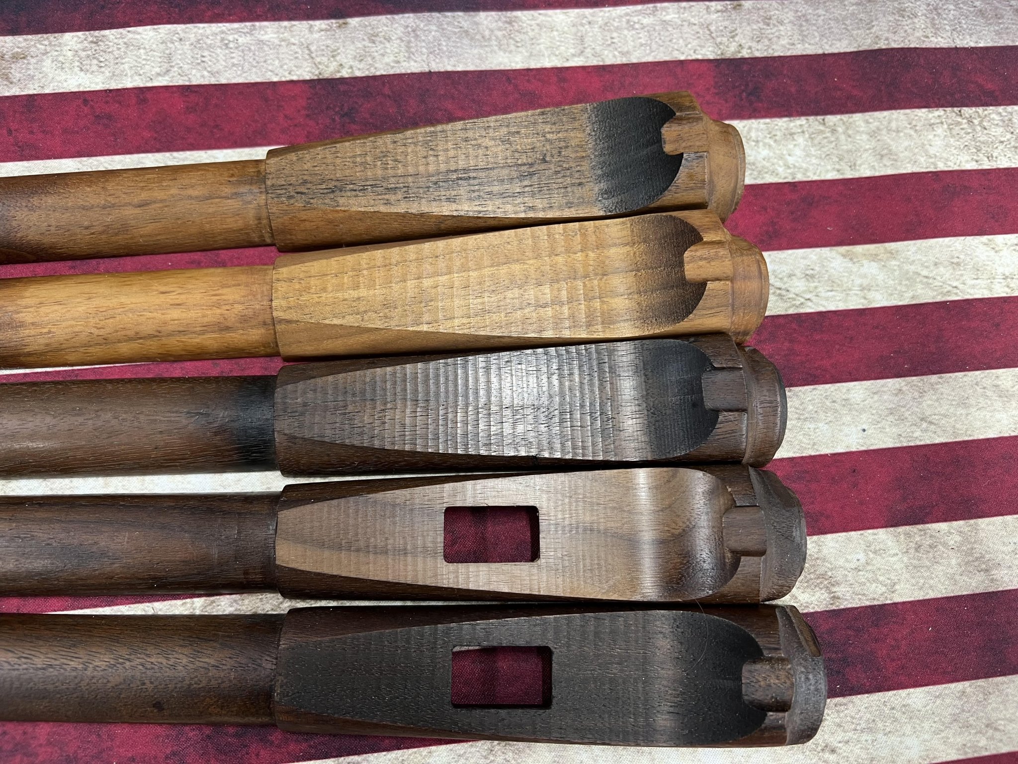

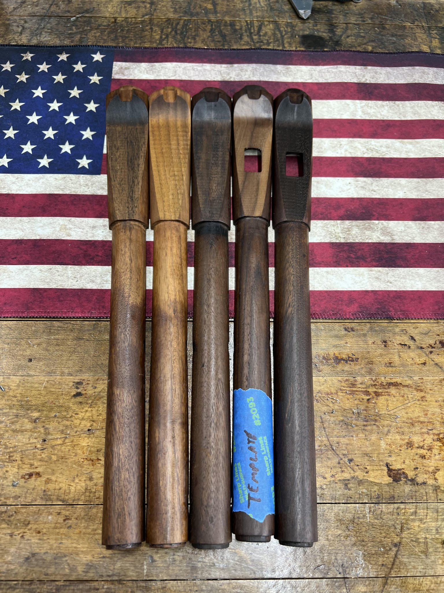

Got my new cutter and built a fixture to hold these and to cut them, doing my best to replicate the chatter marks on the originals. I think the turned out pretty nice. Practiced on a mix of used and NOS ones. Last photo is one I found online that I used as a model.

I think I found an old 1.5" 6-flute HSS end mill for mine. The bottom of it was chipped to hell and it was about to get scrapped. Holding by the "thin" forward part of the handguard in a vise gave a bit of chatter and plenty of scary noises :ROFLMAO:

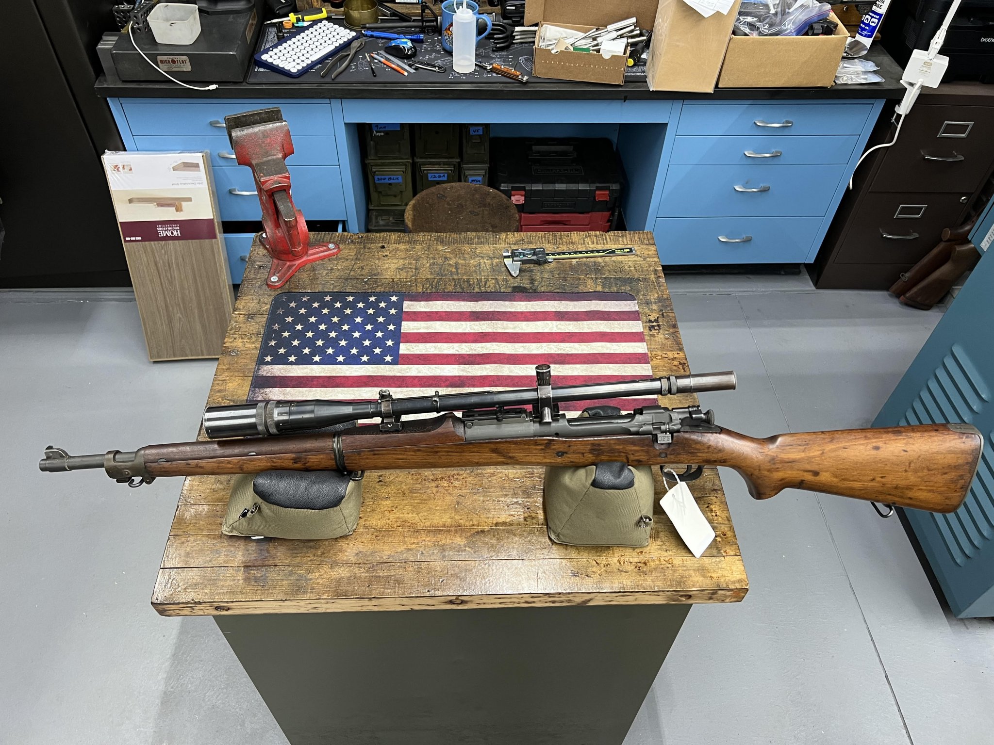

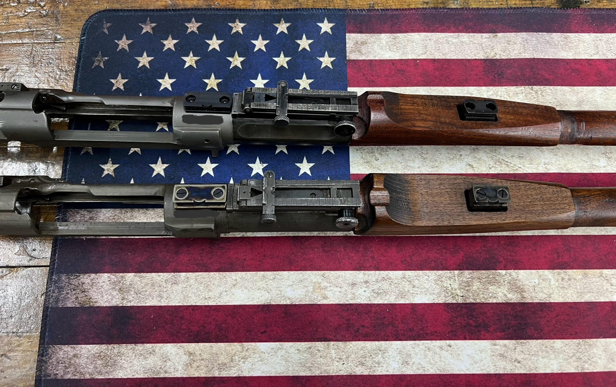

Sounds like a good candidate. I just finished these two for customers.

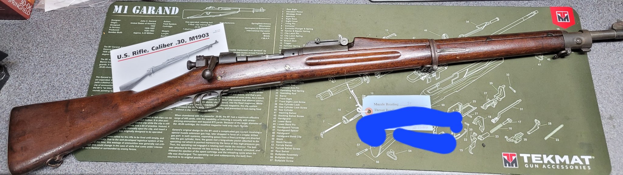

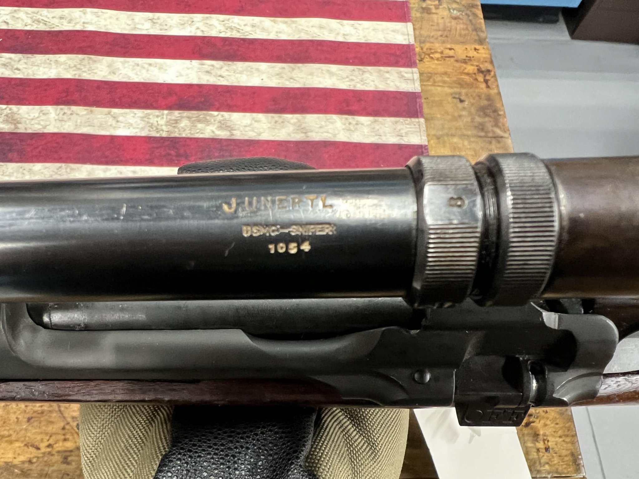

Here's my base to start with. Stock is in decent shape but wrong type. SN122####
Looks like a Minelli C stock and a Gen 2 Hi Lux are next. Once sourced, I plan to ship it to the CMP custom shop for the rest.
