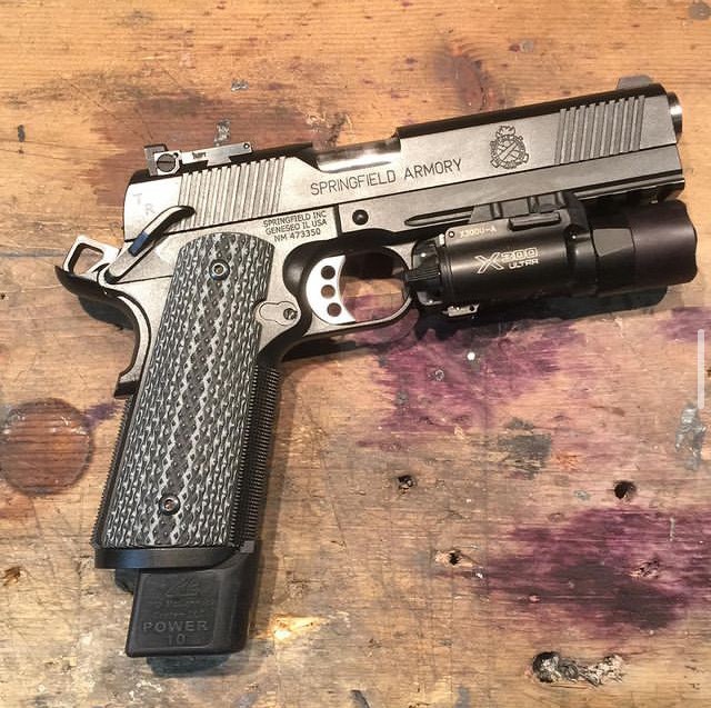

For a while now I have desired a long slide 10mm 1911 . I currently have a spring field TRP operator which I also very much like to shoot . I currently live behind enemy lines in Southern California so with the current handgun roster its not as simple as going out and buying a 10mm 1911 . Is it possible to take a long slide and put it on a 45acp frame ? I understand there is some fitting with 1911's that's no problem . If it is possible is it or is it not the case that 10mm can damage 45acp frames ? is that real or a myth . I apricate the hides advice

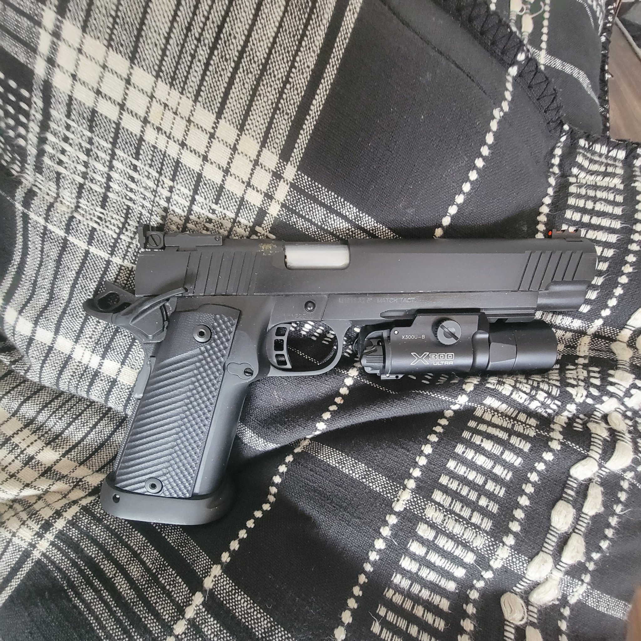

Rock Island 52000 double stack is WELL worth the $1000 price tag. It is hand fit, bank vault tight, an absolute lazer and holds 17 rounds..
RIA 52000 gets my vote
