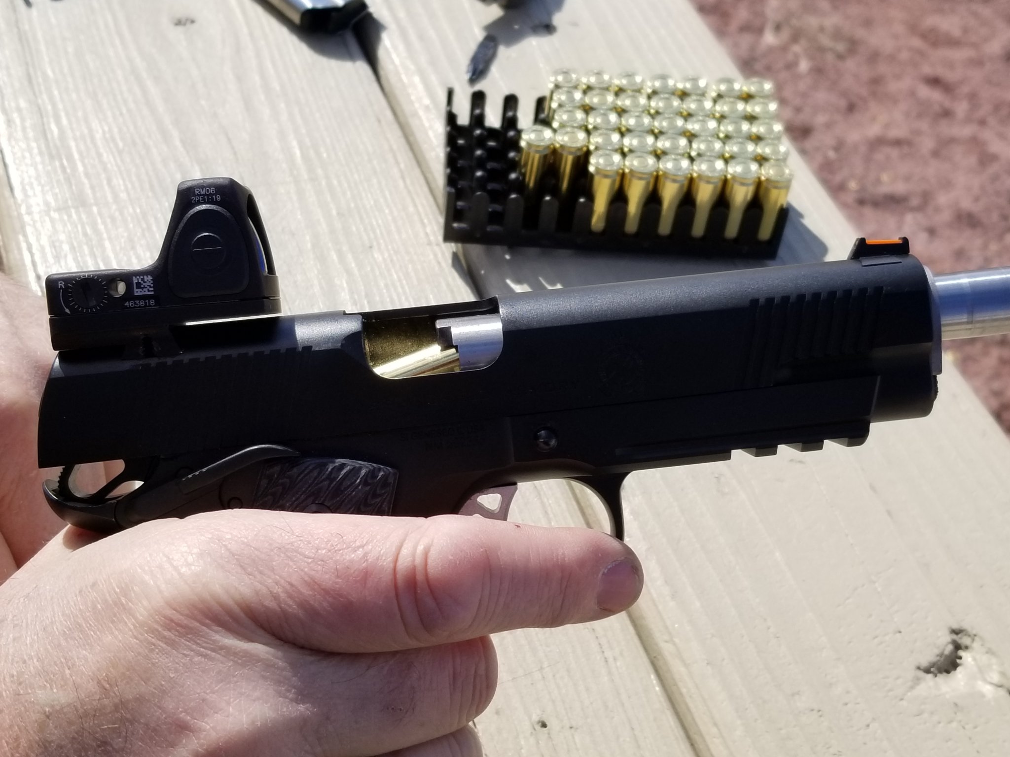

I have a Springfield Armory RO Elite Operator 1911 in 10mm.
First time out to the range, it shot 100 rounds flawlessly (not one malfunction). I was shooting 180gr FMJ Sig ammuntion.
Decided to install a Trijicon RMR using an EGW dovetail mount and went to the range today to get it all sighted in.
This time I brought a couple of new Wilson Combat mags another 100 rds of ammo (1 box of Magtech and 1 box of Sellier&Bellot, both 180gr FMJ).
This range session resulted in 1 failure to feed after another. It made no difference between the boxes of ammo. Tried both ammo brands in the original mags and also both wilson combat mags.
Could the issue be with the weight that the RMR and dovetail mount added? Cheap ammo?
Also note that before my range session today, the gun was stripped, cleaned and oiled well.

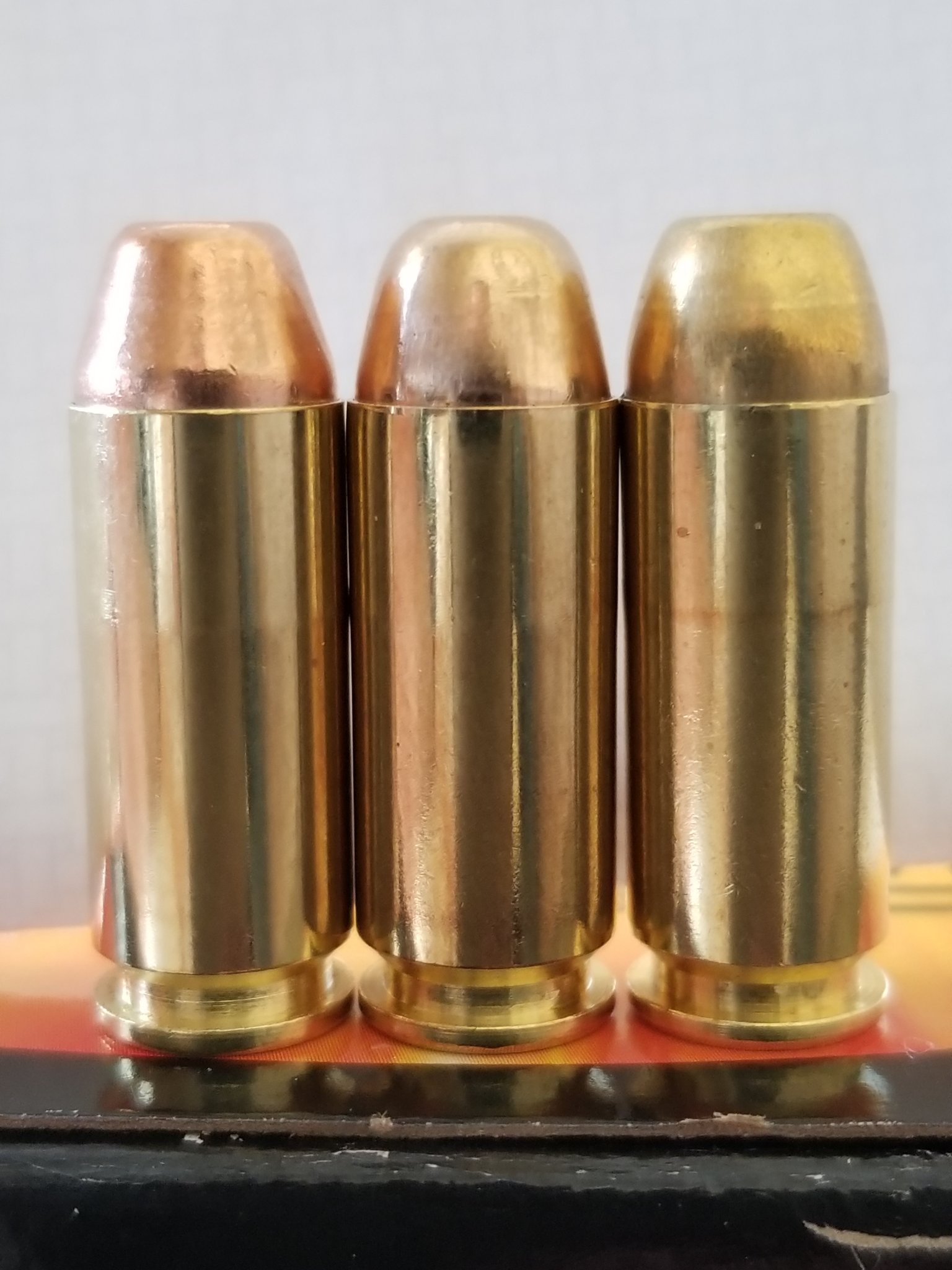

By chance are the bullets a different profile than what you started with? Reason I ask is one of my 40 S&W's does not like RNFP but is fine with JHP.
So I compared the bullet profiles.
All are FMJ but the Sig bullets are almost completely rounded, whereas the Magtech and Sellier have more of a flat nose.
I will pick up a box of the Sig ammo and give it another go hopefully tomorrow.

I just compared the three different rounds.
Turns out that the Sig ammo lists 1250fps and the Magtech and Sellier are both 1164fps.
Now that I think about it, the Sig empties were ejecting about another 6 - 8' further than the other ones.
I will give the Sig ammo another try tomorrow.

It looks like the bullet makes it up the ramp but the rim might be hanging up on the extractor.
Maybe the extractor got clocked a little if it or the firing pin stop were removed when you installed the RMR.
If you added a flat bottom firing pin stop when you installed the RMR, that will slow the slide a bit too.
My gut feeling is that it's extractor and the slightly slower slide isn't helping.
A 1911 reliability job has a certain amount of smoothing on the extractor hook to make the case rim slide under it easily. Make sure yours is done right and passes the tension tests.
