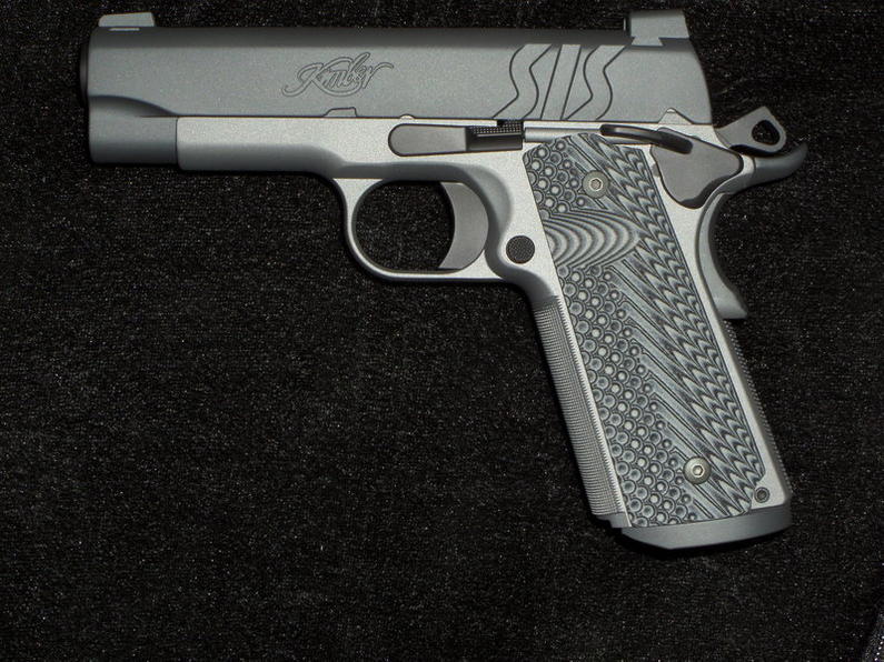

This is Cerakote on a Kimber SIS Pro. Colors are Tactical Grey H-227Q, Sniper Grey H-234Q, and Graphite Black H-146Q.
