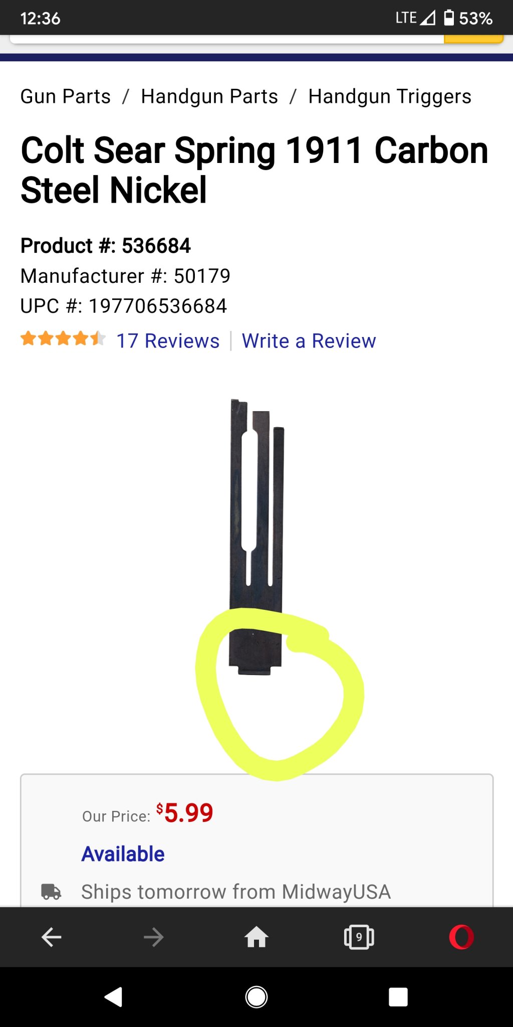

I agree, must be the sear spring. Wonder if he's talking about the bottom tab (circled) or the end of one of the fingers. Either way, I doubt it'll run. Don't fear tuning, just means bending those fingers a little. Info is easy to find.

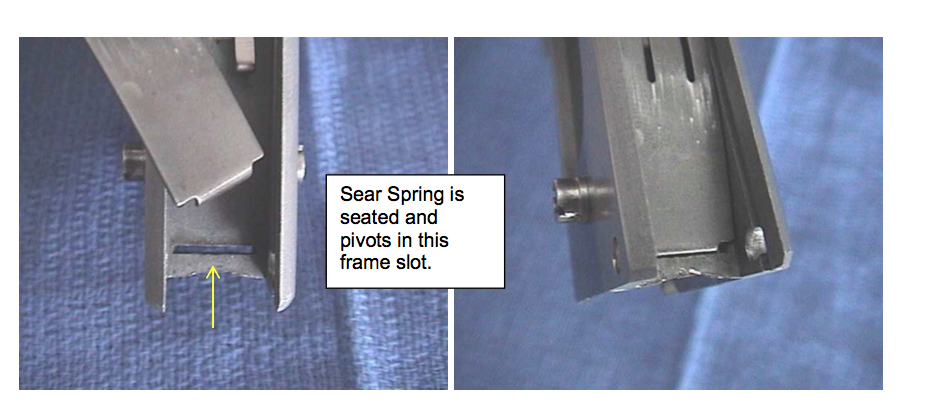

Bottom tab locates the spring

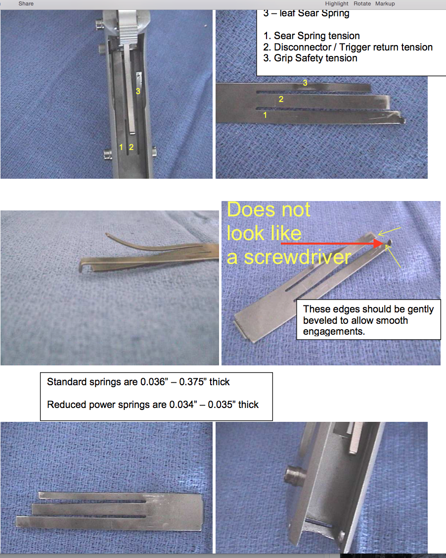

the little bend on the left leg is only there to disassembled the mag catch I think.
Yes that is the spring, But it is the little tab on The left finger, not the locator at the bottom.

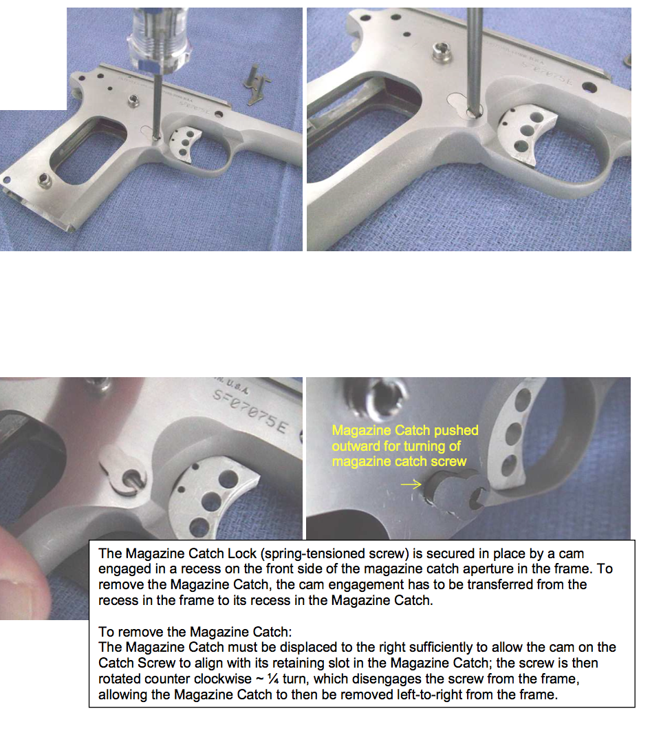

Thats exactly how it broke. Per instructions using it to take down the mag catch
there’s a small window in the mag catch’s depression range where the little screw turns

Tuning is a piece of cake. Just bend it until you get the engagement and feel you want. If your new one is shipped in a plastic bag or other soft packaging you will likely have to put a little bend back in it anyway. Usually the part the engages and puts pressure on the grip safety gets smashed flat.

Uh, I've owned 1911s for 20yrs and didnt know this. I've always used a proper sized hollow ground flat bit. OP, there is a very narrow window to push the mag release. Lightly turn on screw as you depress the mag catch.

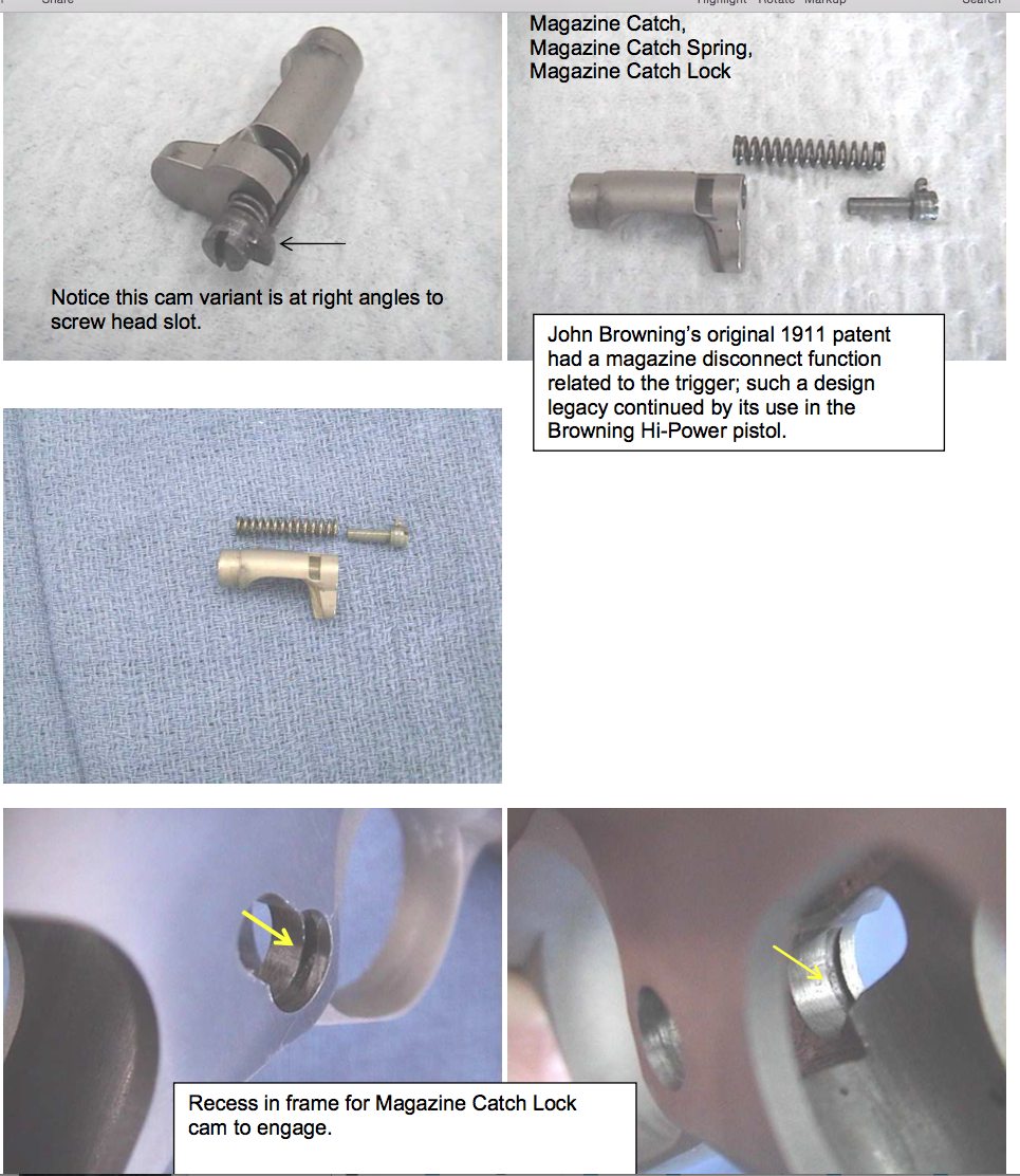

PSA -Unless you find yourself on the Gomer Pyle TV set and Sgt. Carter insists you must effect a magazine catch removal evolution, it is poor gunsmithing form to attempt disassembly of the 1911 with empty .45 cartridge and sear springs. Someone has already mentioned the proper style screwdriver for the task. "Per instructions to take down the mag catch"? Please post those mfg. instructions as I have never seen or heard of such a recommendation and I am pretty familiar with the platform.

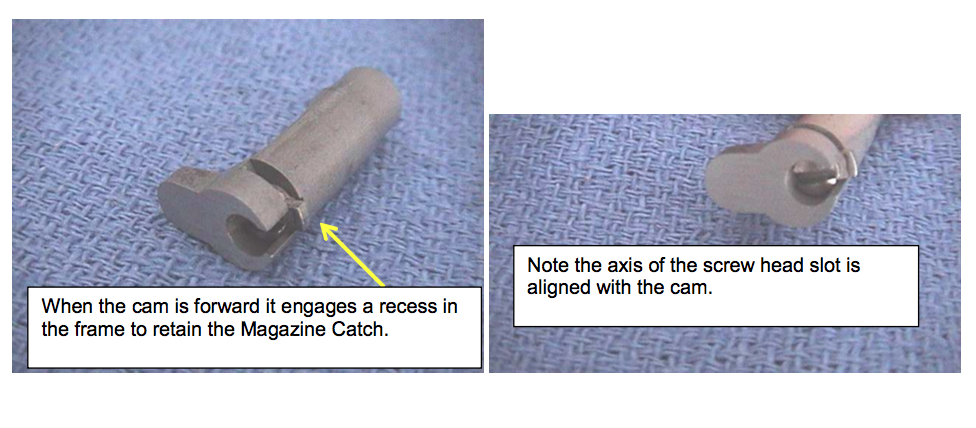

Also, note that some mfg. locate the retaining tab on the magazine catch aligned as well as at 90 degrees from the screw slot.
