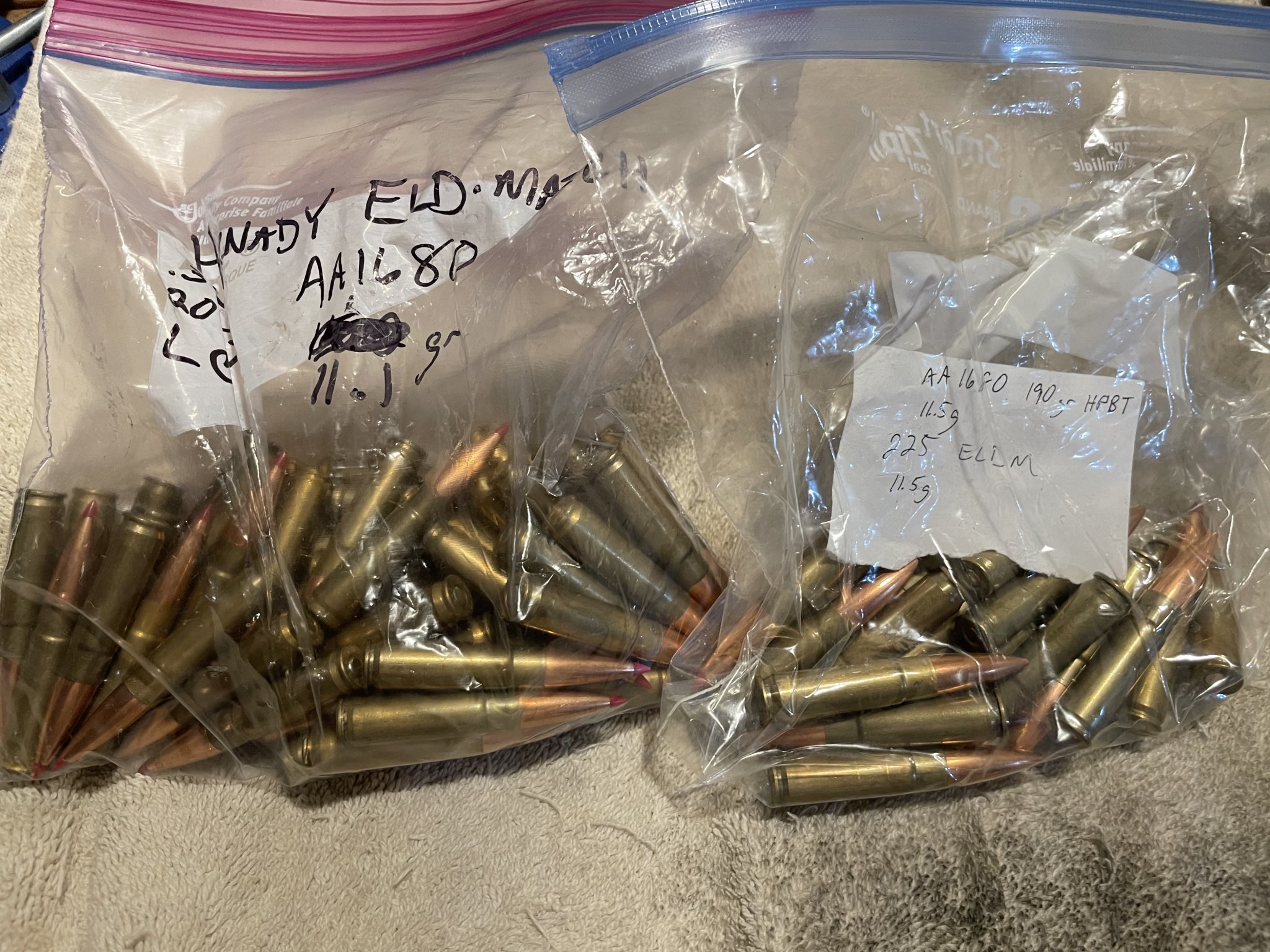

Here’s a couple bags of what was left over. No need to justify, just sharing some data for someone looking for starting points. 🍻
