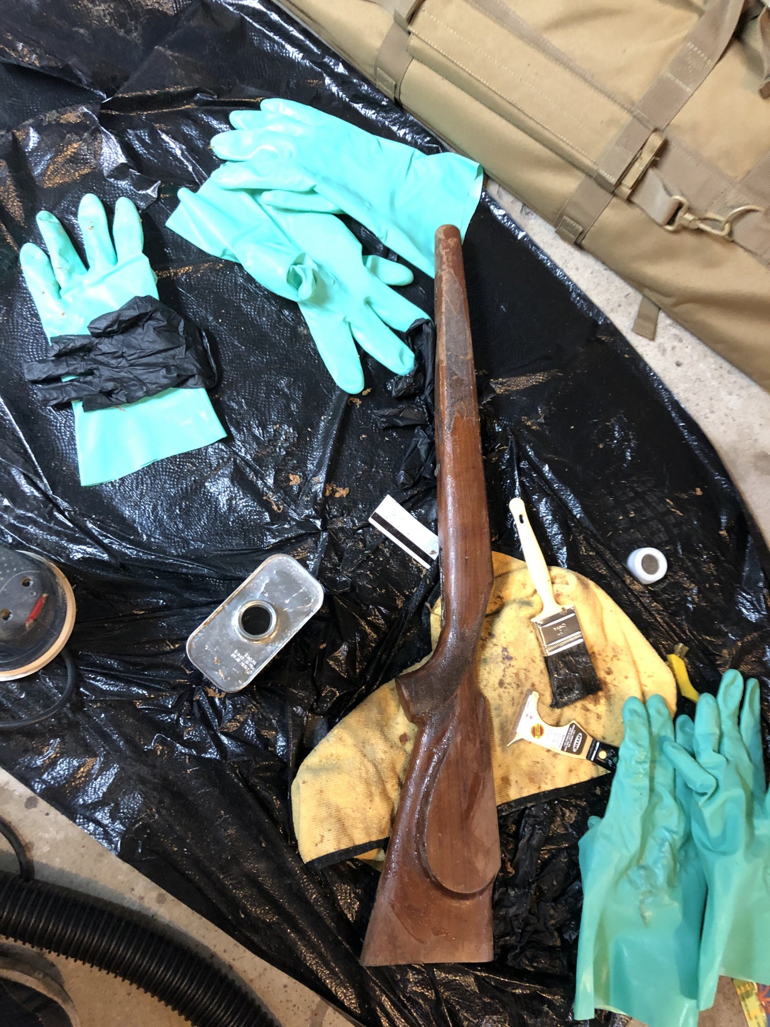

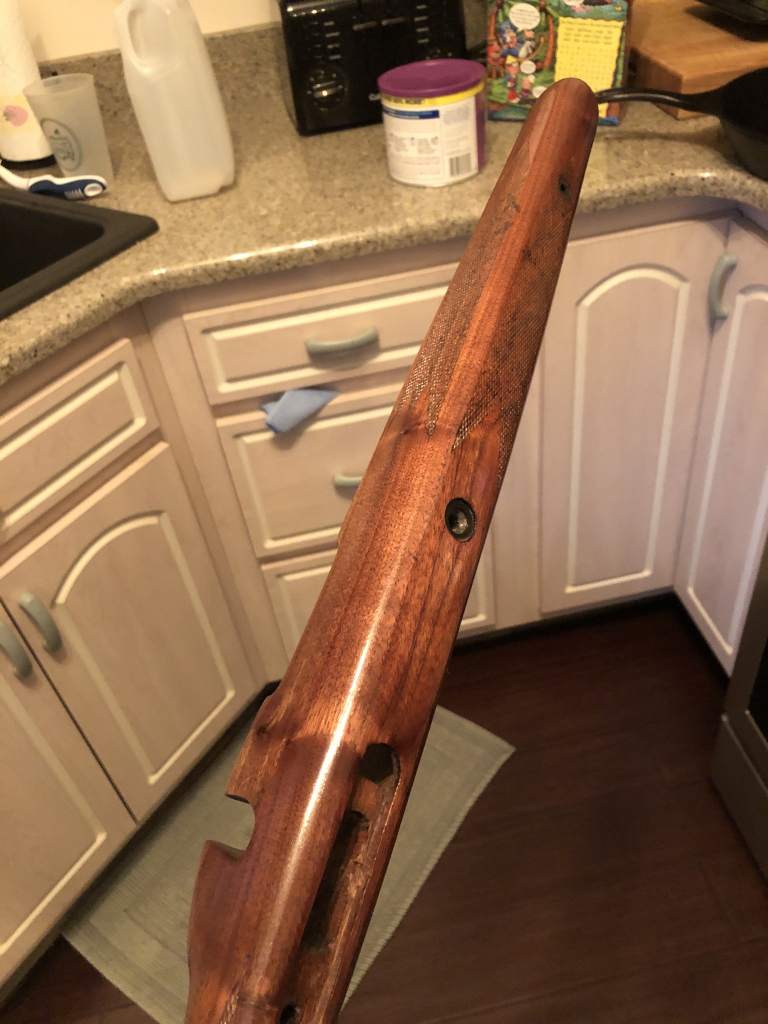

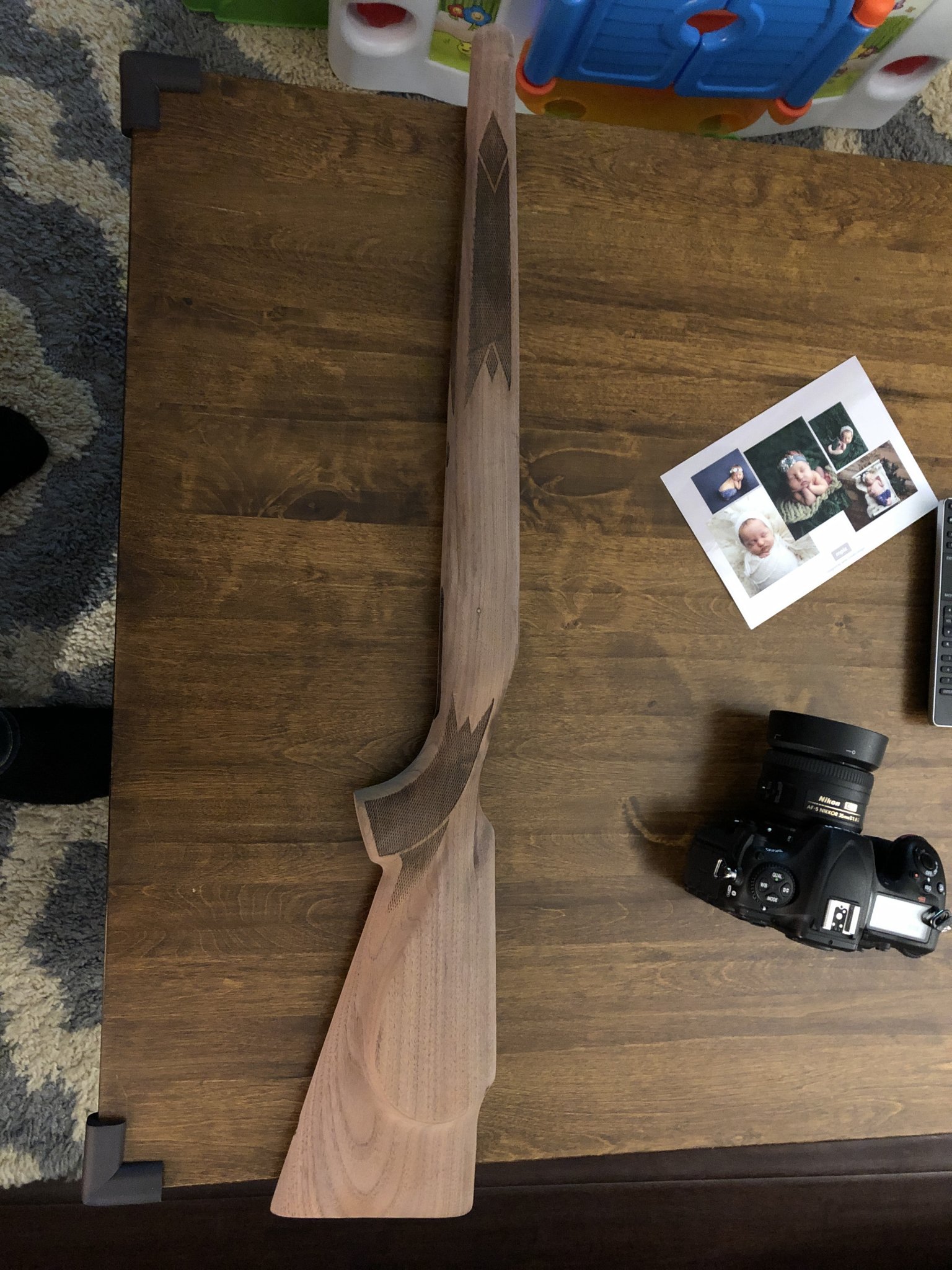

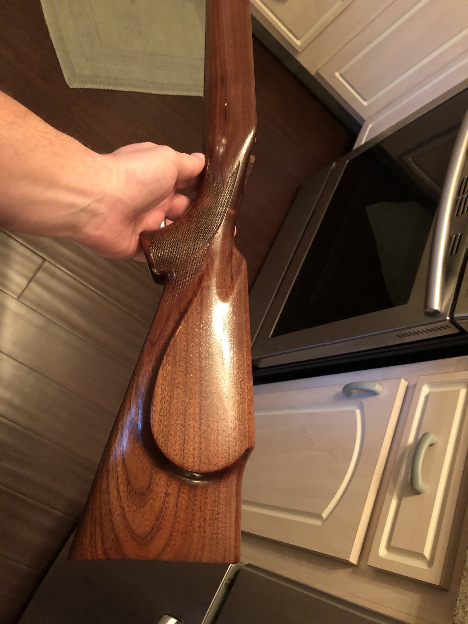

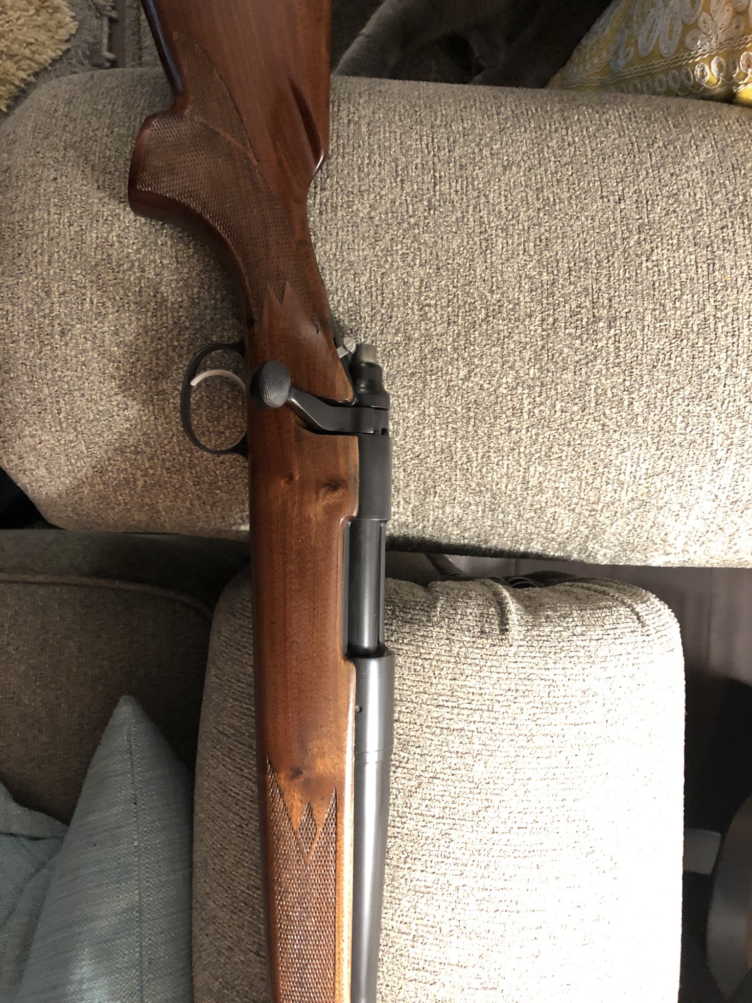

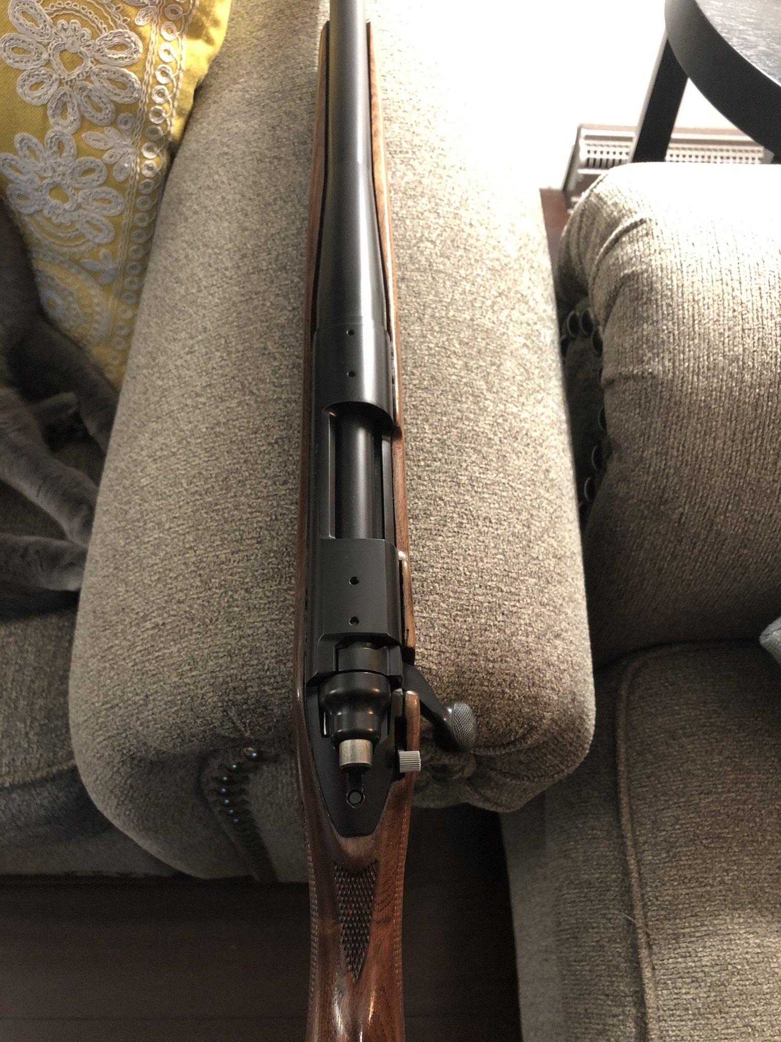

I took off a ‘77 barrel a few months back and made it into a 450 Bushmaster for Ohio hunting. I ended up chucking it in the lathe and cutting a relief cut in the barrel and it came right off. I wasn’t equipped to get all those years of corrosion loose via the normal method. Also, the 40 year old walnut cleaned up nicely. I was pleased for just being a no talent bum with a garage lol.
Anyhow, figured I’d throw in my 2 cents since we had such similar guns to start with.

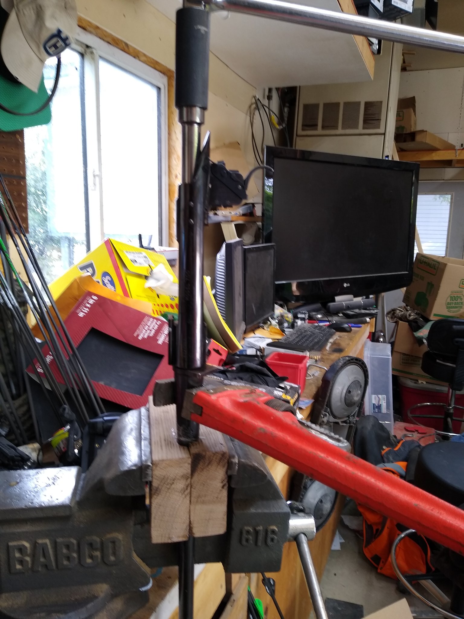

Broke one loose today, 1969 by proof mark.
Little bit of heat to warm up the thread locker, pipe wrench on the barrel and a defiance wrench. Then I swore at it and grunted and it popped loose.
Maybe I got lucky that I didn't have any real rust. I did kroil the threads from the inside a few weeks ago.
