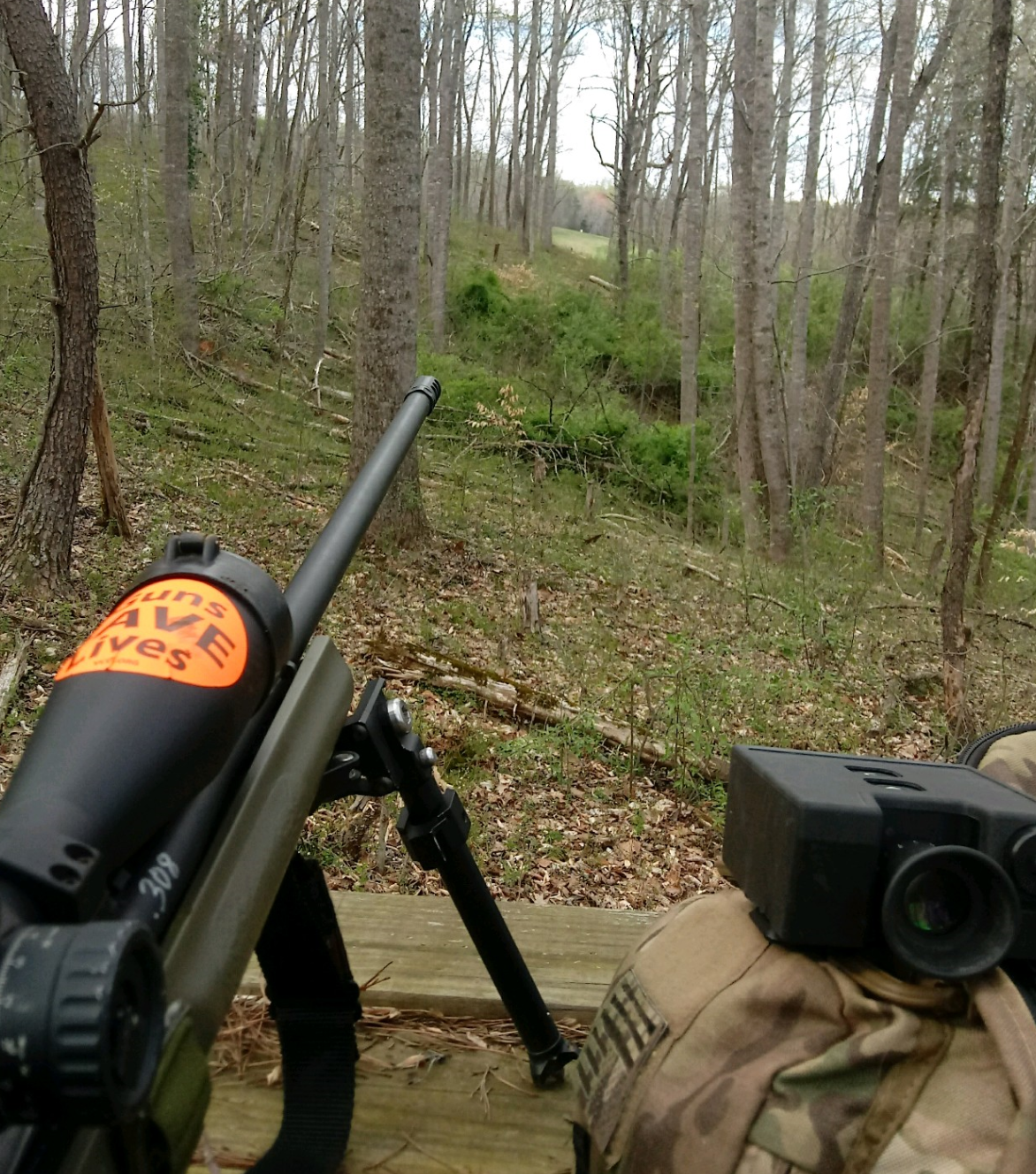

Here is the lane. Note this FP is on the side of a wooded hill for about 150 yd and it drops off steeply about 100ft down to a creek, and then goes across 650 yds of pastures, then back into woods for about 100yds. Wind is tough to judge to put it mildly. You can just barely make out a large paper poster I was shooting for groups on. Just past set back in woods is the camo'ed target, the 12" tall, x 24" wide yote from JC Steel : https://jcsteeltargets.configio.com/pd/312/coyote-38-thick?returncom=productlist&source=search
On the scope, check out my VCDL "GUNS SAVE LIVES" Sticker from the 2A Richmond Rally! Thank you VCDL for defending our Rights.
