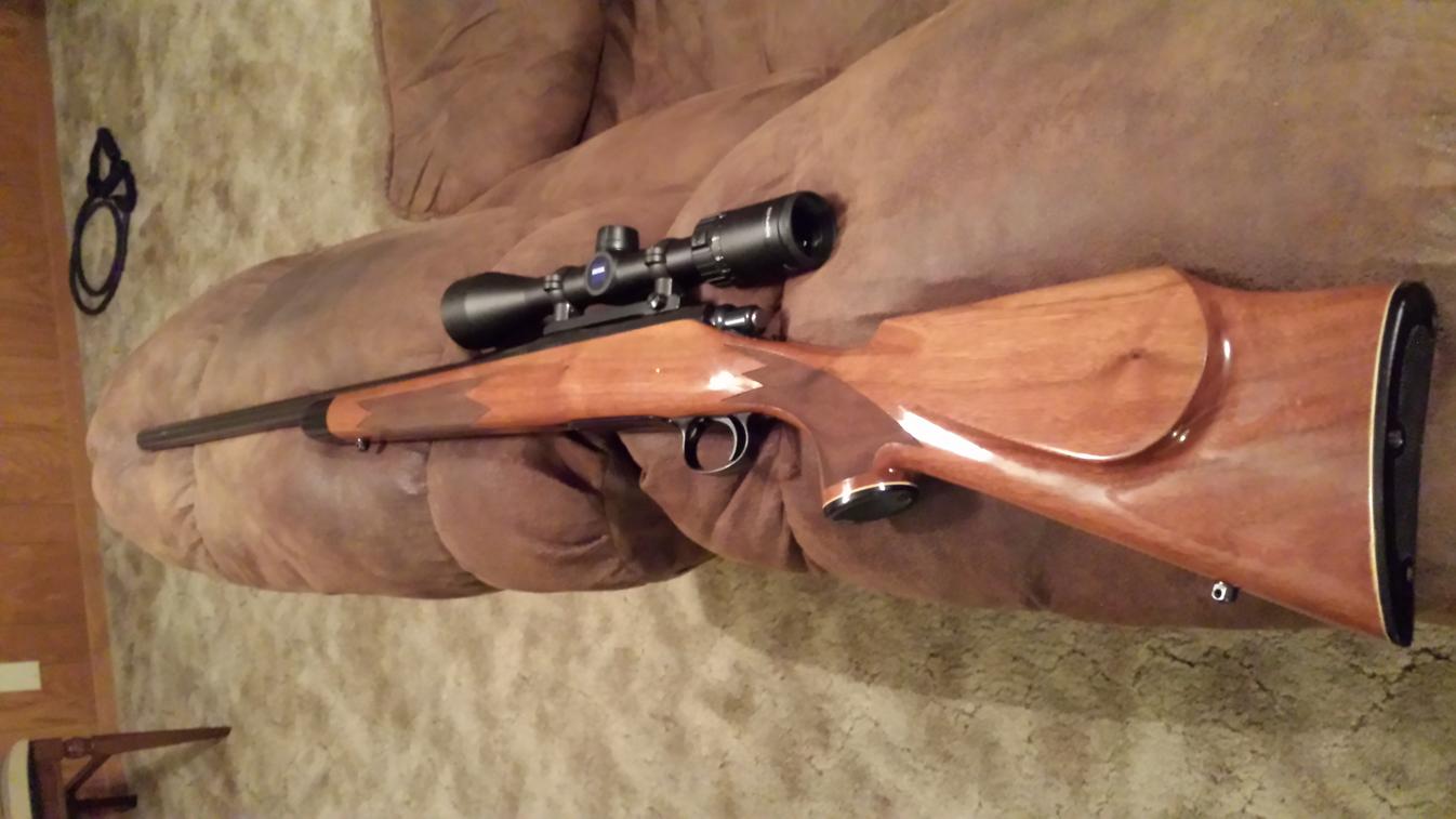

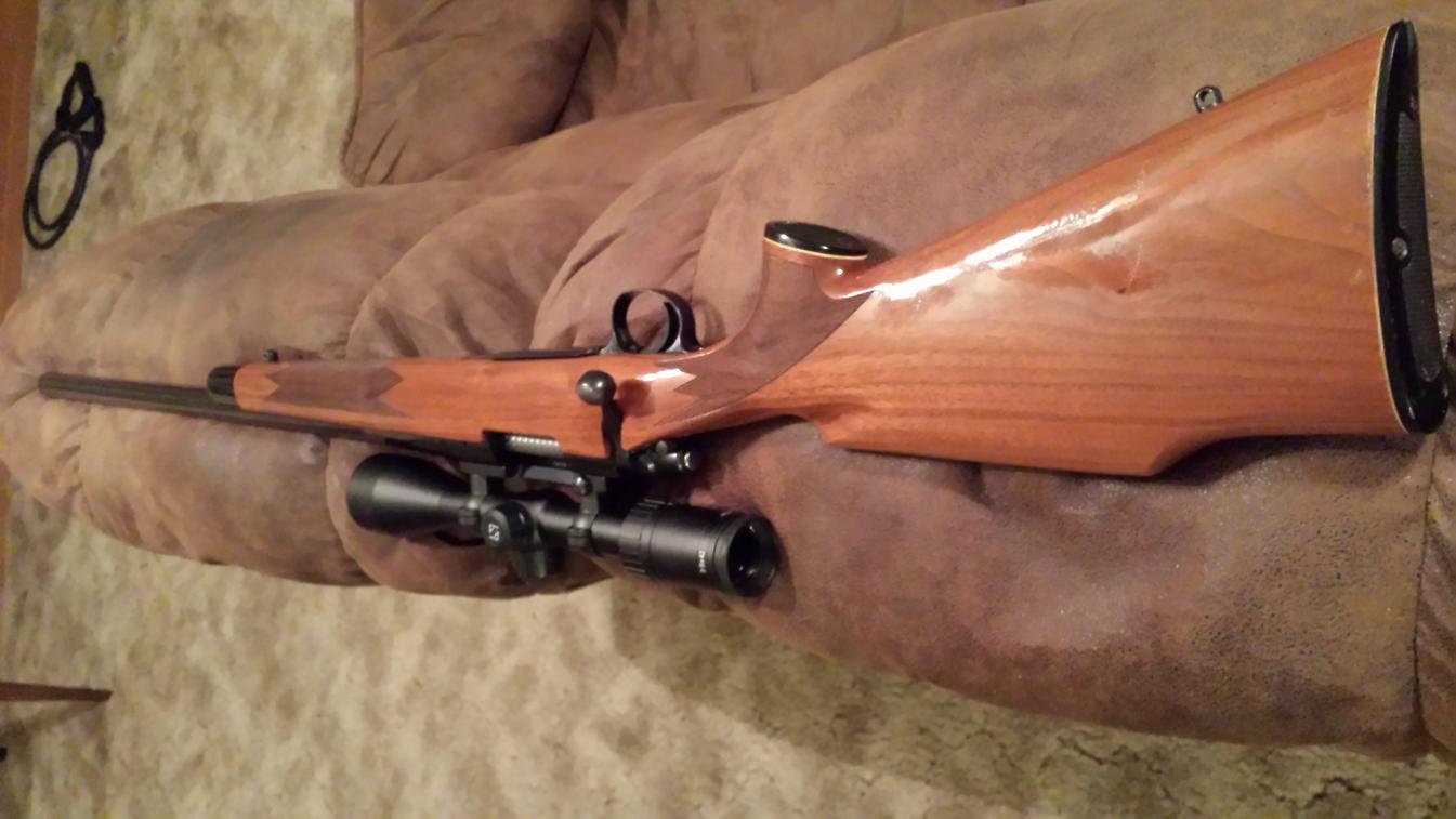

Just picked one of these up the other day and mounted the new Zeiss Terra 3-9x42 on it.
First .243 I have ever owned.
It is mint with factory barrel. Referenced the serial and it comes back 1997 production.
I am looking for an answer to a few questions I have.
First, what rate of twist was the barrel for this rifle? I am getting mixed info. Some say 1-12 others say 1-9....need help.
Second, I hear they can shoot, but any ideas on accurizing this rifle? I would like to put a Timney in it. But I want to leave the stock, it is a pretty light blonde stock.
Just looking for some thoughts.
Best group I got with HSN 95gr Berger VLD's the other day was 1in....
Thank you kindly,

I have had great luck with Remington Premier ammo out of my Rem 700 LVSF in .221 Fireball shooting 59gr. Have not even attempted to reload for the rifle due to the fact that the gun can touch em dime size 5 shot groups at 100yds. But I would like to try for that out of this rifle. Might try a few 75, 95, and 100 grainers in this .243. As you can see it has the original stock and its very clean. I may replace it someday but I believe it to be a pretty cut of wood and like the old look. I will definitely take the advice on seating my bullets to the lands, that's usually how I always set my dies for a certain rifle. By chance have any of you had a chance to look through one of these Zeiss scopes, they have always been out of my price range(Been a Leupold guy for years) but they sure are clear! And in low light as well!
