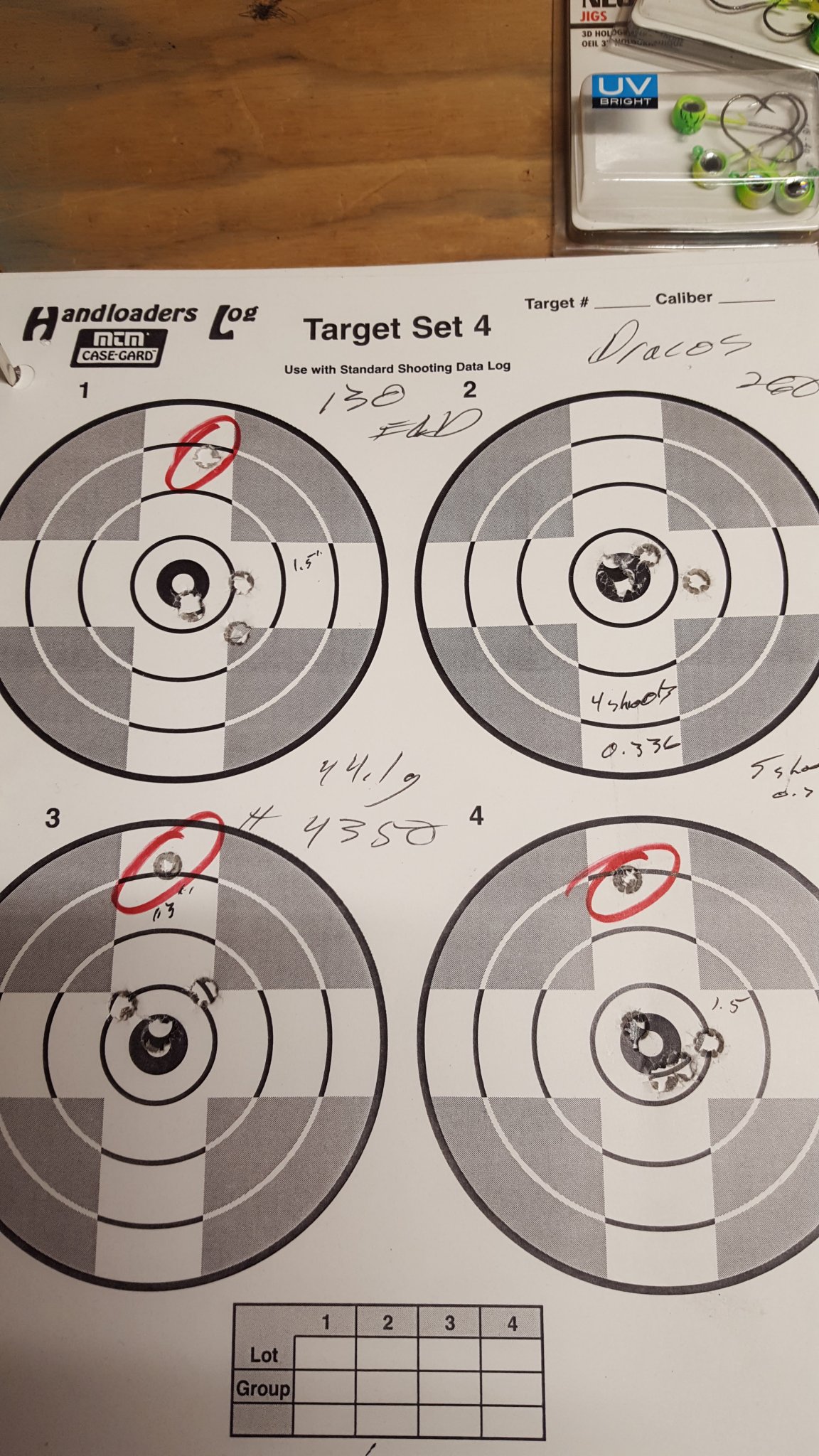

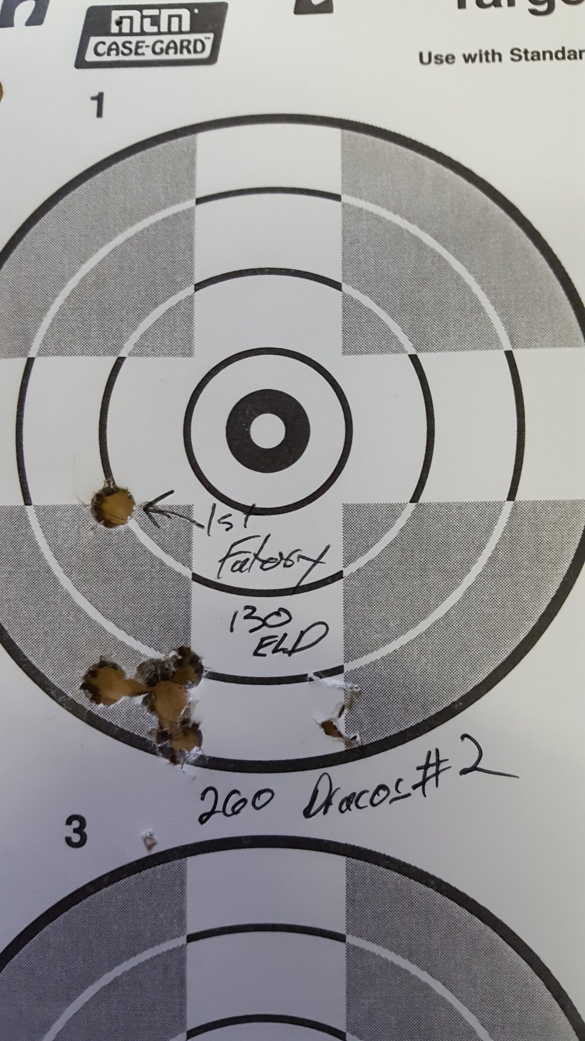

I have an interesting and infururating phenomenon going on with my AR 10. More correctly it’s a DPMS style large frame AR. I have a JP upper and a DPMS lower. Anyway, I bought a Dracos barrel in 260 Rem to replace my JP 260 barrel. I had nothing but problems getting it to group. More specifically it would shoot the first shot high and group the next X number of shoots very nicely about 1 inch below. It shot very well except for that first shot. So well in fact that I went to great lengths to figure it out. The interesting thing is that it only happened when the barrel was cold. If I kept the barrel warm by shooting another group within a minute or two they all grouped very well. If I waited 5 min or so, then I was back to 1 high and the rest 1 inch lower. This was repeatable through powder charge increases when shooting a ladder test. This was with 130 ELDs and H4350. I also shot 123 ELDs and got the same result except closer to 2 inches between the first and the rest of the shots. Talked to Dracos many times and tried many things, they all yielded the same results. So Dracos sends me a new 260 barrel. Same thing. I even think that maybe my JP receiver is warped so I build a whole new rifle out of Aero parts and get the same result. I also tried unsupressed, but all it changed was the orientation of the first bullet to the rest. Finally Dracos takes back my second 260Rem barrel and sends me 6.5 Creedmoor. Same result. I’m handloading mostly, but have tried factory ammo with the same result. Been working on this for over a year. I keep my hair cut short or I would have pulled it all out by now. Any thoughts on this?
Have you chronoed it to see if the velocity is different?
Just a couple examples. You can see very acceptable groups when I don’t let it cool.
There’s no difference. And how could that be it? It’s always the first shot on a cold barrel. If I have 10 of the same powder charge in the mag and shoot 4 then let it cool and shoot 4 more. That 1st shot of the second group does the the same thing. Even though it was auto loaded and was just sitting in the chamber.

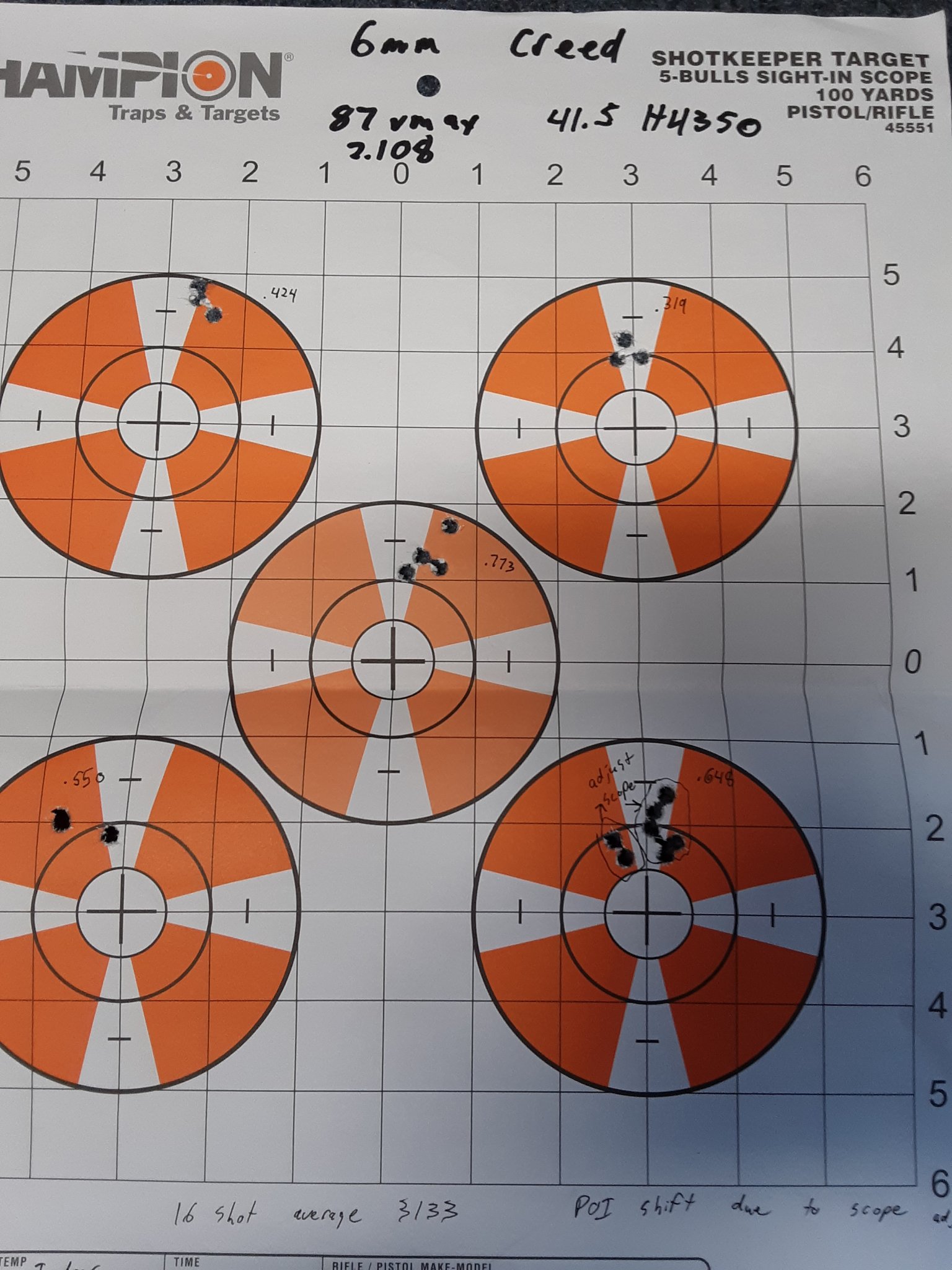

Ok, now to really get your heads scratching. I’ve since got out of Dracos barrels. I also had a 6mm creedmoor Dracos on a completely different upper-lower combo that had similar results. It also had the fun tendency of completely changing POI every time I took the suppressor off and put it back on. Meaning my suppressed zero would change. Anyway, I recently bought a Poof carbon fiber in 6mm creedmoor. This barrel does the same thing but opposite. Now the first round is low and the rest are about 1 inch high and 1/4 inch left. WTF? Again it’s very consistent even through escalating powder charges. I’m willing for my shooting form to take the blame on this one but it doesn’t make sense. I’m not new to large frame gas guns. Been shooting a 260 Rem JP for about 4 years. Never seen this with that rifle combo, or my AR15 or of course bolt guns. Can the problem really be just between my ears?

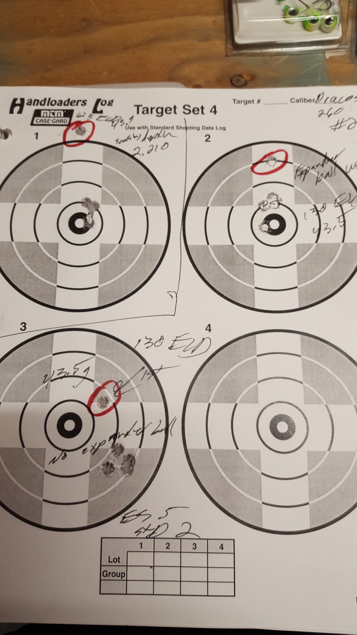

So I have a Dracos 6.5CM barrel. I've read a few others have had an issue similar to yours though. My sample of two barrels doesn't do what you described. However, it does start to double group after 8-10 consecutive shots.
I think it's one of two issues (possibly both):
  1. Before you shoot your first group, forcibly flex the barrel up and down by hand inside handguard. Make your last movement a downward push. Shoot your group. If this solves or changes first round POI, check your gastube isn't binding in the upper passthrough or barrel nut. This happened to me (result of another stupid idea to bed the barrel to the action).
  2. If above doesn't change POI, issue is likely with construction of barrel: the barrel, sleeve and end cap are three separate pieces pressed together. If the inner barrel is aligned top/bottom after it cools, it will likely "kick" during shot and throw high/low left right. Subsequent shots do not exhibit this because the barrel has been "relieved" of stress for a moment and can center or "free-float" inside the shroud and end cap. Unfortunately, I don't see a way to fix this easily; it's an artifact of the design and tolerances.
I'm going to shoot you a PM. Give me a call and I can chat with you about what I've tried and experienced to resolve similar issue.
