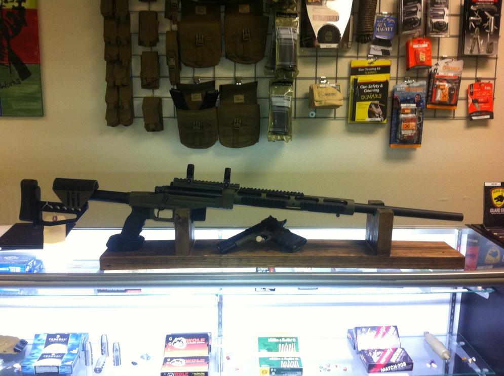

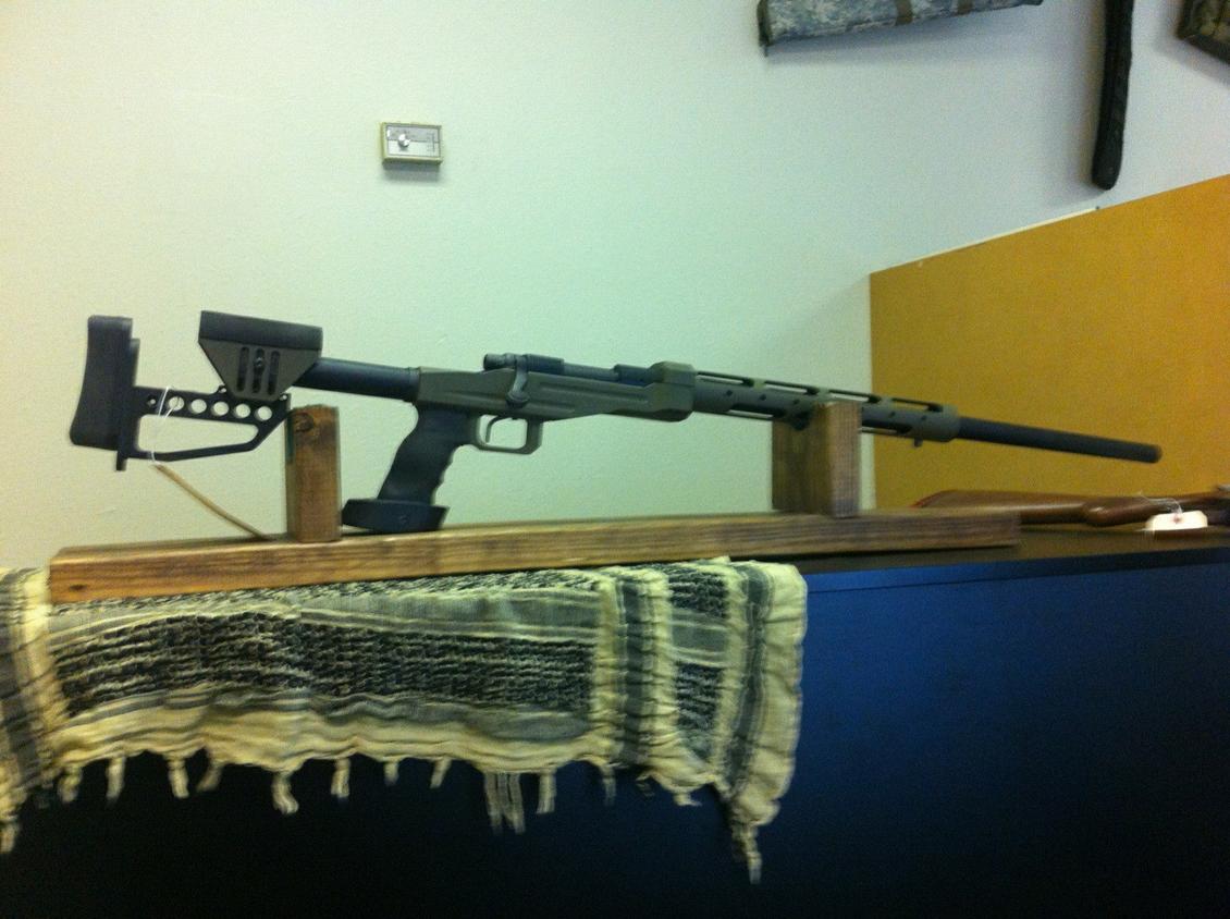

Rifle almost done
As my build near complete I was thinking of leaving it at 27 inches and try it out like that before I cut anything off it. Once its gone there is no way of getting it back on is the way I see it. Anyone else run a 6.5 at 27 inches?

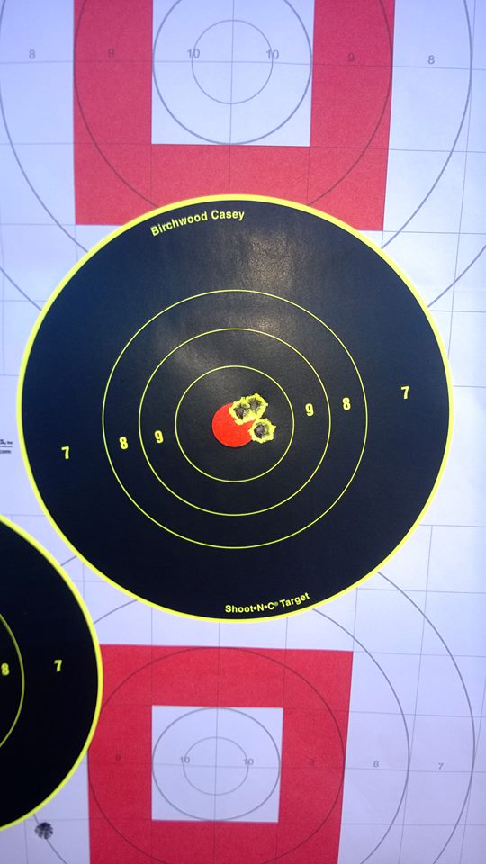

Range report
Took the rifle out today. results were good. 3 shot group at 100 yards with 120 Amax Hornady Factory ammo. For some reason it didn't like the 140s.
-Rene
