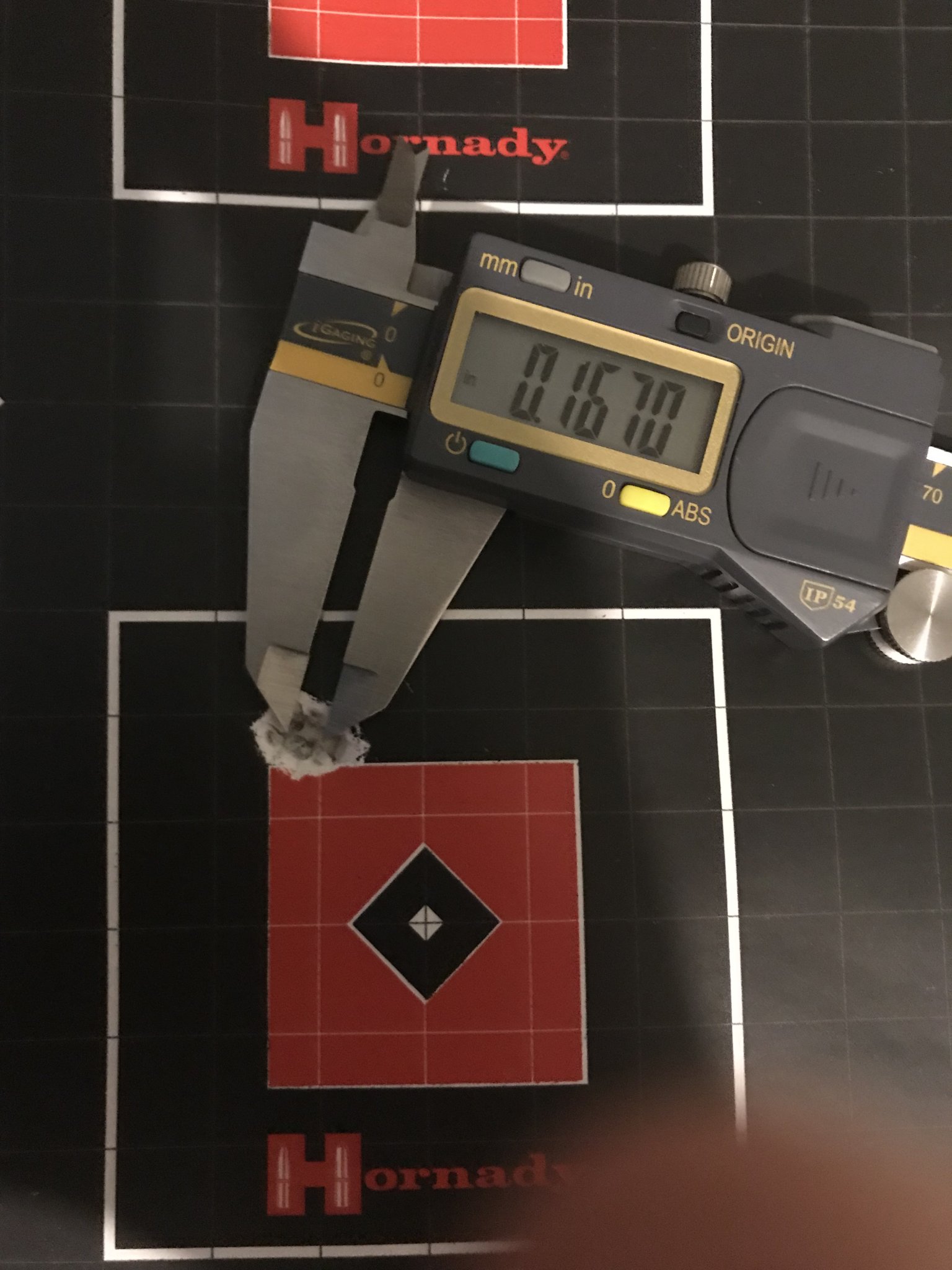

I know sever people have done 1 hole groups with the rpr oem barrel. So maybe this is not impressive. But this group can be shot pretty regularly with hornady factory ammo on the kreiger
That''s a wow in my book. I'm doing okay with mine. I've got a couple loads where all the bullets in the group are touching at 100. Mine shoots good. I've only owned my RPR since this early spring and started reloading with my army buddy in AZ last January. He owns an RPR in 308, so when I got back home I bought one in 6.5CM (same as my RRA Ar-10 is chambered in). I'm happy. Not a competitor or competition shooter. Retired and all this is one grand hobby. Enjoy it a lot.
