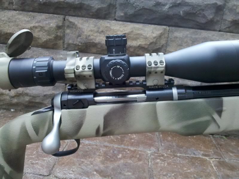

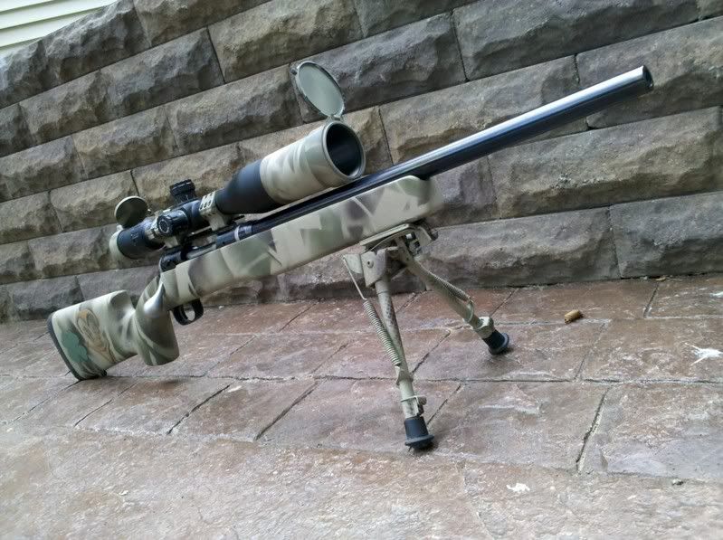

Go on and get the EGW 20moa base. like many have said on here, better to have and not need then need and not have.
Low rings will work just fine.
This is a stevens action with a #7 contour barrel.
Weaver 20moa base (EGW base is a little taller)
Weaver low rings (.25")
Weaver 3-15x50 scope
Re: 2 final questions to complete the set up
hey, fast : That is a very nice stick, alright ... Thanks for solving the rings height problem . That height is perfect .
I have some doubt on the 20 Moa base because perhaps the scope won`t go down enough for shorter distances like 100, 200, 300 yards ... it has 65 Moa of adjustment , but if you guys say that it would work , then I will get the 20 Moa .
