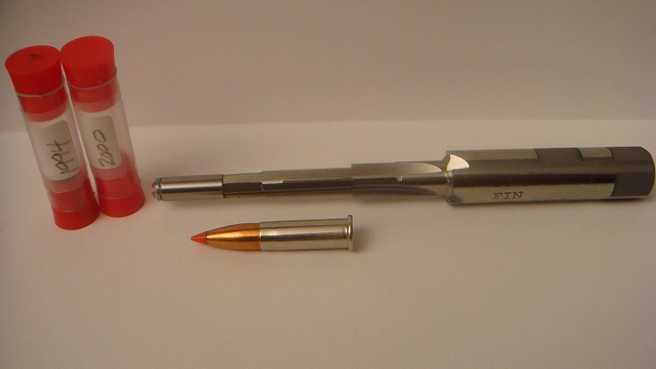

As a child my grandfather gave me a Stevens 94H, 410 shotgun and a Ruger 1022. I've bagged many squirrels, rabbit, possum, raccoon, turkeys and many wild pigs with my 22 rimfire. So I have an affection for .22 rifles. Recently I purchased a CZ 455 America .17 HMR caliber rifle with interchangeable .22 Magnum and .22 Long rifle barrels. My goal is to develop .20 caliber bullet with a .22 Long rifle CCI Stinger case. I have already developed and manufactured the .20-.22 Stinger bullet and are waiting for the .20 caliber barrel from (Green Mountain rifle barrels ) that will fit my CZ 455. I also have chamber reamers coming from Dave Kiff at( Pacific Tool and Gauge ) to do the chambering on the barrels. The bullet is 1.25 inches long so it fits perfectly in the CZ's magnum magazine. The .20 caliber bullet fits the CCI .22 Long rifle brass nickel coated case perfectly with a little bit of necking down. The .20 caliber bullet is readily available from 20 grain to 60 grains from several manufacturers. Hornady offers seven different sizes alone. The CCI Stinger bullet and a hornady 32 grain .204 Ruger bullet weighs the same and has better aerodynamic BC shape for flatter trajectories. The CCI stinger bullet is only half full of powder and has a velocity of 1640 ft./s With a little work I'm hoping that my .20-.22 Stinger can attain around 2000 ft./s. And have good knockdown power for varmint shooting up to 200 yards. I've developed my own shell holder and tooling for fixturing bullets and will be offering it to anyone who's interested. I haven't made up my mind whether or not I want to go into production of this round on a limited basis. I've talked to Green Mountain about purchasing the barrels that will fit Ruger 1022's and the CZ's rifles for you guys who want to convert over to a .20 caliber. As a new member I hope my interest will be interesting to all of you. Now if I can figure out how to do an attachment on this form I would be more than glad to send you pictures of what I'm doing?
Fred!
.20-.22LR Super Stinger
Hi All,

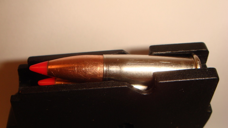

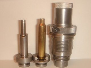

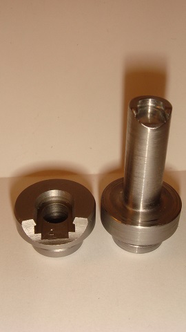

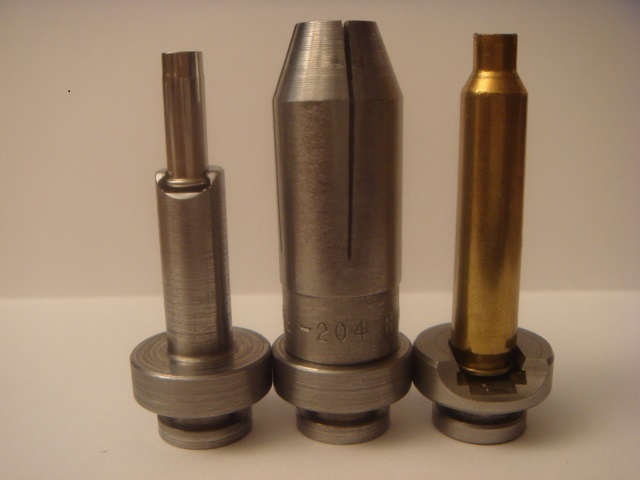

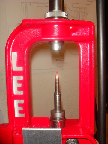

It's has taken me a couple of days to figure out your website and learn how to use micro on my camera. This camera has too many menus!!! At this time I'm using the hornady Ruger .204 Cal, 24 gr NTX and the 32 gr V-max in the CCI .22LR Stinger 1640 ft./s brass. There are several custom manufactures out there producing .20 caliber bullets. I'm trying to get in touch with George Ulrich about tooling for making my own .20 caliber bullets. For now I'm using hornady .20 cal bullets. Last summer I purchased 6000 Stinger bullets so I could do my development work this summer. The tooling I've developed has made it easy and safely to pull CCI Stinger .22LR bullets and replace them with hornady .204 bullets after necking down to size. Once my development work is done I'm hoping to find a US manufacturer or European manufacture and purchase half million primed .22LR brass cases. Or maybe even manufacture my own !!!!!!
I just completed a book called " The complete book of the .22 " (a guide to the world of the most popular guns) written by Wayne Van Zwoll. He was lucky enough to get a couple of boxes of the first .17 HMR round at the Speer/CCI manufacturing facility. He stated that the CCI .22 WMR cases had been necked down by Hornady, then charged with Hodgdon's LIL'Gun propellant and capped With Hornady .17 Vmax bullet. That is why it was one of my choices for Super Stinger and Hodgdon suggested it. As I said if you have any other ideas please let me know. ????? As I am in the midst of making bullets and Just finished my CZ 455 .20 caliber Green Mountain barrel. What I do best is designed tooling and manufacturing CNC parts. I have chosen to share information with members of the FORUM and at the same time gather information to help develop this into something that we all can benefit from. I know that chamber pressures in the .17 HMR, is 27,000 PSI range. I'm looking at a handheld acoustic high speed DB meter for measuring sound levels. The higher the pressure the higher the sound level. Since my barrel length is the same for all four barrels, 17HMR, .20-.22LR SS, .22LR and .22 WMR. I can get a baseline to measure and calibrate the sound level range. With that I can determine to pressure range! What I'm trying to accomplish in this program is come up with ideas for updating the .22LR bullet similar to what Hornady and CCI did with the hypervelocity .17 Cal. bullets. Since I know what the basic .22 caliber bullet have for powder loads I can extrapolate from that and use that as my starting point without fear of over pressure. I know this is a jacketed bullet and not just copper plated lead! I've shot Over 200 Bullets with 2.6 grain loads with out any problems. When it comes to better powder choices if any of you have any ideas I would appreciate any help in that area!!!!! When it comes to priming I do know that CCI and Hornady use the same primer and that CCI actually makes the rimfire bullets for Hornady. CCI's advantages is that they put a lot of primer in the bottom of each case not just in the rim area. I have developed tooling that makes it easy and Safely to pull CCI Stinger rimfire bullet. I have pulled apart over 2000 rounds so far and my tooling works very safely and efficiently. I'm using the powder out of these rounds in the same grain weights as the original bullets to do my initial testing. I don't know what powder CCI uses in the Stinger rounds but I'm hoping to possibly match it performance in the future. After I pull the bullet from the case using a Honady .223 collet cam lock bullet puller. I removed the powder and use a " LEE " " modified " Collet neck sizing dies to size the neck of the Stinger Brass cases to fit the .204 Bullet. I load powder then use a Lee dead length bullet seater to seat the bullet to length. The system also requires the use of my extended shell holders. This shell holder puts the necking length at the same height as the Ruger .204 brass case. Thus making Lee standard collet neck sizeing dies and dead length bullet seater dies with minor modifications cost-effective. Hornady and several other die manufactures use compression swaging dies to size their brass. This puts too much load on rimfire cases from a safety standpoint. That is why I say use collet dies only!!!!!!!!!!!!!!!!!!!!!!!!!!!!
Collet's exert very little compression loads!

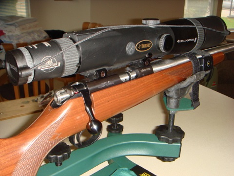

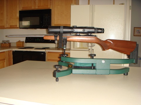

Here's a picture of my new CZ 455 America Test instrument. I could have bought two rifles for what this Burris Eliminate II laser range finder scope cost me. Now all I have to do is find me a squirrel a quarter-mile away and I can range him and eliminated. I like good test instruments.
Fred

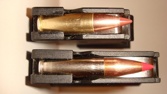

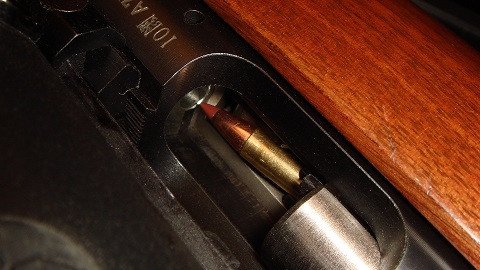

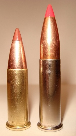

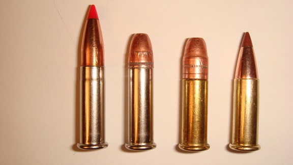

Before anyone asked. Here Are a couple of Pictures of my earlier development using the CCI .22LR Velocitor and CCI .22LR Stinger Using the CZ 455 .22LR and .22 Magnum magazine. Both Chamber very well in the CZ 455.
Fred

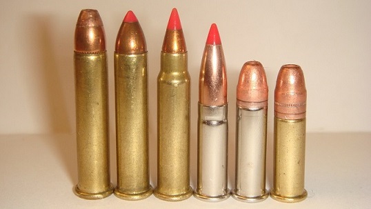

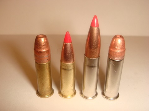

Hi all,

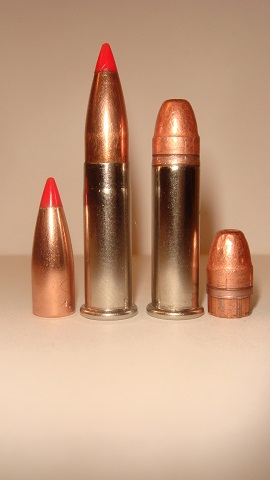

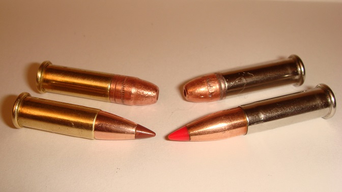

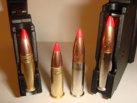

Here are a few more pictures of my .20-.22LR Super Velocitor 24 grain bullet and Super Stinger 32 grain bullet.
I also have on order a MagnetoSpeed V2 barrel mounted ballistic chronograph. Seems to be a pretty good piece of test equipment. I have 500 rounds ready for testing! Can't wait till the weather breaks.

Those little suckers look cute stuffed in the stinger case! A .20 cal in the 22 mag case or better yet wsm case would be the cats meow! If they launched a .20 cal off the 22 mag case I'll bet my first born I'd have lilja make a drop in for the CZ 455!
This really got the potential to get legs... I do hope it takes off! Would hit a lot harder then the 17! That could be a great round! Plus being able to reload no shortage of ammo like .22 please keep this moving.
