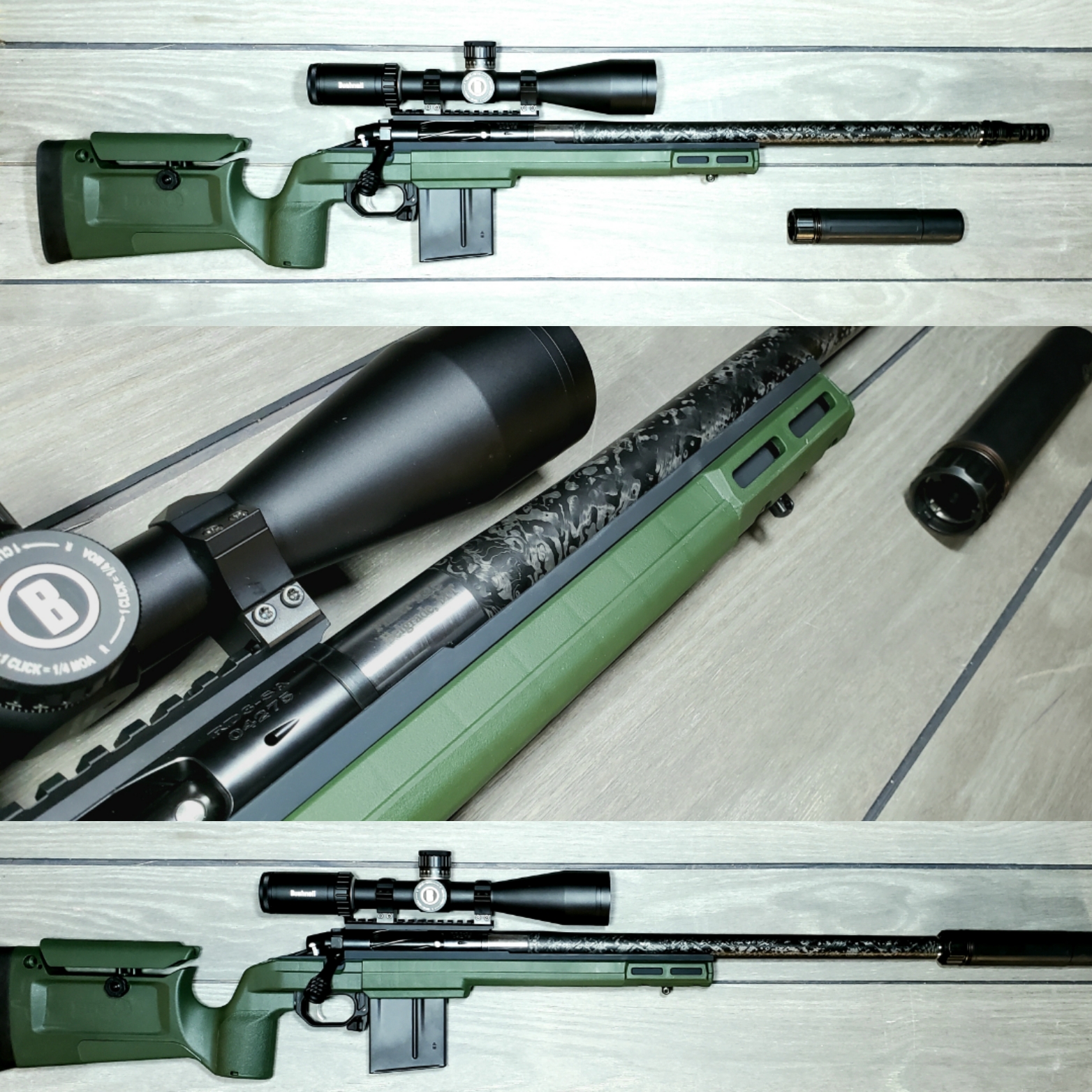

Hello everyone
I just received my 300wsm build with a 20" Proof Research 1:10 barrel. The primary use for this riffle will be whitetail and boar hunting with occasional long range range work. This riffle will be ran suppressed 100% of the time. With the twist rate and intended use, I'm thinking 180 grain Bergers would be the best bet.
Does anyone have load data for a shorter barreled 300wsm with a quicker burning powder?

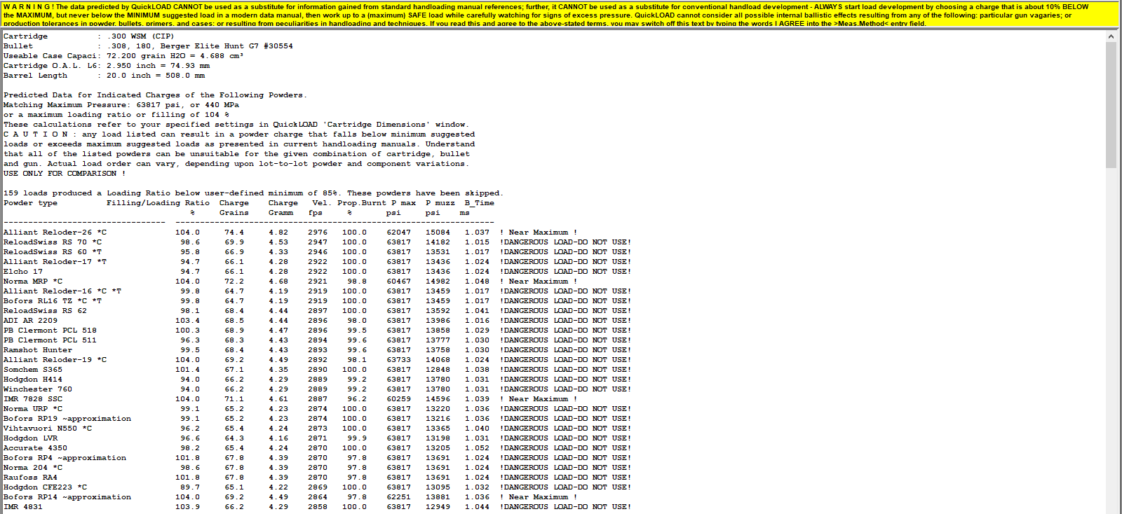

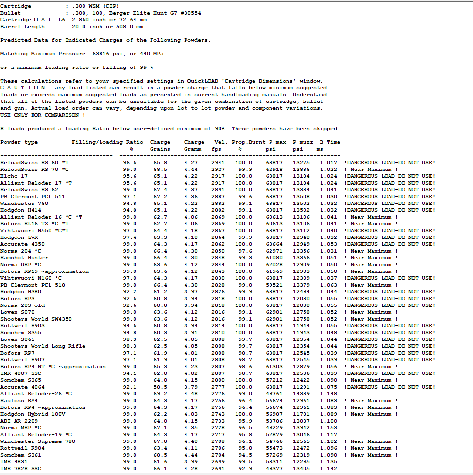

Here's some predictions from Quickload. You'll want something with decent case fill % and burnt propellant % if you want to optimize for a shorter barrel.

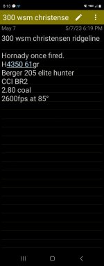

This is what I loaded in my 20" 300wsm. It was a half minute load at sea level, but I drove to Wyoming with it last month, and something strange happened. At 6,200ft, it was a 20 moa load. I haven't had time to figure out exactly what happened yet.
And it really was exactly 2,600fps. My magneetospeed average for a 10 shot string was 2,601
