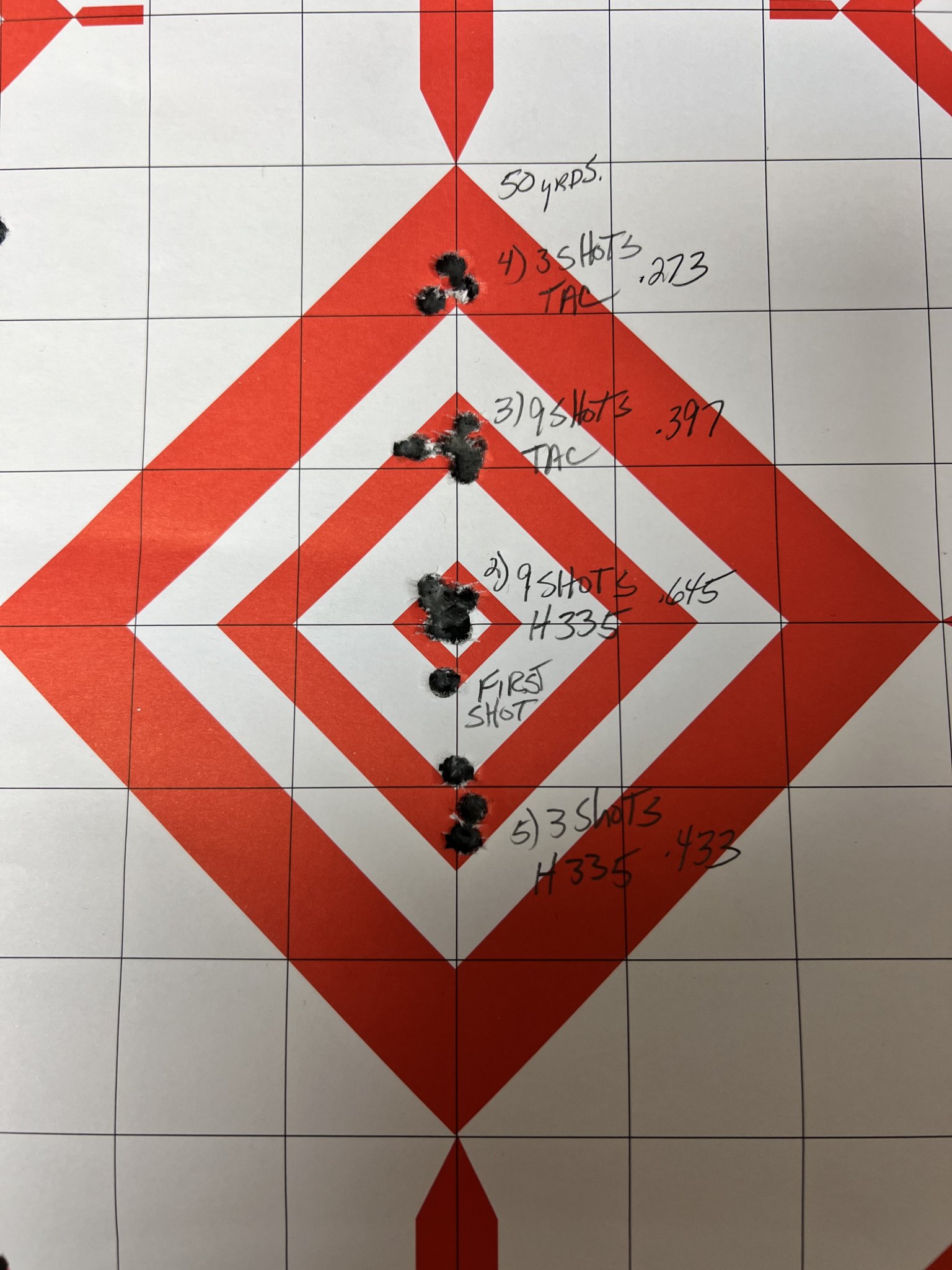

    I did a quick proof pressure test with 8208 and h4895. As to no surprise, h4895 performed admirably (29.3 grains netted an avg 3680 fps with no pressure signs and a silky extraction).
    I’ve got some Staball match and h355 loaded up. I’m willing to bet Staball match will get me close to 3700-3850 fps safely. My ladder test will start at 28.5 and end at *33 grains.
    *33 grains was just shy of the neck/shoulder junction.

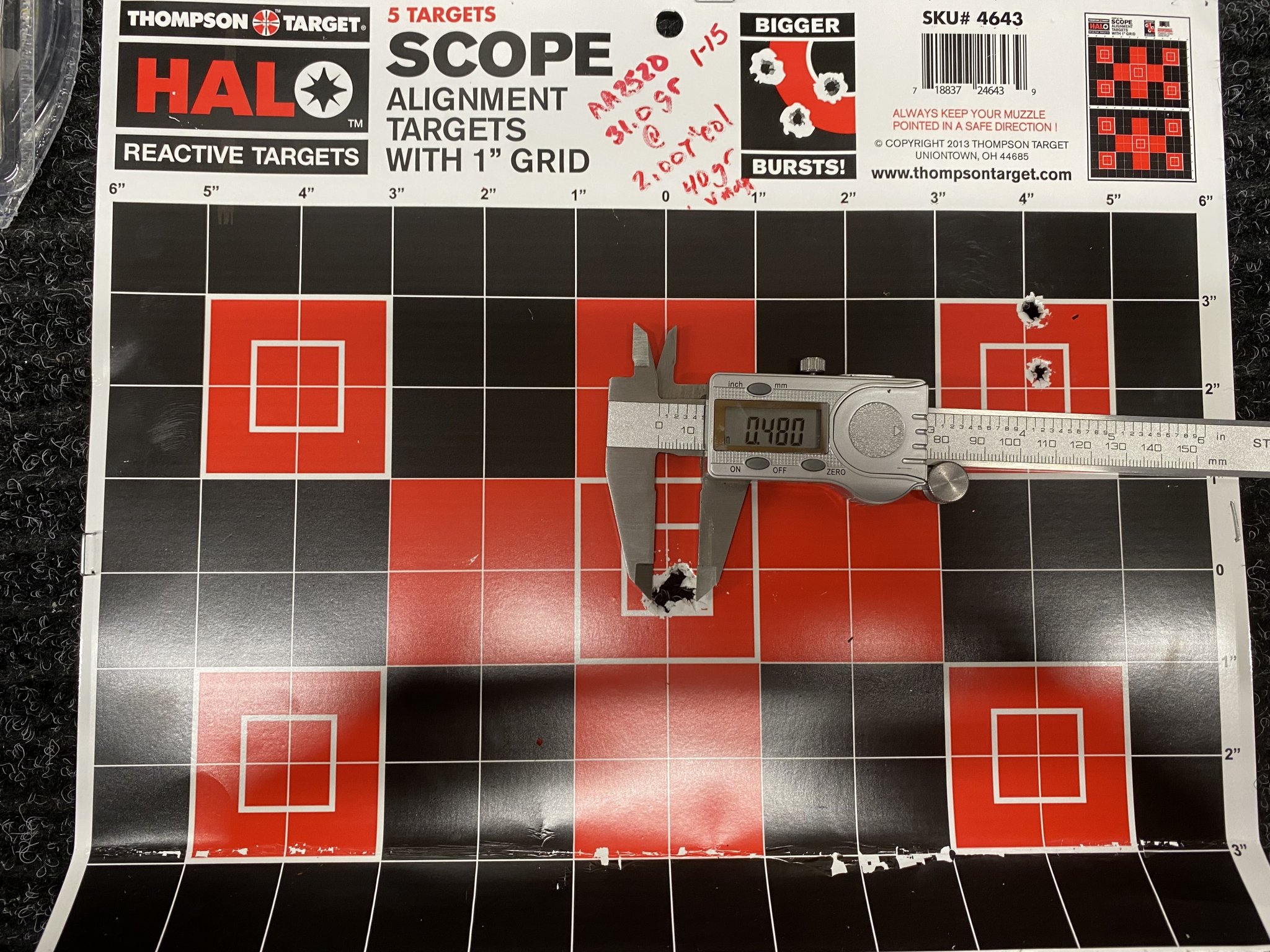

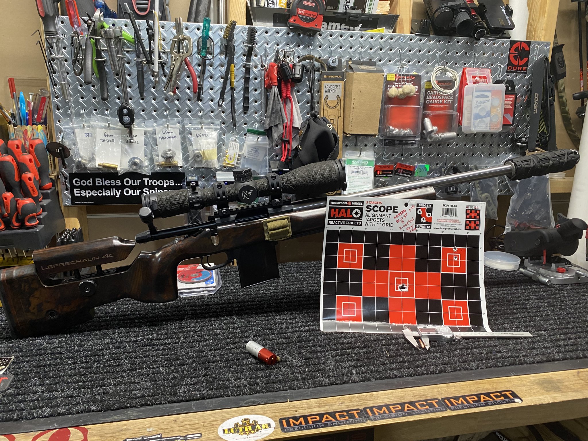

    AA2520/31.00/40 vmax/3592 fps
    No b/s, the first 15 rds down the tube (3 to zero, 12 is a knot).

    Just finished a 20 practical AR build. My first subcal. Shot it the other day at 50 yards after laser aligning the scope and for breakin purposes. So impressed with accuracy and minimal to zero recoil. First shot was low but the rest grouped very well
