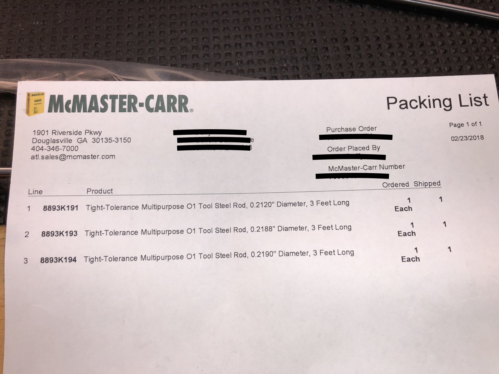

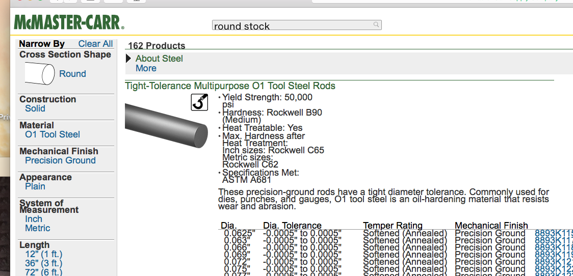

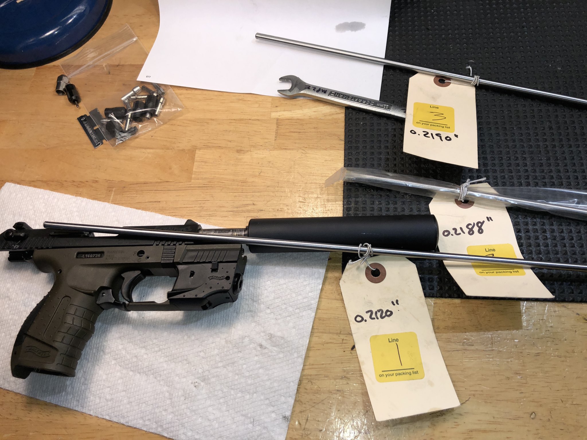

Not for use in a lathe setup, but you might consider getting these McMaster-Carr close tolerance rods in the diameter you need....I use them for suppressor alignment, less than $10 for 3 feet each. I use them for .22, .224 and 7.62; except for the their polished surface they work just as well as my Geissele alignment rods that cost $80+ bucks each.
I cut them to length and chamfer / buff polish the ends.
