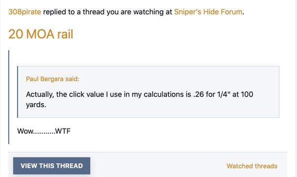

308pirate - what I see from you is profane condescension towards a guy (Paul) who asked a simple question in good faith.
Here's a pic before you edited, since you like to do the attach thing more often than not, I thought I'd respond in a similar vein.
Keep the good info coming, but try to resist the urge to play johnny wannabe on a keyboard; it reduces your credibility.
Your edit was a step in the right direction.
Get the fuck out of here with your lectures.
