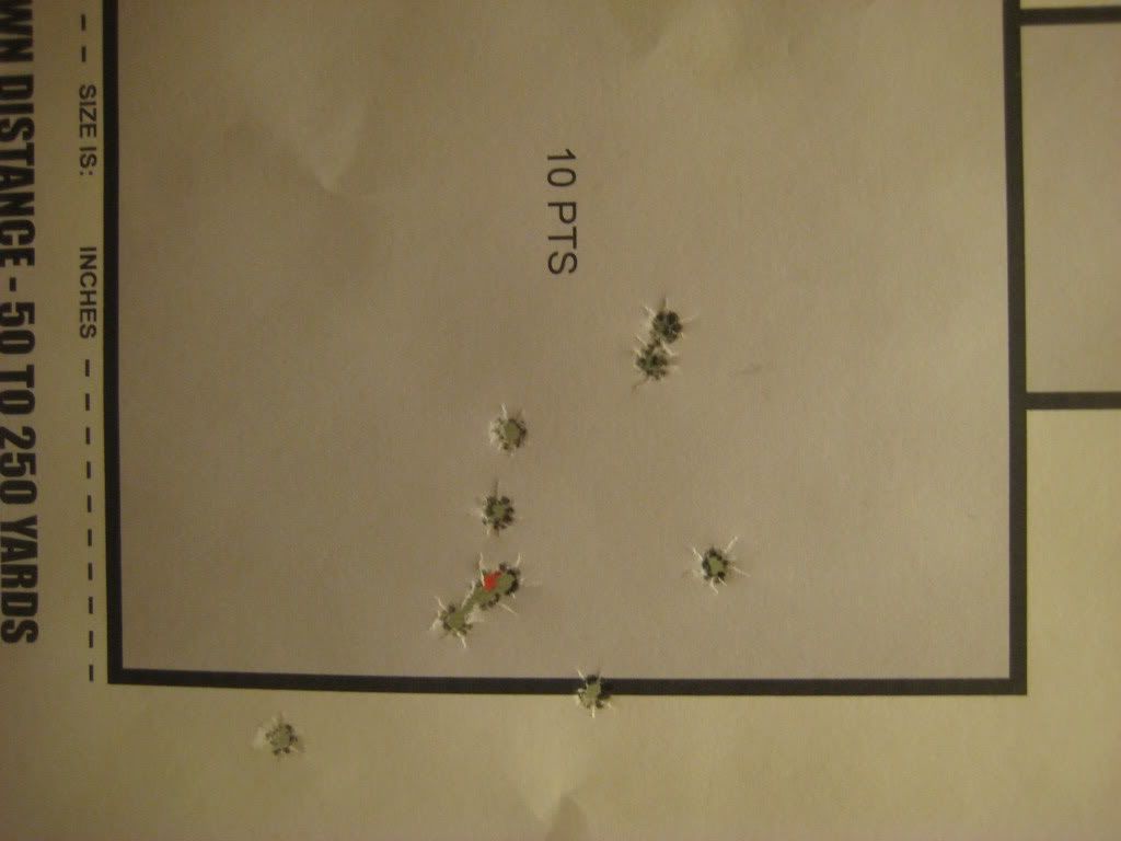

    Here's my best 200 yard group, I know, I know, it's only 3 rounds. The average group is around 2moa, some larger, some a little smaller, but 2moa is about where it's at.
    Here's about what it normally does;
    That was shot with Wolf MT. I'm wanting to get some more eley black and try it out. I think that I could get consistent 1.5moa or better at 200 with that ammo. The rifle is a Savage Mark II BV. It's wearing a boyd tacticool now, but at the time that group was shot, it was in the factory laminate stock.
    When I chrono Wolf MT from my rifle, the ES of the load is in the high 70fps range. I've done some eley and it's in the low to mid teens. I think the big drop is ES will really help the groups vertical spread.
    My hole purpose behind shooting the .22lr this far is just for fun. I have no intention of shooting game animals that far out. It's just fun to shoot, and be able to watch the bullet come down and hit the target.
    Branden

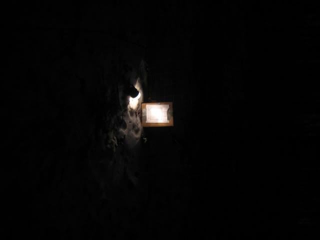

    Here's an honest 10 shot group at 200 from several years ago.
    This was shot at night with the target illuminated.
    I shot at night because there was a lot less wind(and I ran out of light).
    There is lots of operator error evident.
    Lilja barreled Rem 504 with Wolf MT.
    Here is the target, fancy setup huh?
    I posted this years ago, not sure if the thread is still alive.
