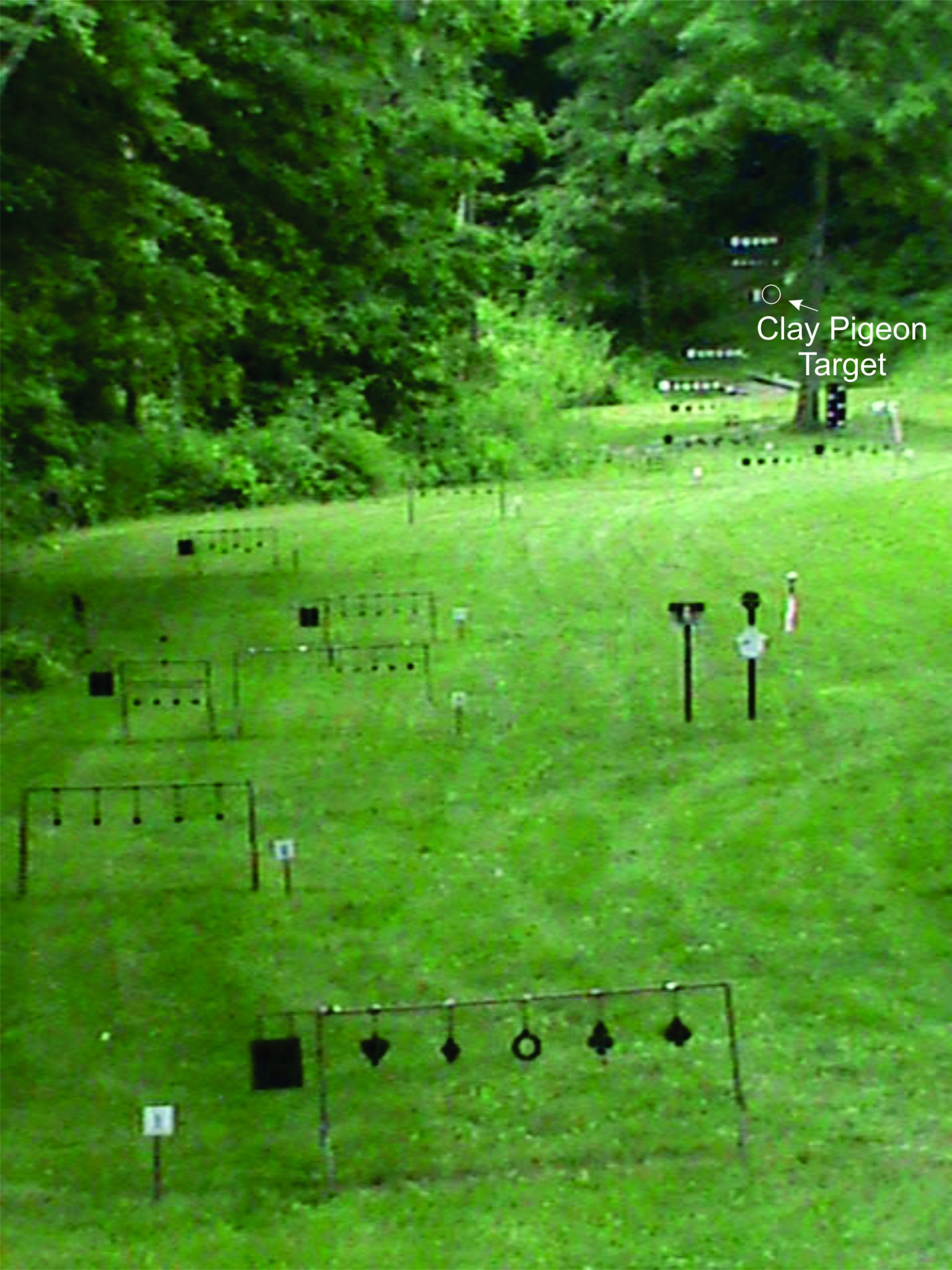

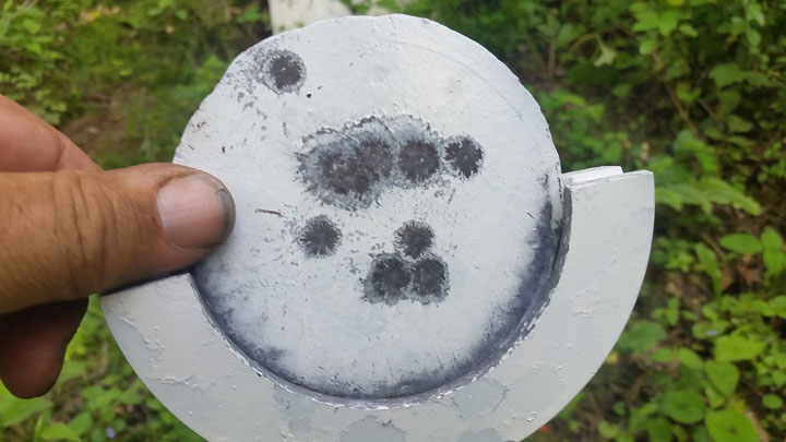

This is 10 shots on a target the exact size of a real clay pigeon at 197 yards. Shot with my infamous Ugly Beddy Winchester 52-C in a 2x4 wooden stock with a poweraide bottle for a cheek rest. Put together as an experiment but it shoots so well I've left it alone just to keep getting WTF is that looks. Still amazes me how well it shoots, makes you wonder just what makes a gun a shooter or not?
First shot high and a bit left was the first shot, next 9 were with a slight hold adjustment. I always feel if a shooter can put 10 in a nice group then the gun/shooter combo is fine and the dropped rounds are unknowns to frustrate you.
Shooting midpriced ammo I do accept the fact that I'll get 2 to 3 dropped rounds in each box of 50, that translates to 4 to 5 possible dropped shots at my 85 to 100 round match. Hope they happen on a larger target but it keeps everyone on more of an even playing field and keeps the high dollar benchrest guys at their own game where they can all be equal.

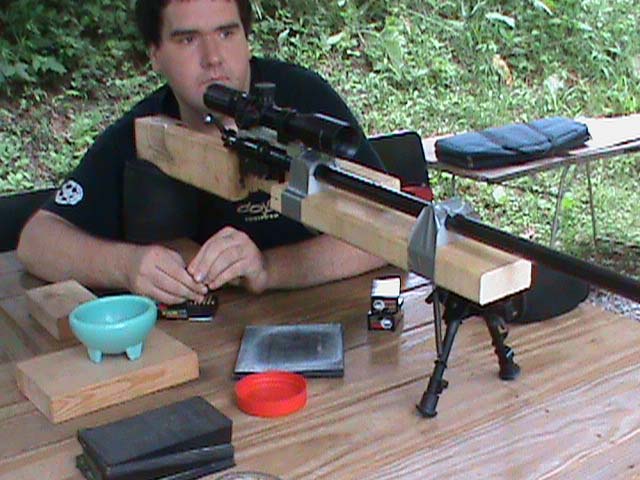

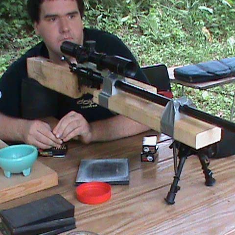

Here's the CZ 455 Son Of Fuglie with the Feddersen "Stubby" 16.5 inch 22wmr barrel locked in.
The muzzle is 1/8" clear of the fore end. Looks ridiculous but does the job.
Mueller 8-32x44 Target scope, another set trigger, Sinclair bipod and bag

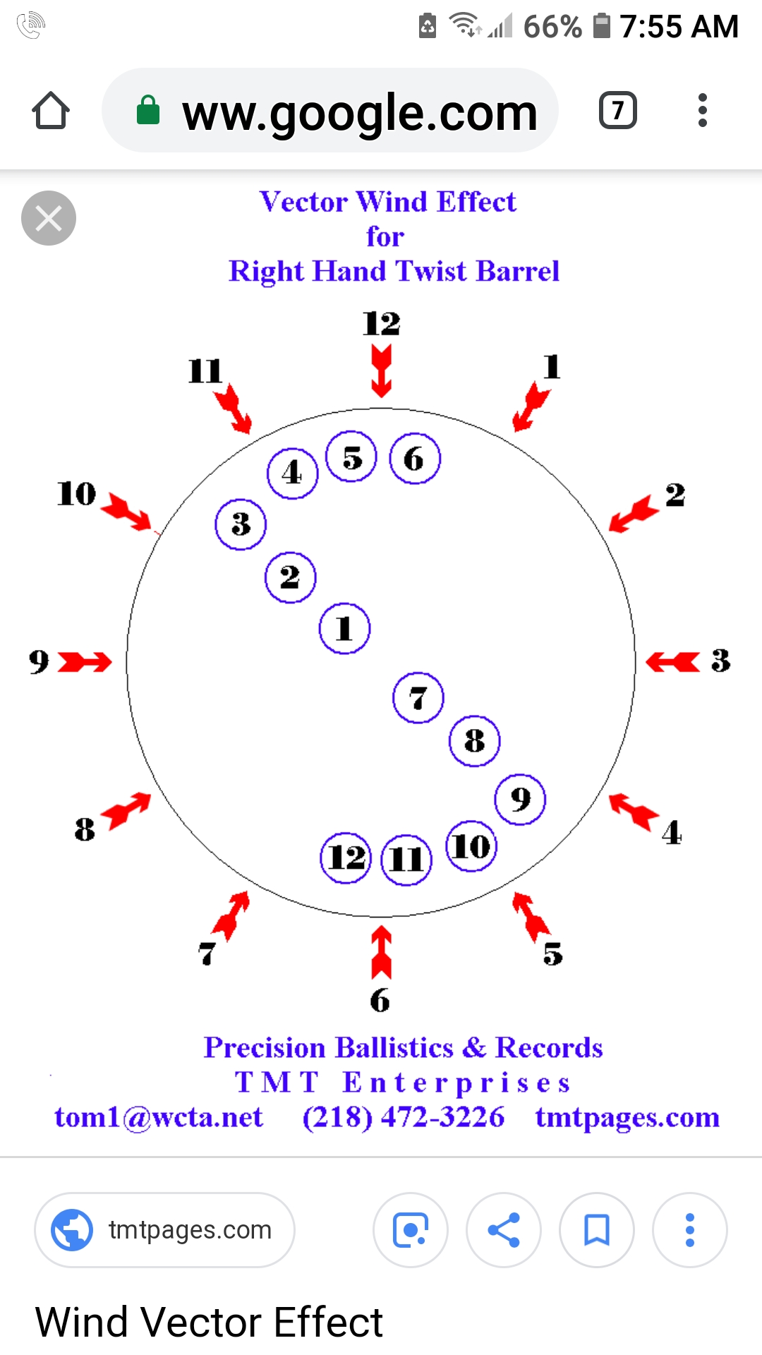

Don't forget that side to side winds also generate vertical dispersion of the shot. If wind is blowing from right to left, the shot will drift left and up and if wind is blowing from left to right the shot will drift right and down. When you get subtle head winds and tail winds those will also affect POI. These are noticeable at 50y. They can be huge at 200y. Toss in rolling vortices from the roof of the firing line and it gets really fun.

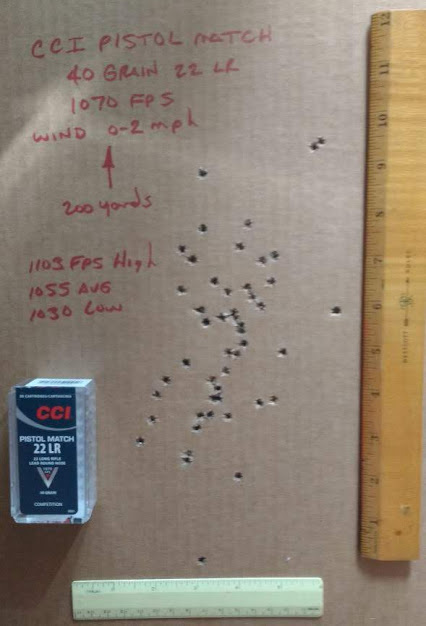

I did s series of 50 at 200 tests for various brands and flavors of ammo through my RPRR. I shot off a stout bench with a bipod and rear bag using a 16x scope.
I don't have photos because I'm not that patient. However, here is a summary of my results. The cost is in cents, wind in mph, AV in FPS and the height and width measurements are in inches. The chrono data is for the entire batch. However, I usually picked up only 43-47 of the rounds. YMMV.
50 Rounds at 200 Yards from Bench
DateAmmo BrandModelGrainsBullet MaterialBullet ProfileCost per RoundWindAve. VelocityESAve SDHeightWidth
12/19/2018CCIStandard Velocity40LeadRound Nose751033329.229.06.6
12/19/2018CCIBlazer40LeadRound Nose7512336019.7310.57.5
12/24/2018CCIAR Tactical36LeadRound Nose7011727416.706.15.7
12/28/2018SKRifle Match40LeadRound Nose1671018478.748.05.4
12/29/2018SKPistol Match40LeadRound Nose13710246010.358.66.4
12/30/2018LapuaCenter X40LeadRound Nose2281030406.757.27.7
12/31/2018LapuaPolar Biatholon40LeadRound Nose2981058618.437.05.9
1/1/2019EleyTarget40LeadRound Nose13810426312.8712.07.1
1/10/2019CCIStandard Velocity40LeadRound Nose781033329.227.88.3
1/10/2019CCIMini-Mag36CopperPlated HP78???15.515.8

This was as good as I could get from a barrel block 17wsm rig.
Savage heavy barrel bmag locked into a fuglie on a Sinclair bipod
6mIkFLAqSN8k_MAISVxqPRxHFg6YiNH4osw2TXFCURbH9An0woHq4poxr9bNxWuowUeMFj_yEn4fmi5TFQPnPAi6BjhO26kzjtweHJhpbk2QzvWlMrpNV79u0rV_z5wHhtdR5tWxxeukOUOuhiM7slX7z36Je7lENBxzXYOlsVKWb3DUcvTtfs2fX6U69ikJWKjL64odj09NinTwYO2MyJL3o9GHJXm3nNvoaVn3jzhNqA3YVJkw2CT6GzWGI_WxqpEp4WGRAIn6xgfbjqBmpdGg9CURajp2YFdA3hG4gqUMJr19Kq5N2UkILAUIPeHOxHVcWzRcm8cpR_2FrDmymGS-sp80i0-tcvHFms-QOBOfypNwk9qJjmfJSmzKR-MKTTIBB1fcTiS9_0_GdyApGcbCFIzpa_2xQUAUr89dQWpk7cqX__UaYrn7W5a1TPKZ1WUwYtH4bALF6bRAKrasVI7sKnlNYkg2QCTMglBo_Pfv6kWs3ViR6jZe-TATsV9ezCnljZIO28Cek0fY6QU9uzOriHTkRnM7wF_PLFxGKxFb0EvrMcizB-jAXKz3p1bLMdUHg7y_DP7Smc3TrNOfKSR9rnZ6xbHDbHhxXgdywsFVMqOm2KL6iNylYoneDKU=w525-h308-no
_WFoJvNlKmG2MB9c4ObI7ZywmTZBPV8glBB1LiY2jcoJbKilAEJrZvE7fXzhhnJWJlEiqEqCM4YaP8ZIh7T2ZfeyrnLDdG0DXo9ZspRUqcCw3mJMXaDdr17cTrQeNoostqL81UwPssjXAFXPlLSGxkp4Qcpjxe9Wh92D62XFv2MnAuIMnc5uYeiPgX0TyGUxg-XV1WwmVo_RUg8xpWsPSdoaaZE8texPzPo-iuY5yqHc3t_8AY7VJlHLFEjqaaTXzUaQsWtZ6nrkt4RdLdb-rIiSveN1HFCBa1ydOnxrpddVtENked-DWrCxl9UOACgWo1XsNmG1R7xlENHOUiFqM0xD0xt_eAWB4Gwd-gcnJ-w0OSrU6MeeIgF9aagafeH6m_7V-mi-IakUCiK2xJvytsuQ0Va0tqq_K3_ya7B6kP86XulyiEmxfUmWOSXNMeb-y4gunDaecG4KJLwcnd3V5V85zdlOCvm_eSE2fW2HGKl83D4p6wOcGjD_KJl0jkCaFlglIZlwZavgRTsnTHDNMvg-zrtw5wR2_TJcB650BC7Qa9hxITGot_zzzo4B9cqxoHgeJ--hJVE8CbrHXA7cC1lkF-tuBNBYHzrm9pF7U-pAeWtzVo3n9U2RRU71Npk=w467-h581-no
f0GNZO_GUnsJJJ3mCwx1c-G_IoGhG_fq7-pA16xTuAZQ0Qu5xPdjBAxAouxk2AG45C_5BN_CBEoJKoRxebaKdpqTK6fa99_pJac5ppQ-P7ty-MjcBQh8sDVlFbXXrbyQWP-XzHFoPVm82EjAasICtU3qqPgDxVljfzTRIXTWD7Wnzinv-aX756BqsU5A_y1A3UcOBA6QlScXSb52NGpnDUKrhaadtAzFb01J5LLqoLSsBXx4YboIOXkWDBWFDALfFk2qEg_-0hR6nZljNDcEN2UqRFhrviGbQG-8-2MssQf_z9Z2THlwDZEyzhhhTt0oCOuqSJY6isCnO9vRrAmNzx5yTPzlOORhwBnRTBJ_LoYlsSk-Rj8lda_xTsFtBwif8gupAXDIGWwcXj6np-v-Bga0NEtBEP4Carp23Pq3tE2zdJwwO2dKregwbiWpgsGuic_Lj2waeb043pNN3c_vM0AC9yO0D6fQk08vqlMwJPfMP2xskMsAVmHpji5k2Y05SliC7uhZYb2KLrAoxYGxasKTaU78fGPM_NRScqT536QprfNd-3O62A7grh2IV1axYKO5fZDLxpDXVODq6a_R9_n9VDZSf1hJRjMYmUarl5M8ziCpjwN-se1Rajx22YVy_36j6LSBRpGnl3eFAOCY44480wU7J7zkIuEkGeZ_f-nkF-Xaz_Ys20H8=w538-h577-no
Ugly Beddy has a cousin!!!!!!!! Yours is more refined, Beddy is from South of the tracks.
LOL, they do get the eye rolls and Snickers. Can't argue with the way they shoot though. Makes you wonder ..........
Topstrap
...wonder? Not at all. I figured out right quick how it improves results.
No wobbly round bottom stock with a skinny butt and oversized inletting
allowing the receiver and barrel to hummm anywhere they feel like.
Lock that barrel down, let the receiver float and the results aren't a surprise.
Then there's the added weight. Inertia has a quality all it's own.

CCI Select 40 grain 22lr rated 1200 fps
CZ 455 Varmint, Lilja barrel, Sinclair bipod
9iRlGPmIM4H-hj9xxobSBbVe0S6ri_QtnCm_JszkIXlPop6ySI__Ta2g3AWCXGC6MnMQ50e9bRG8E5_hxFuccvtVjicbje1WAxV38_d9YsVdCwnkWCyYKQ76hkwXGTkgV5huW94Ze3VHCq1xAotuCFiznRohIIQLM__P9h-hcsATO_sdEPiPCfhGEaCBWBuBQsRgLr0jzk_leR0MfIgiiNqDWLlQAC0nedN7eUialAovuVIlSZ9K8cRFSomD19aKDVB9uQa9Mz3T5WzRNcOMh14z-VH6-VO2XMz6F-_9g05x8lqIp4Ez2Himh6uqjfmtSO7bCbhz-5uLBDp7oLiMTO6PlTfhGhtA5e6nbloMJ_LH5YlXddw62sfjqDuGcviJGx2iJ2IXpwWCKdou70VzgpDdkOzdVTFb8pEAbIZIumLQ8SpwCEuDkJGx-LQD08AIZcV8KvWcG2jYs6LolTCsTlCdIH4vvqdqM2i_m1SkA8v0JXLkoFEQfu3kzHEqwE_CPXIW8OToLcfw6cW4HfDGgF59e8CjVGRdO-Z5CM8DTOKILVmhMKaeknEgwKofQNBthR2gZvxvYLIpw5EGHyEXCrG8FQpVJPfg3Y4eSYby7RF8Cpc6bxlEB9V56i2je5MLZOFiyr9jY7dULt70yR6M7dkfQdqkPFTiO94SpUwv9KGESQ5CJ_7JPwfNM6FAqHEVQiqNDDVCis92yimrvMVBFAai=w403-h546-no
CCI Pistol Match 40 grain 22lr rated 1070 fps
CZ 455 Varmint, Lilja, Sinclair
7039940
Hmmmmm....interesting....same bullet, same brass, same lube all from CCI.
Yet the supersonic rated cartridge did better from the same rifle.
Where's that much blamed supersonic transition I read about?
I'm thinking someone needs to do some serious research on the effects of the transition
on short stubby round nosed projectiles. No yaw, no pitch, no tumbling there.
It most definitely doesn't show what the SMK BTHP did in the much referred to study.
I don't think that when people talk about the effect of the transition that they're suggesting any kind of yaw, pitch or tumbling is imparted onto the bullet. I've always understood it to mean that the transition simply imparts a random deflection of the bullet due to a sudden change in the pressure wave . . .??? You'd think that with the technology we have today, this was be easy enough to find out . . . if one has or can afford the right equipment.
Looking at the two dispersion patters, it's kind of what I would expect as the horizontal dispersion for the Select cartridges is substantially more than the Pistol Match cartridges. And the vertical dispersion for Select seems normal to me for a bullet traveling that distance with more velocity. So . . . how would one explain the wider dispersion of the higher velocity bullets?
I guess one would select the type of cartridge depending on which type of target one is aiming at to take advantage of the particular dispersion pattern???
I see 6 inches by 7 inches on the Select,
and 6 inches by 10 inches on the Pistol Match.
Comparing MV spread and wind effects
I'd say the hi v did better.
Cartridge defects and wind effects
are a better explanation for pattern dispersion than transition.
Both show visibly asymmetric bullets,
canted bullets, irregular brass dimensions
along with varying seating depths.
The transition is not causing as much of a deflection as many claim.
Not with a stubby round nose bullet.
I've produced other 50 shot patterns
that don't support the transition claims.
Here's a chart that has been around a long time that shows what you just said.
