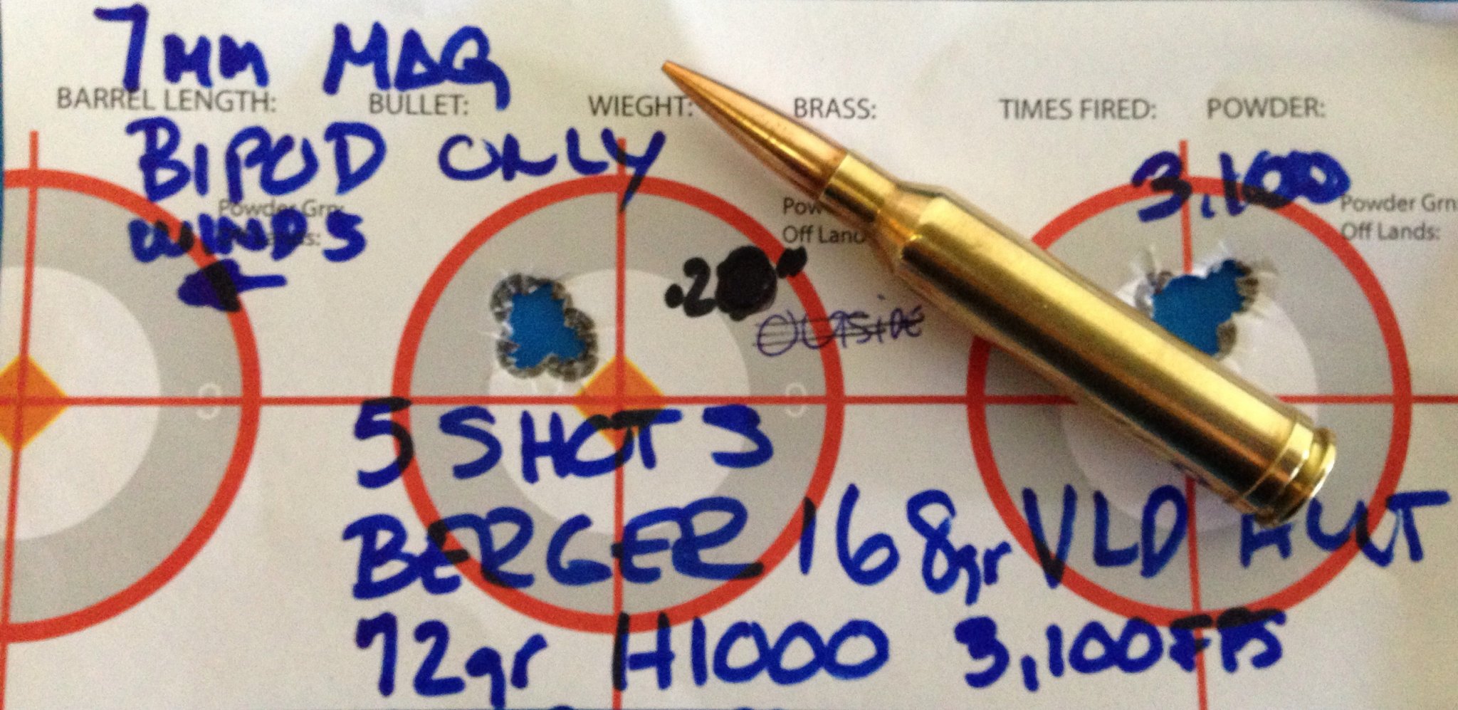

Edited to add: That the MYTH of the 338LM shoots bad groups at 100 yards, but a 1/2 minute or whatever at a mile, is propagated by people who can't shoot. Many have never even shot past 100 but brag like hell at the public ranges about what they are going to do with their 338. I have shoot at lot of extended range targets with clover-leafing @ 100 338s.... I promise it only gets harder.. Harder to bisect the target, harder to see the target clearly, harder to even know where the target really is.. much less FPS spreads and wind..
The 338LM is one of the easiest cartridges along with the 308 to get to shoot tiny groups. I don't know why, but it just seems that way I was at Marc's shop (Spartan Rifles) and he was saying the very same thing.
My Avatar is a group from my 338 - yes it might be one of the best groups I've shot.. but many will at least clover.. sometimes like with a Vudoo 22 at 25 yards - it looks like only one bullet left the gun..
The 338 also pushes more than a snappy 8lbs 300wm in a plastic stock and MUCH easier to shoot.
Awesome group! You're making me NEED to get out and shoot mine until it looks like that...
Ya, well I have plenty of bad groups too.. Really I'd be so happy if I could shoot .3-.4 and under, with every first round out to 1000 regardless of time or wind... Actually, so would anyone whoever competed.. because they'd walk away at the top at every match
I've had instances, when testing my loads at 100 yds, that when I though I had my OCW or COL determined (when I have have numerous groups at 100 yds that are performing the same), but at 200 yds they show much clearer which is more optimal.
I don't know how other people do it. In my world, one small group is an accident. Group aggregates reveal the capability of my system. I find the most capable system then take it for a walk. In field conditions I cannot even approach my benchrest or prone aggs. But, when I know the system can do it then I know where the problem is. Most guns shoot better than most people and that is why I shoot drills - improve the shooter.

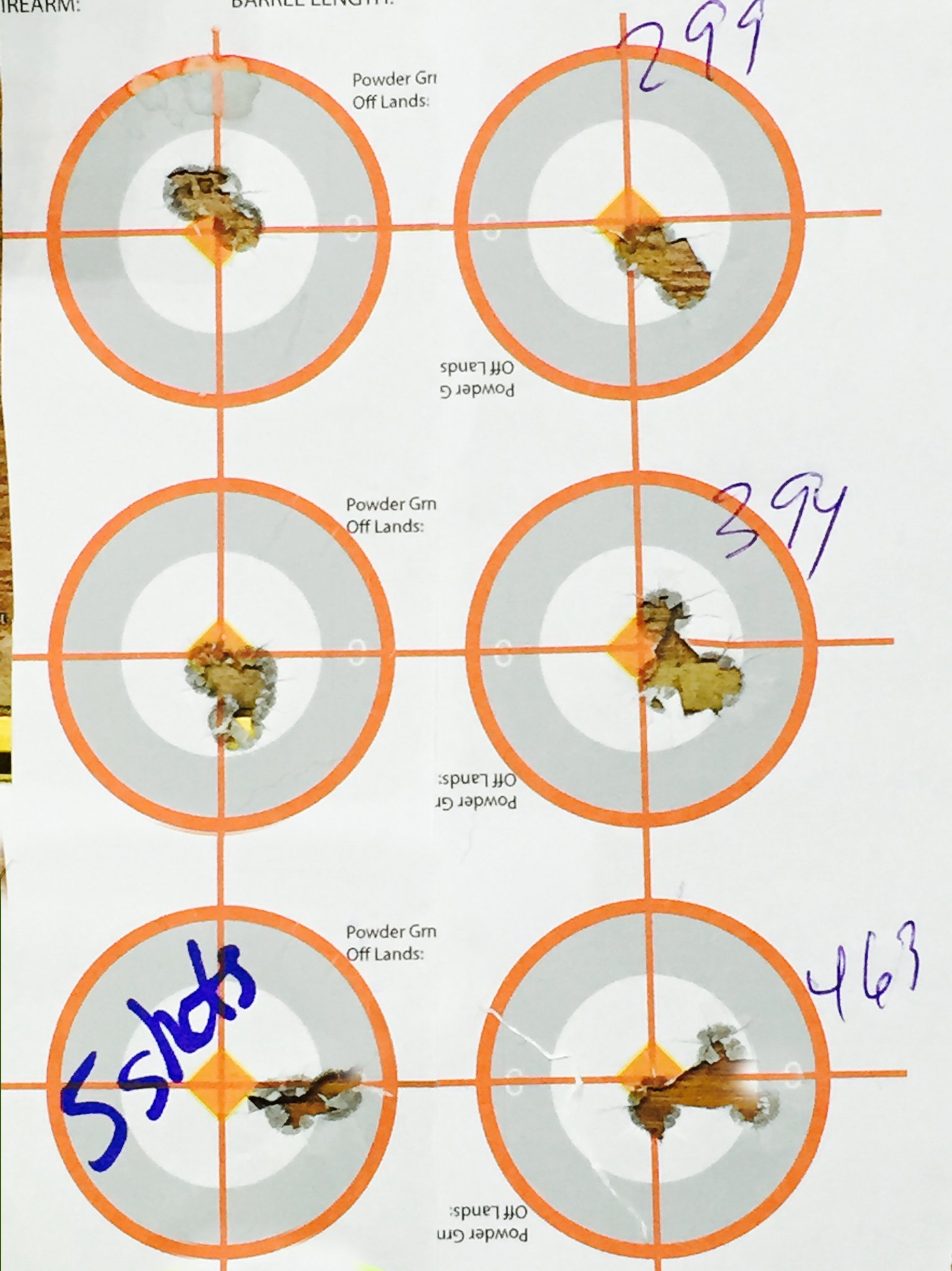

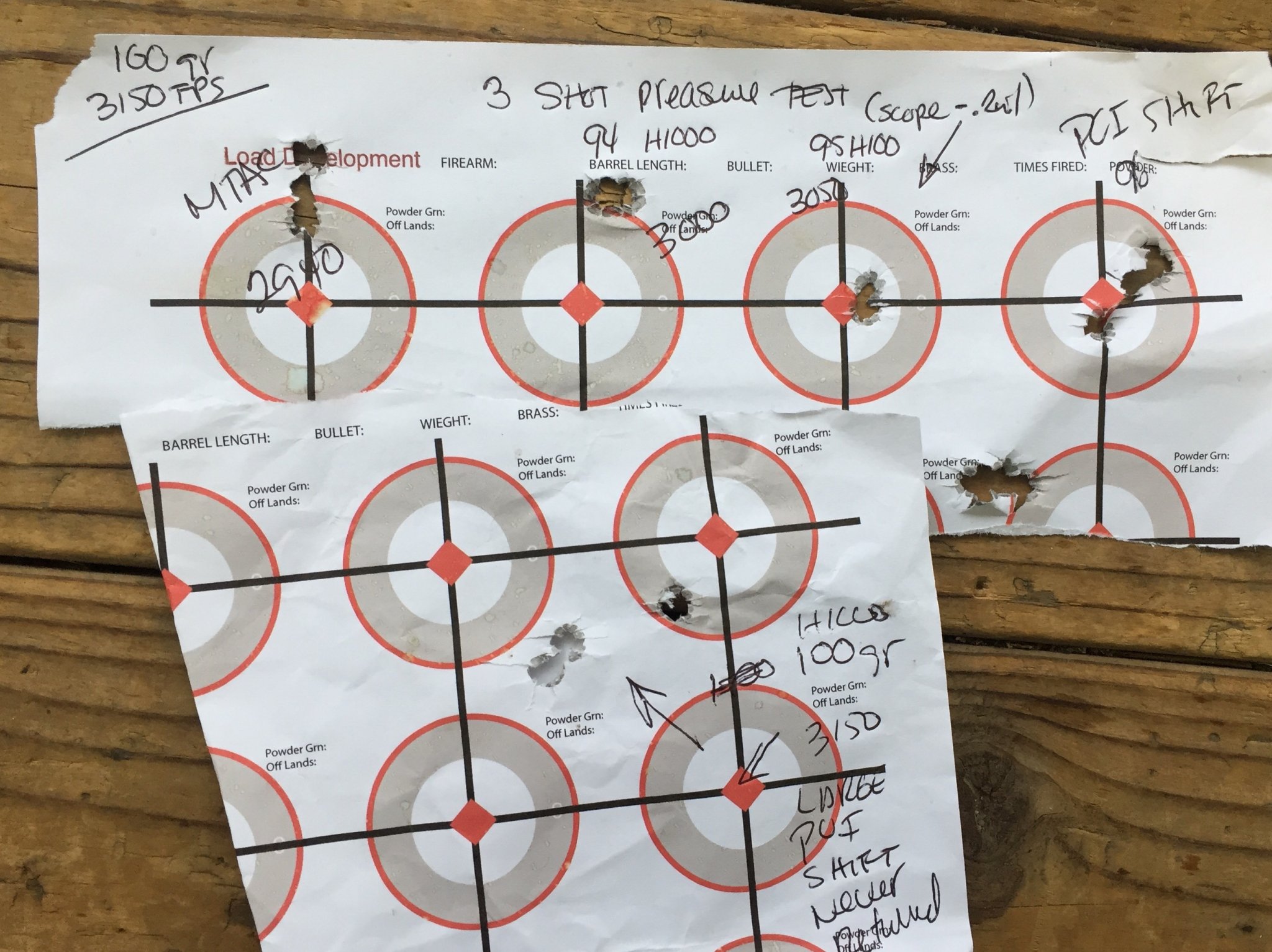

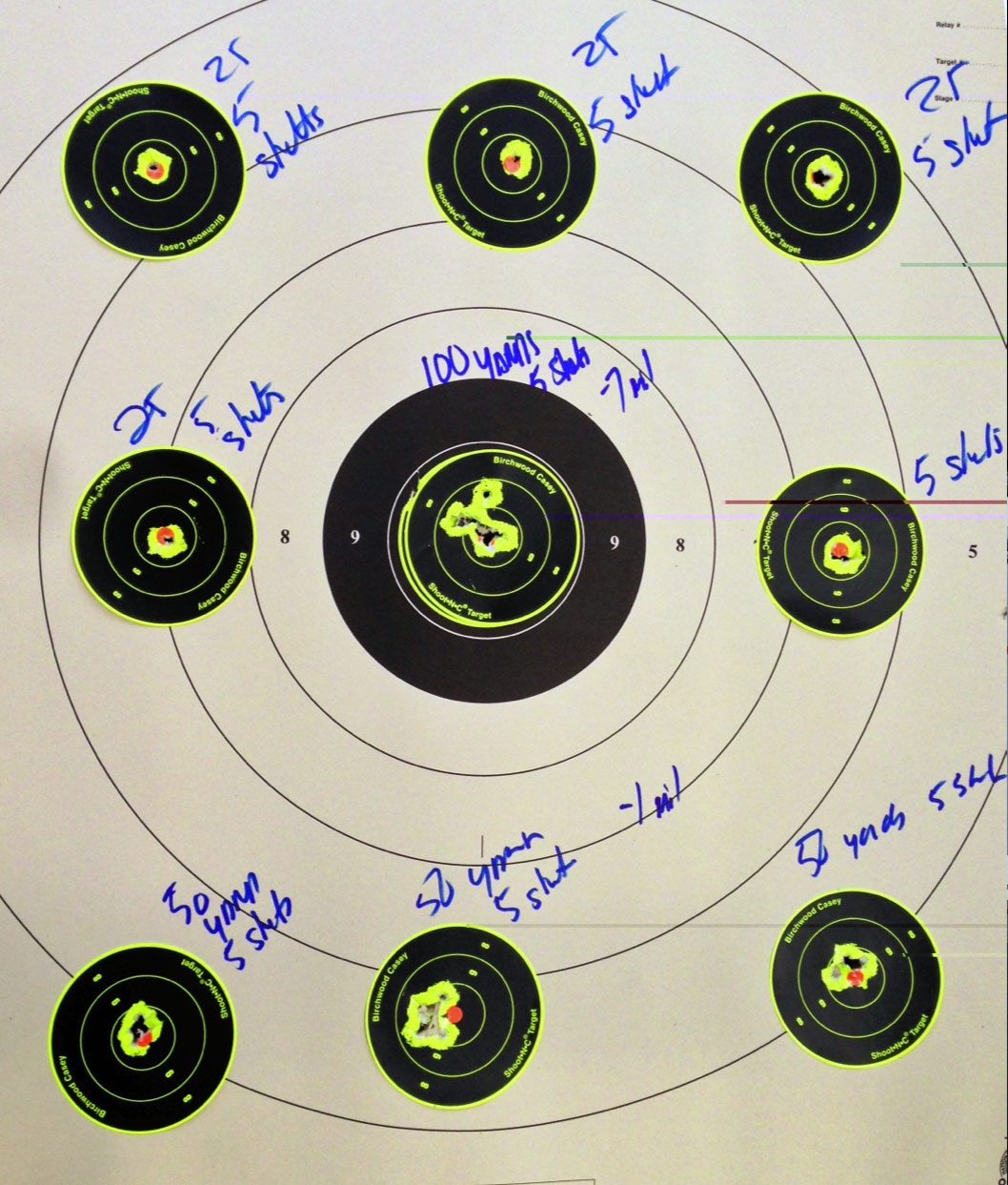

Here are some of the load work ups — I might as well post 3 different calibers — But like I said, and I think you’re saying, once the distance extends, it’s a whole different ball game. Last match I was shooting almost clean, then shot a 1 on a stage, then a 2. No idea what happened- Finished by missing a 2o”+ gong 2x at only 600 yards! The wind was not even that bad.. In the last three stages I went from being near the top to off the rails..
Load work up ladders on the 338 MTAC - image quoted was from the Amax final load. Below shows a couple of really bad nodes - I settled on 94.5 between the 2nd and third group — it had the same poi - I adjusted the scope. By 96 grains it looked like 93 again but I firmly entered the scatter node and by 100 grains, while super fast, it shot like crap.
30 cal ladders
7mag final seating test

25-50-100
All bipods and read bag..
So yeah I cherry pick, but in general the guns need to shoot. I’m sure I have a bunch more photos just as had these on my phone for load records. I usually take a picture when I’m working with different loads or a new barrel.
