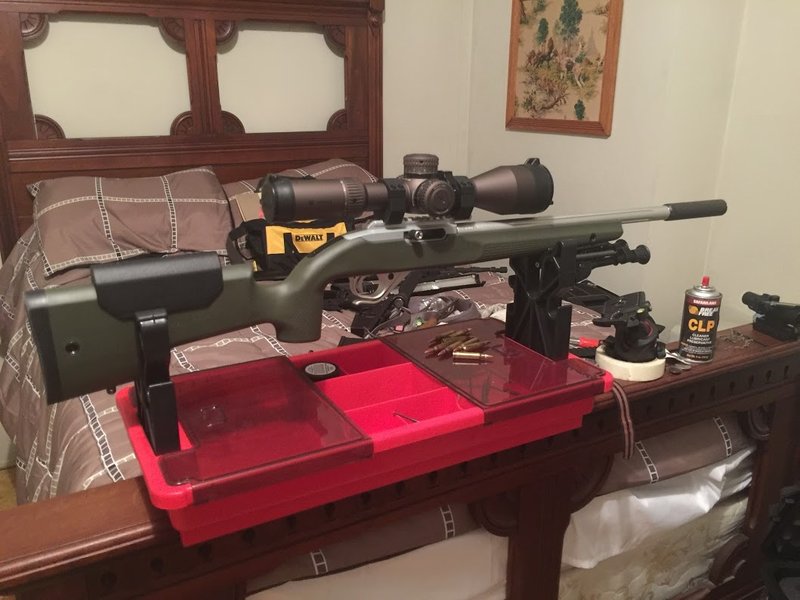

10/22 in factory laminate stock
Tacsol X-ring barrel
Caldwell Bipod
Burris Veracity 5-25
Shoots well with Geco Semi-Auto. Tests forthcoming with Wolf Match, Wolf Match Extra, Center-X, CCI Standard, R50, and Geco Match.

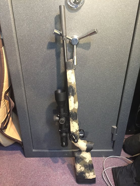

I'm a rimfire junkie, but when things are 200 and out these three work better than anything else I have.
[IMG2=JSON]{"data-align":"none","data-size":"full","src":"http:\/\/i.imgur.com\/vzBtzmN.jpg"}[/IMG2]
Top to bottom:
CZ455 22LR
Cerakote Shadow Hunter, and put together by Accurate Ordnance
Pillar bedded
Timney
DIP Rail
Lila
Small Badger knob
Badger MUNS
AAC Element
Bushy Elite 3-12x44
Walther KKM 22LR
CZ455 17HMR
McRees Chassis
Cerakote Spider Monkey green, and put together by Accurate Ordnance
Timney
DIP Rail
Lila
Custom bolt knob
AAC Element
NF SHV 4-14 MOA Aadmount covers

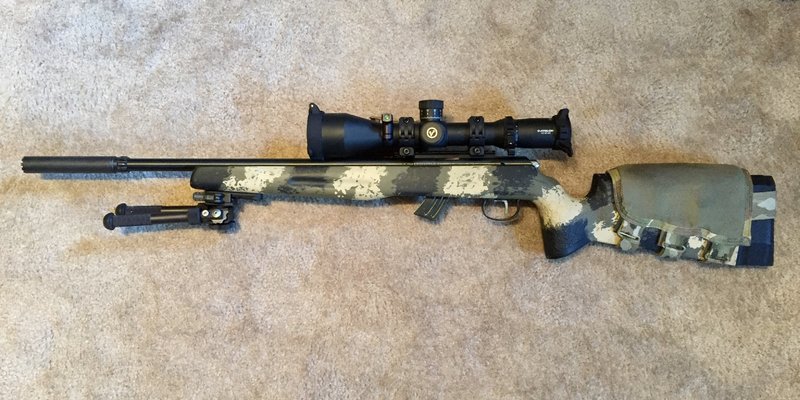

I'm sholoting a CZ455, in a boyds tacticool pillared and bedded with the m5 trigger guard.
Factory barrel cut back and threaded for a surefire can.
It really likes Norma Match and Lapua center x. Both of these loads shoot well under .5 at 50yds and dope up well to 294yds (furthest I've gone so far)
Optics setup is DIP 25moa rail, Warne permanent rings and a Vortex 5-15x Viper HS.

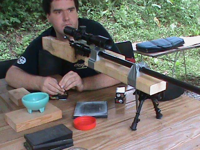

Believe it or not even this old Winchester 52-C with a thrown together 2x4 stock will shoot with the best guns that show up at my matches. The 22 rimfires are a finicky gun to shoot and are very critical on subtle changes to the way you have them setting/supporting and the pressures you as a shooter apply to them shot to shot. There is a lot to be said for the old saying "It's not the arrow it's the Indian". Being a good CF shooter does not necessary say you'll be a good rimfire shooter, the subtle changes in the weather, light, wind affect it much more. But, being a good rimfire shooter can help you become a good CF shooter.
Good luck in your quest.

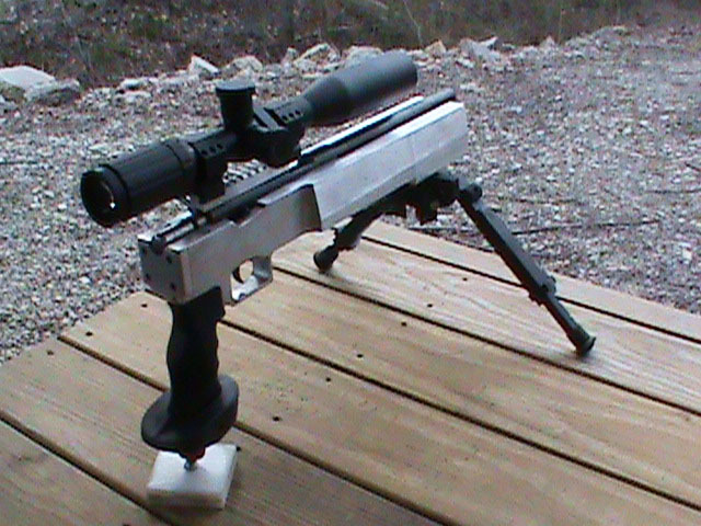

Topstrap

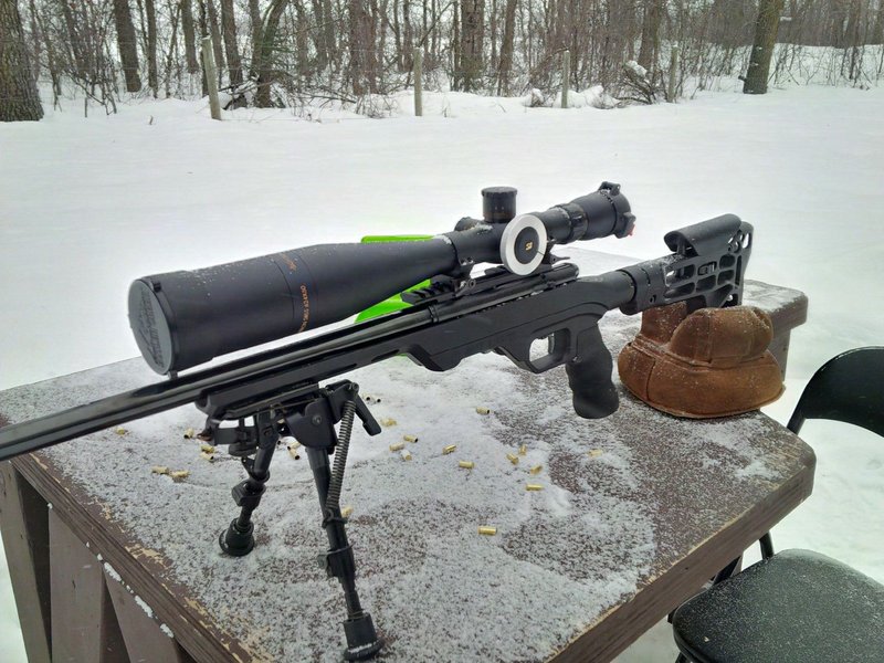

My go to for long range rimfire is my 1712 in a MDT chassis with a Sightron SIII 6-24 on top. I've shot out to 400 yards so far and it's surprisingly accurate.
