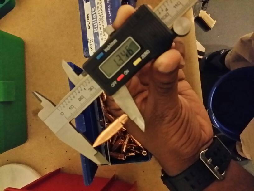

Does anyone have the bullet length of the 200gr Lapua Subsonic projectile? I am just curious, I am getting ready to work up some subsonic loads for my rifle but I am running the fps through the JBM stability calculator before I load a bunch and can't seem to find the projectile length anywhere. Thanks in advance for your help, I did use the search function on here and googled the info and SnipersHide with no avail!
-E4B
3 bullets
1.341
1.345
1.346
1.344 AVG
