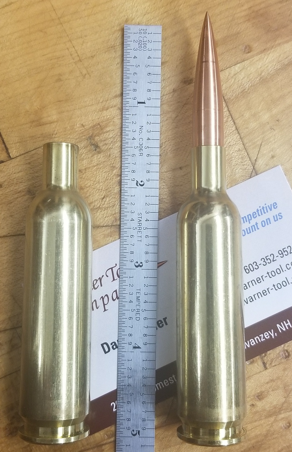

What would you like to know? Building 5 of them right now among other chamberings for customers.
Working out the last set ups and inspections on an incremental, positive stop elevating scope rail system also.
Pinned locations @ "0", 30, 60 90, and 120 minutes. Topped with a 20 minute rail. True angular positions are reporting @
+ - 6 seconds and max deviation is 13 seconds. Only one position has that much.

ELR:
50 BMG, using RWS, 235g H2O, RWS primer, 3500 w/361, 3350 w/400 We have two new powders made specifically for this. Yet to test. Hoping for
more velocity at reasonable pressures. Loads above are topped out w/ only 95% load density. H50 BMG, 35" bbl.
Have not released the reamer print.
Brass takes 13 steps, internal expanding, anneal, closing down and neck turn. Expensive, lot of work.
Radial shoulder, brass oal is 3.310 (chamber is 3.320) I'm running .019 neck walls.
Dies are made to order --50 cal size, 1.5/12
Chambering is all done here for now. 4 to 8 weeks when barrels are on hand.
Alan

Here is a quick shot of the 375WTC. Left is a fired piece of brass and right is with a 400g Flatline seated deep (for the 361g chamber).
