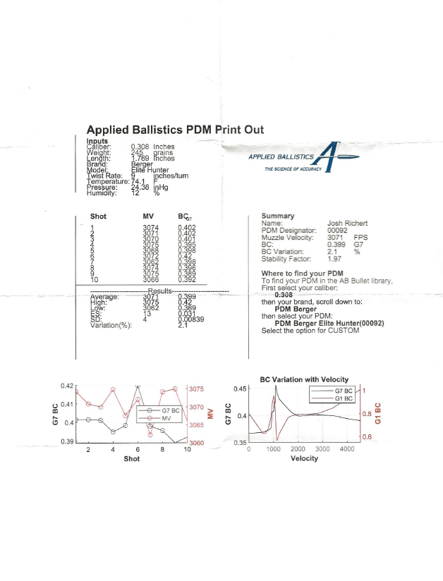

2% variation?!
I know, huge. Bryan Litz told us we wanted less than 2% variation, or less than 1% with solid bullets. The other shooter in our group was shooting the same 245 gn EOL's and was at 1.9%. My 195 EOL's were 1.9%.
One thing about the way the lab is set up- you fire 10 consecutive shots, in really quick manner. As long as it takes the lab to track the bullet for 6-7K yards & reset. It's probably a little faster than the course of fire on each stage, but not by a ton but you do shoot more shots. So I was wondering how that might play a part in the results.
If you look at the G7 BC by shot number graph, shots 1-5 are really close. 6 is pretty wonky, 7 & 8 are really close again. If you were to toss out shot 6, the BC variation is probably really low. 9 & 10 start to fall off but could be included.

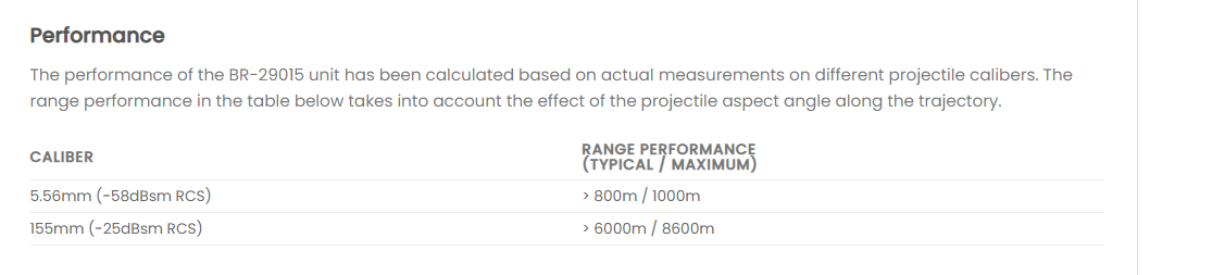

Hi
6-7 thousand yards is what they are measuring?
The best infinition radar system is barely capable 1k.
Good job on that velocity spread.
Did you use the bullets as they came out of the box? Any culling, sorting, pointing, trimming,....
That 2% variation on the print out is the BC SD and not the ES. Back of the napkin, kinda, sorta, 1% BC variation has more or less the same impact on vertical spread at 2000 yards as 10 fps variation in velocity.
I was going to ask about shot #6.. looks like it's just an 'outlier'.
or you tossed in a different bullet ;)
Thank you!
We ran them straight out of the box.
I agree. It does not fit the rest of the data at all. Especially given the velocity is right in line with the rest. But to each his own.
Hi
If you look at the picture of the AB Computer Monitor from the article, you will see the velocity plotted against time. The time series appears to be from 0.0 to about 1.9 seconds. That would give the range at somewhere in the 1200 to 1300 yd for a capable bullets pushed at 3000ish MV.
I'm not entirely sure that is the range its capable of measuring, but you are correct that 6 to 7k isn't likely.

Hi,
Yea, with a larger 30cal - 338cal that Infinition system "MIGHT" log 1300yd accurately.....
To do the 6-7k you will need something similar to this....Specifically the Weibel MFTR-2100/36-80
