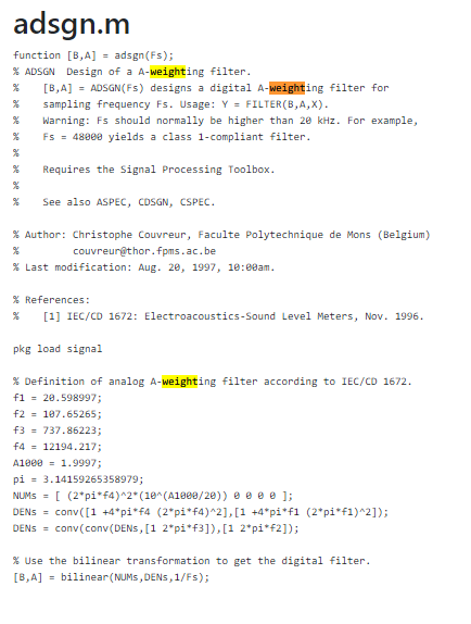

What’s the difference between dB and dBa ratings? They don’t seem to be in direct proportion to each other.
"d. dB vs dBA – In this document, dB is used to refer to unweighted dB. dBA is used to refer to A-weighted dB."
I was struggling to find what the A-weighted actually is too.
This is at the bottom
but its nerd speak for something I dont understand.
Neither dB nor dBA is going to accurately represent the perception of loudness or the hearing risk potential of impulse noise.
