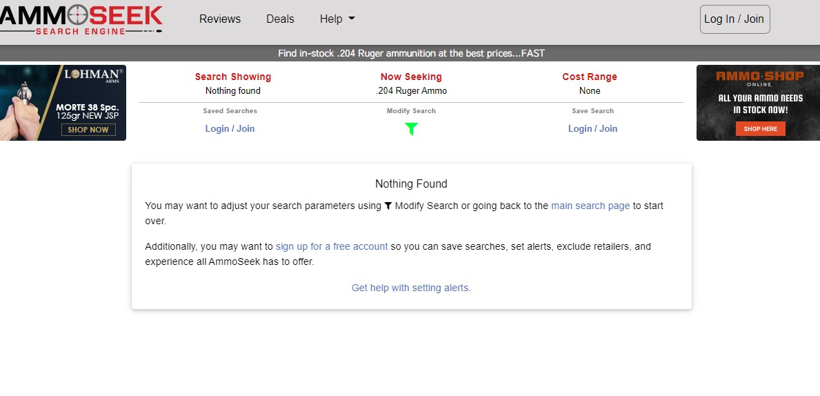

Have you priced Ammo? I looked a few weeks ago online and couldn’t find anything.
yeesh.

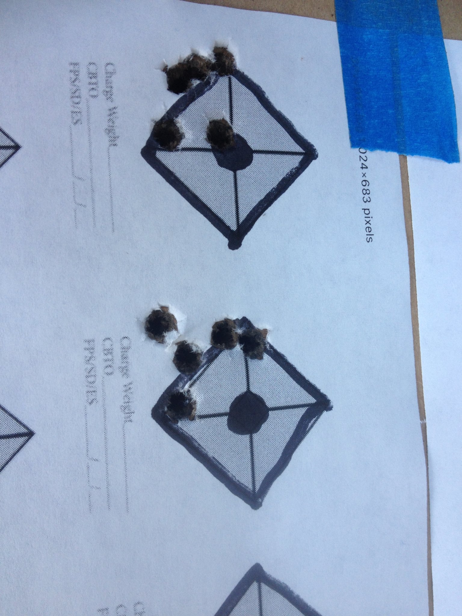

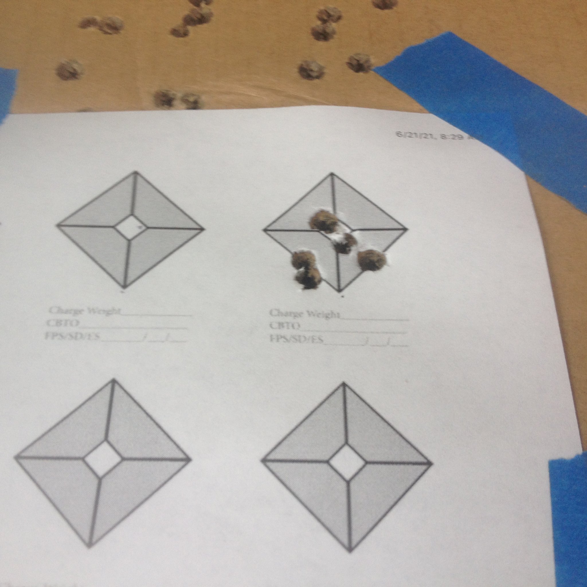

I have been whacking a lot of them over the last year with my 20 Practical. I was shooting 32g Noslers at 3700 I added another grain of WC844 and got them going 3900fps, 18" barrel. I could not tell a difference between the loads really, neither on target or on animals. I think I am pushing my luck using the 27.5 charge and plan on going back to the 26.5 charge. Its a pretty fun to shoot, about all you can feel is the bolt running when you pull the trigger. Mine is not very heavy either, .750 most of the way to the barrel extension.
The first one with all the misses is the newer load before rezero. All the misses are left and not high, the picture is not oriented. The second one was 26.5 a couple weeks prior after the first couple hundred rounds to see if the zero was still the same. I like, but i am not sure what the practical advantages are over just shooting lighter bullets in a 223. For me it was 32g noslers for like 6 bucks per 100.

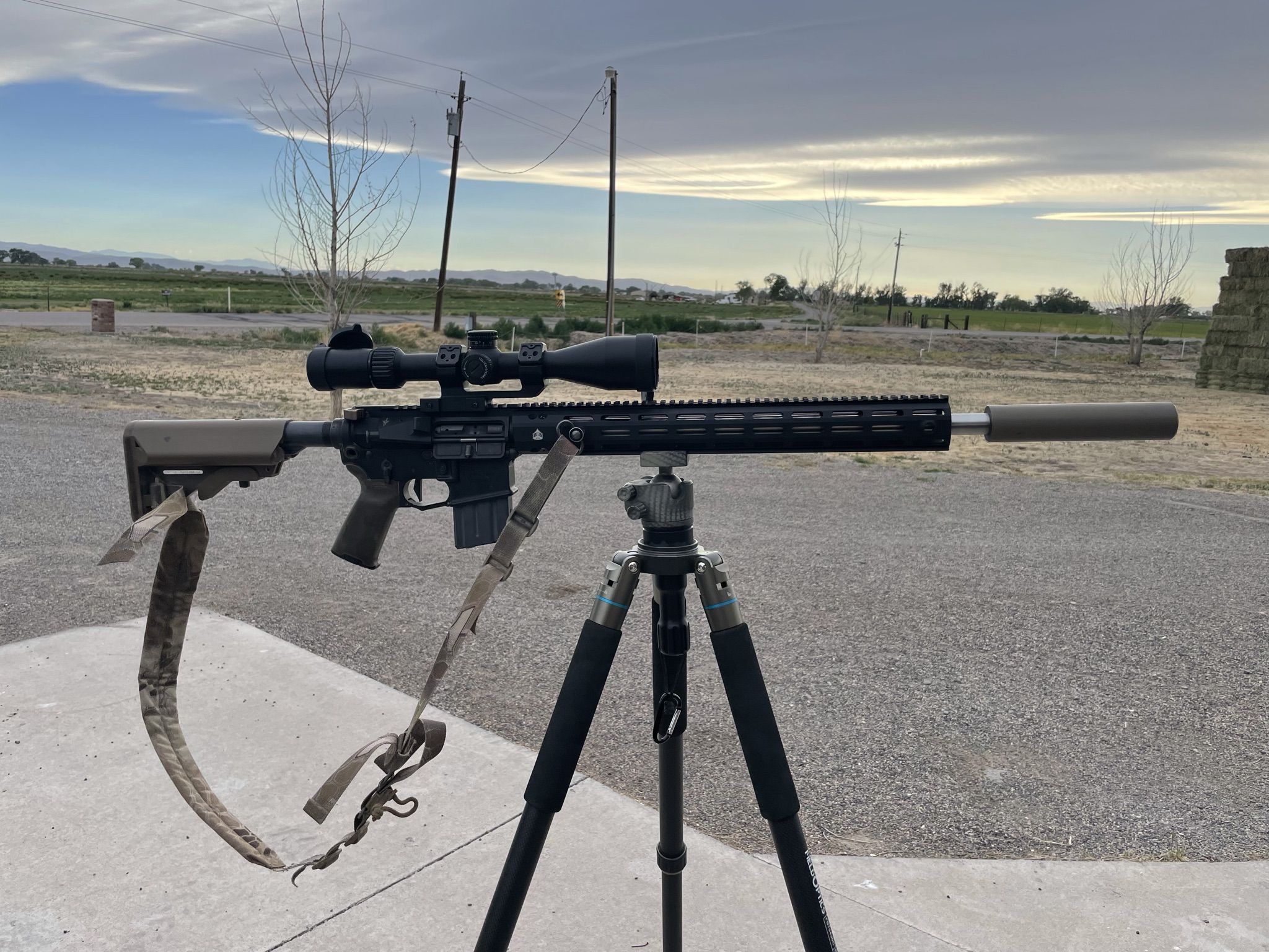

Compass lake did mine 20P barrel. Dogtowns are running around 3900fps. Hardly any recoil and an absolute hammer
Compass lake did mine 20P barrel. Dogtowns are running around 3900fps. Hardly any recoil and an absolute hammerView attachment 7784710
