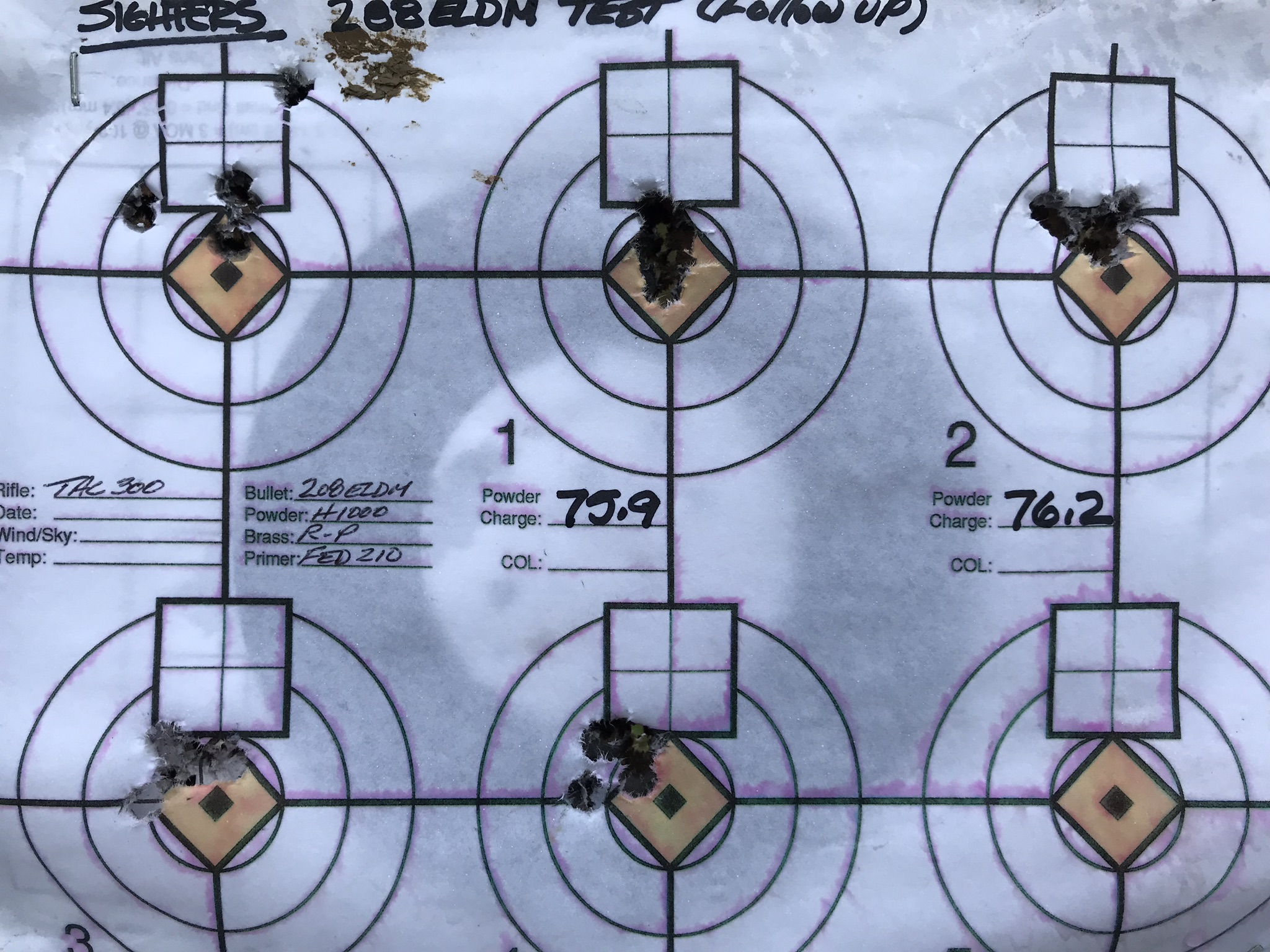

I have had phenominal results out to 1K using the AMAX in .300wm. The load is 76.0gr H1000, R-P brass, Fed210, and the bullet at .030 out of a Stiller and 26” Bartlein. Getting 2905fps. Obviously, my supply is running thin. I picked up a few boxes of the 208 ELDm and did a load work up. Surprisingly, (or maybe not...) it ended up at the same charge of 76.0 using identical components to the old AMAX. The only difference so far is a slight (50-60fps less) difference in MV. My last step is to try various jumps to see if there is a difference in accuracy. Right now, at load testing ranges of 100yds, this too is pretty identical.
So here is my question. Has anyone have experince with the 208 ELDm at distance (1K and beyond) and what has been your experience with this bullet compared to the old AMAX of the same weight? My thoughts are that eventhough the MV is slightly less, the advertised BC of the newer bullet shoud more than overcome this past about 600yds or so... unfortuneatley, time has been at a premium, and I”m not certain I can complete the needed testing before the snow flies and the temps become a factor.

Not sure on the COAL. I’m jumping them .010. The AMAX was jumping .030. I can get the numbers for you later. Not around my data right now.
It’s more than the tip. The profile of the bullet is visably different.

Just finished up the 208gr ELDm tests. The .010 jump won out. Surprisingly (or not) it’s the same jump the rifle prefers with the 225gr ELDm as well. The old 208gr AMAX favored .030. I’ll have the ELDm out at distance within the next 2 weeks (1K yards) and see how they both hold up out there.

Got the chance to compare both at distance this week. Distances were 300yds, 600yds, and 980yds.
The bullets and data seem to be interchangeable. Both using R-P sorted brass, Fed210 primers, and 76.0gr of H1000. The old AMAX jumping .030 while the ELDm is jumping .010”. Speeds are within 10fps between the two types. Like the AMAX, the 208ELDm seems to be a solid performer for the rifle.
