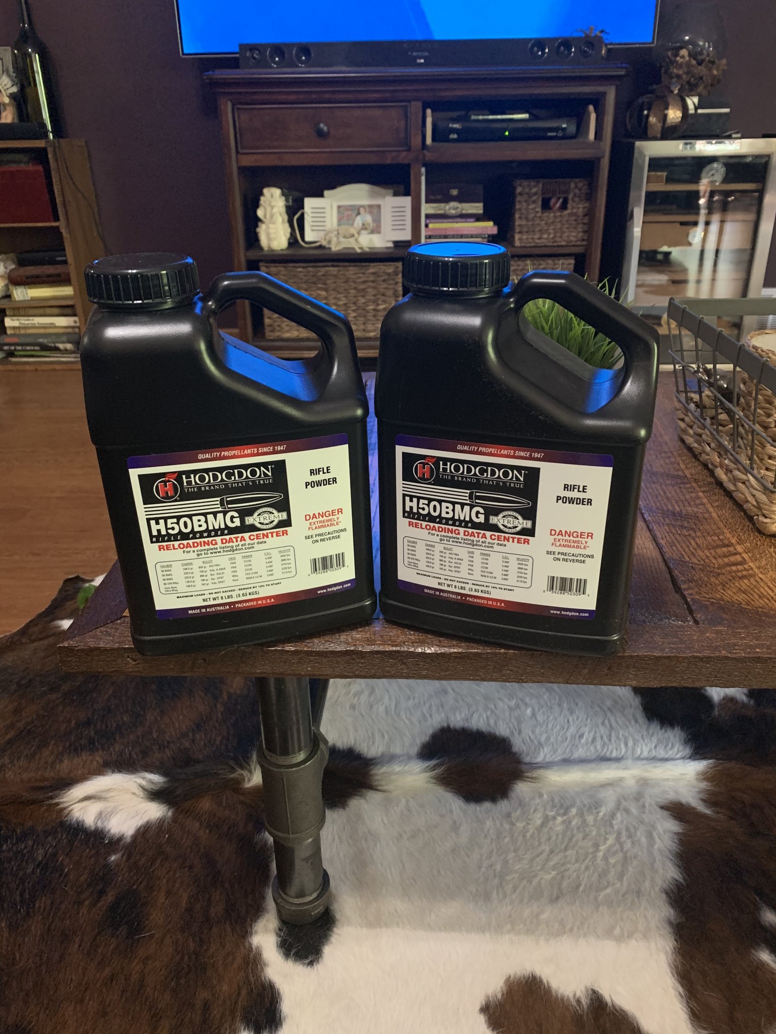

Since when did H50bmg get cut off from import? There was just a big shipment last month to all the distribution here in the US.
Nope, that’s me. They had a change of heart late summer. Brought it back. Thought you saw this pic

Geno is correct. H50 Is back for a couple months now.
Reactions: AIAW
Damn. I’m glad it’s back. I even Google searched for “H50 coming back” before I posted originally. Not sure why I missed Geno’s post about it being back.
