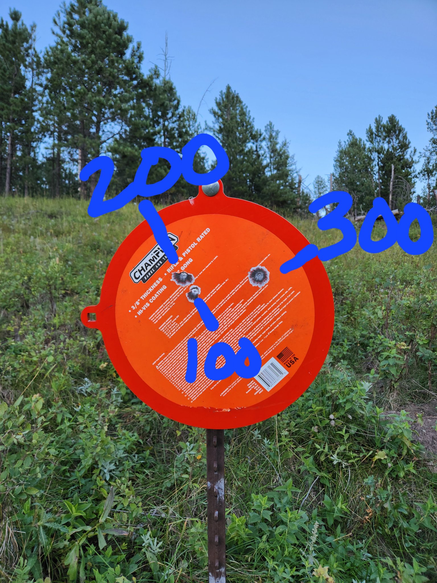

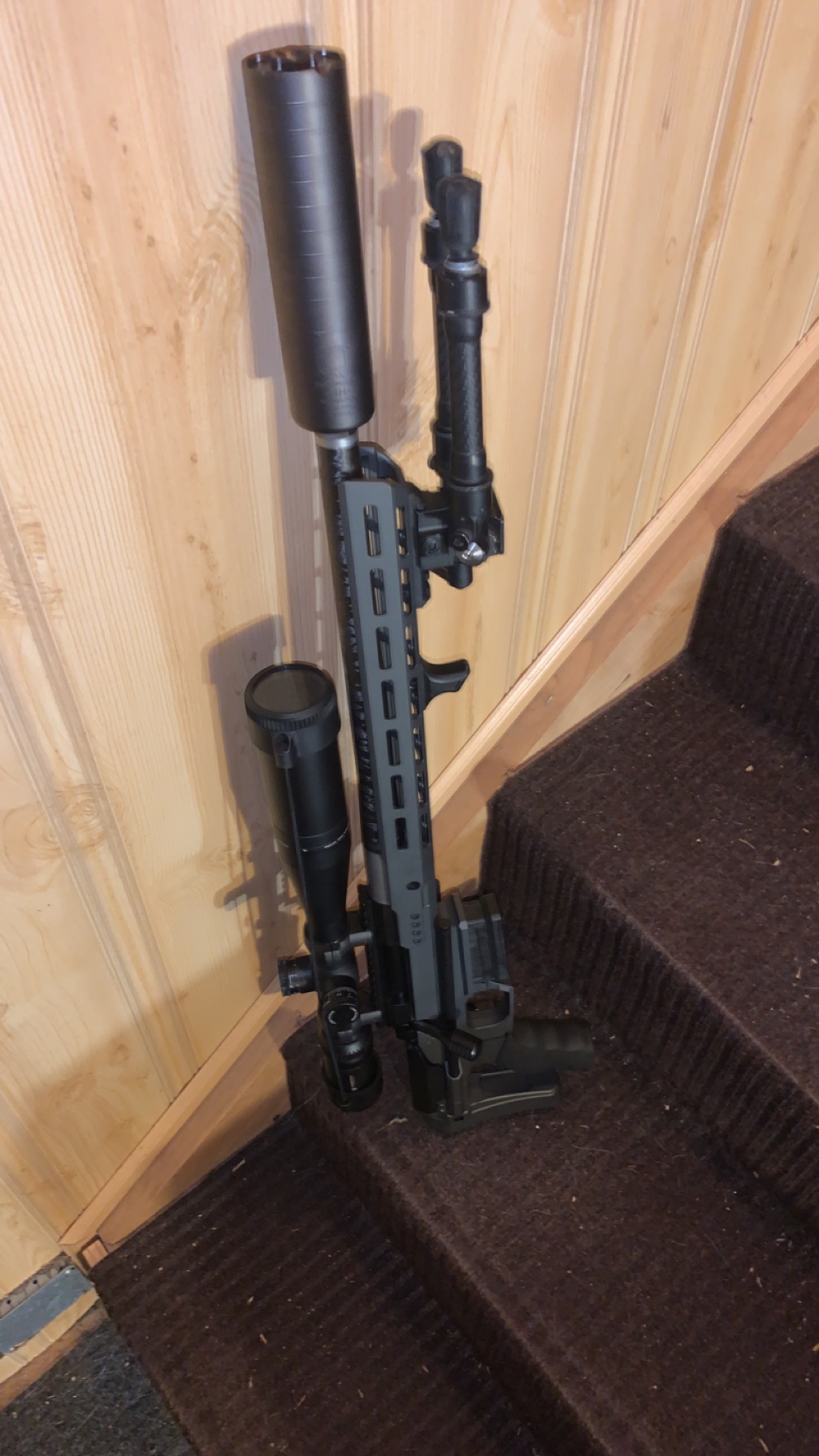

I chopped and threaded my 22-250 on grandpas lathe last winter since it wasn't threaded before. I havnt chronoed it, and to be honest the biggest reason for shortenening it was to keep it a smaller package with the can on. I used a fresh plate the other day to check drop and this was what I came up with off the tripod pictured. Point and shoot on dogs out to 300 is good enough for me. I've got a feeling ill be trying 400 out in the field by the end of the winter!

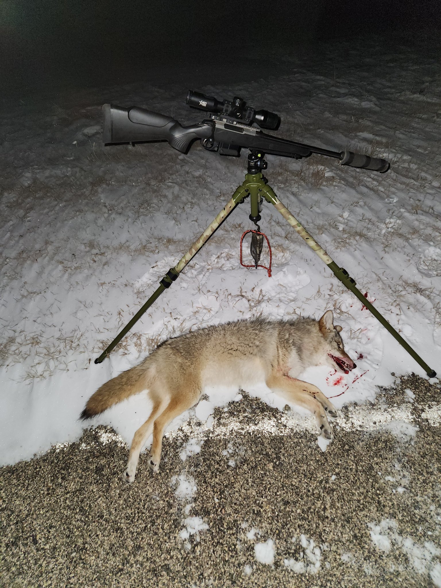

View attachment 8223223View attachment 8223225
What length is this?

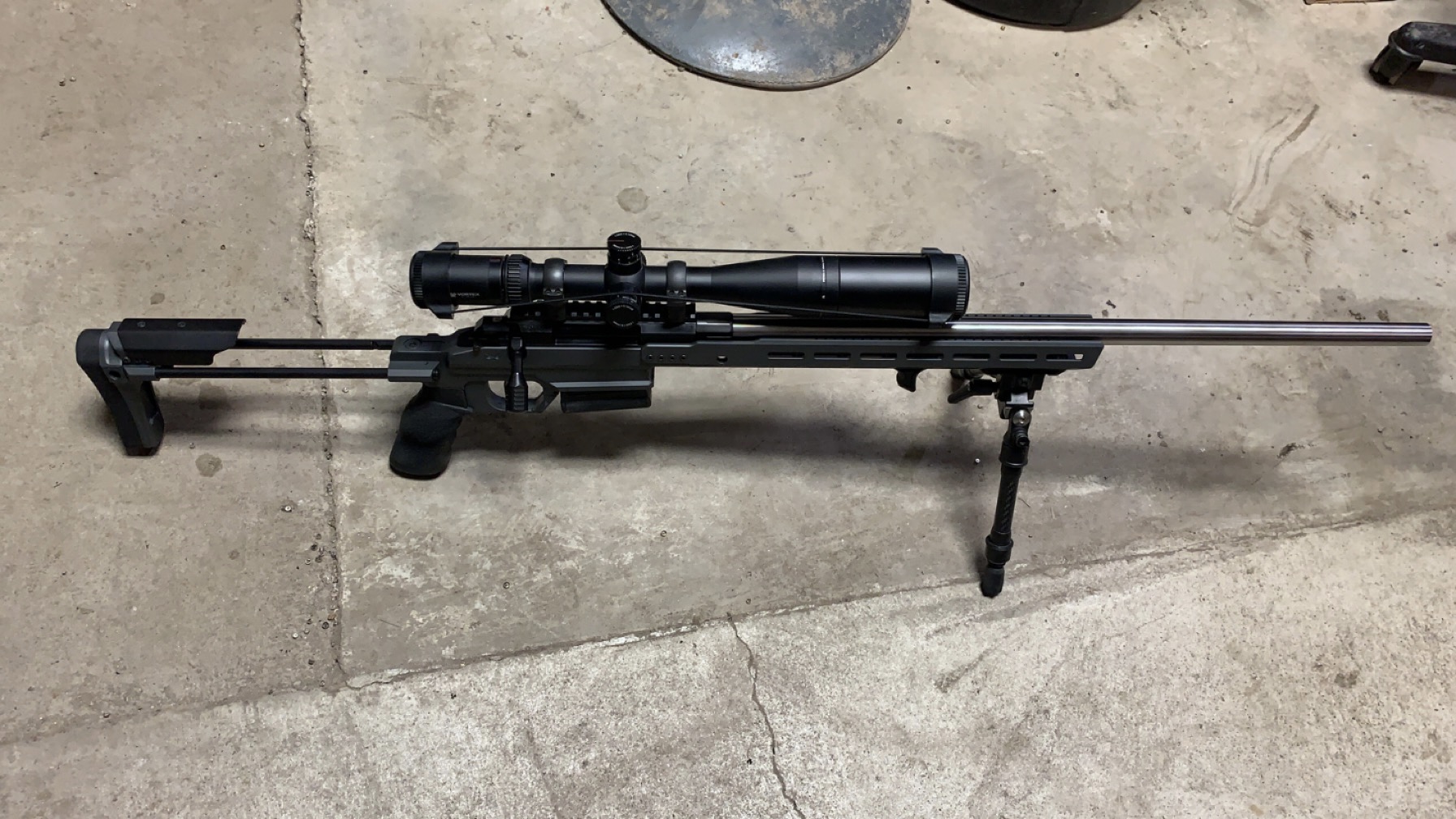

Following as I have a Tikka T3x Lite 22-250 all factory that I want to chop. My initial thought is 18"
50 grain Vmax's as well for me.

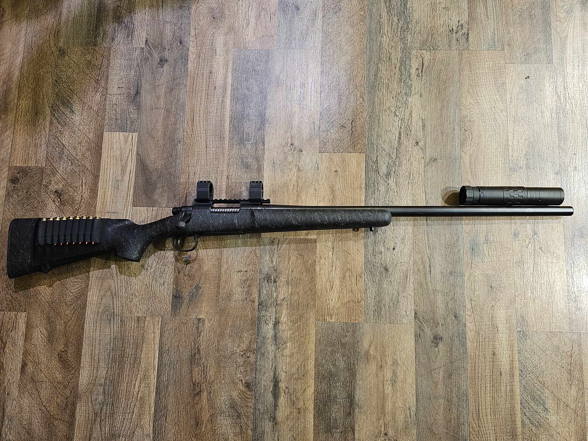

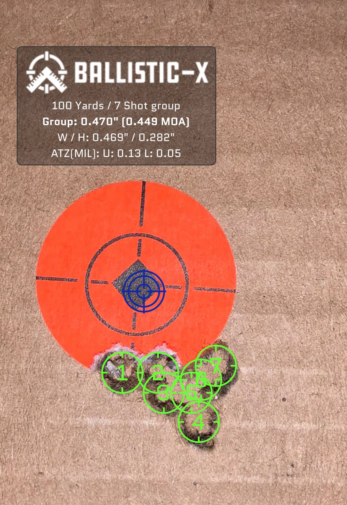

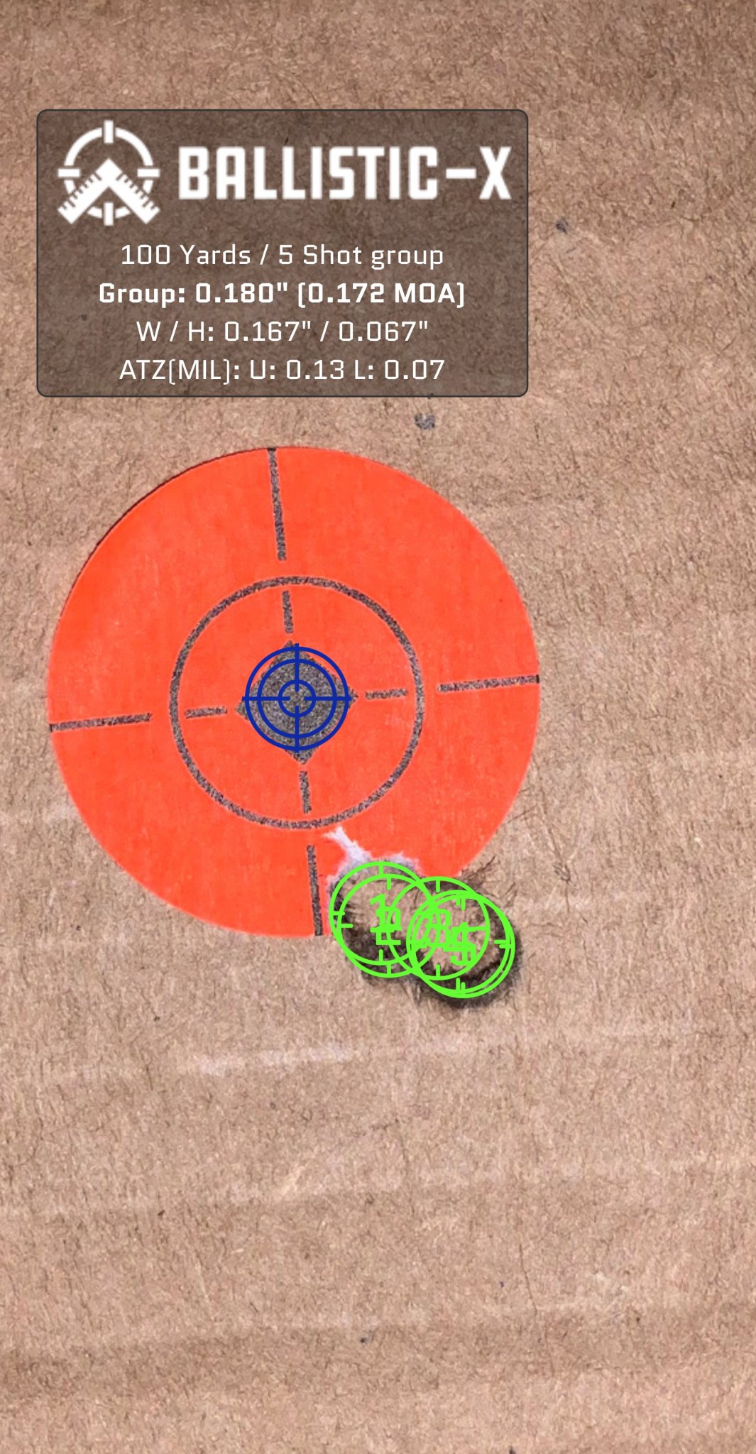

You will definitely want to find some fast burning powder. I’m typically seeing a drop of 390-440fps from my 26” to the 16” 22-250 with the same 1-7 twist and a larger s-d.
