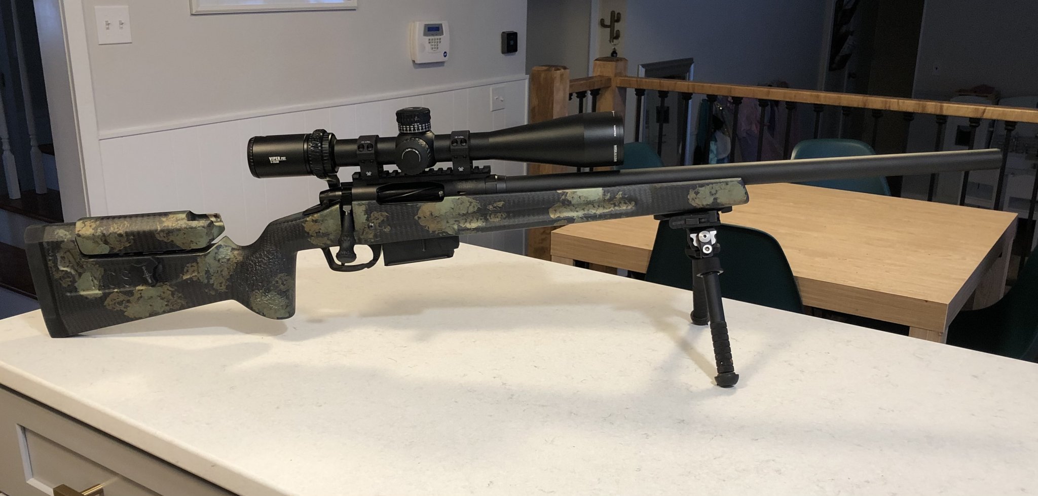

    Something to remember, when you go that short it substantially increases how loud they are. I shoot my 18in 22-250 suppressed which makes it manageable but without a can on it, ouch, it be L O U D!

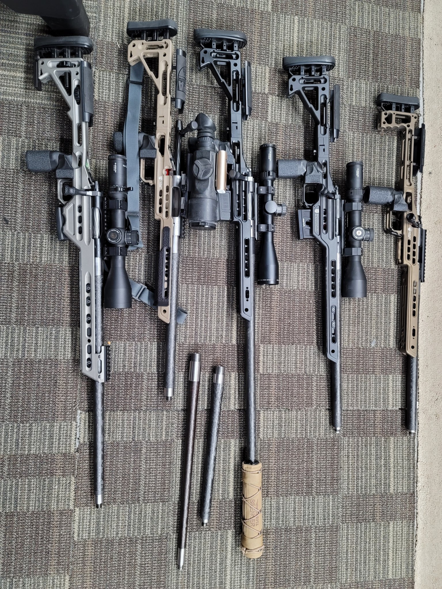

    I recently added 2 more 6.5 carbon barrels and a 18" carbon 6 barrel destined to be a 6x45 to replace my Tikka I sold in the same clambering. And I have in SS, proof and bartlein barrels. I might have overinvested in TL3 barrels, but I think they are the best for my purposes.

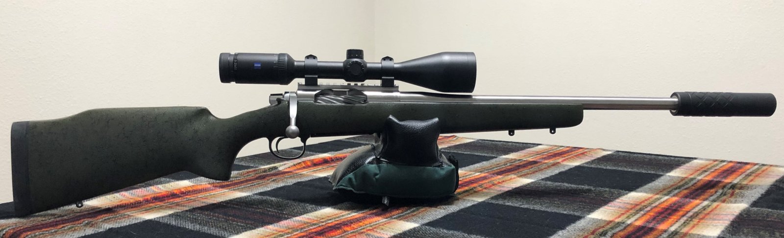

    I love them. What caliber is the one with the thermal? do you use it for hunting?
    6 creed with shortened freebore. Running 65 vmax at 3550fps. To save bullets, I switched to my 22 creed since I now have enough bullets to burn out that barrel completely.
    Nice, that is awesome. How long is the bbl?
    How do you like that stock? Whats the weight of that rifle?

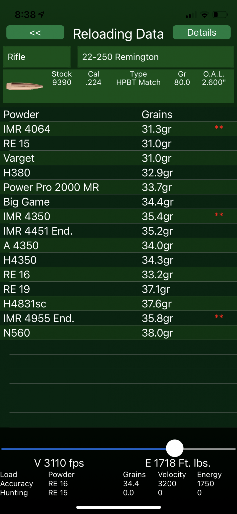

    Download the Sierra reloading app- has some free data and 22/250 up to 95 SMK.
    Here’s an example with the 80 gr SMK. Red asterisks are Max loads. You can play with the app a bit and it’ll show you the range of charges for the powder.
    Reactions: BigTy313
