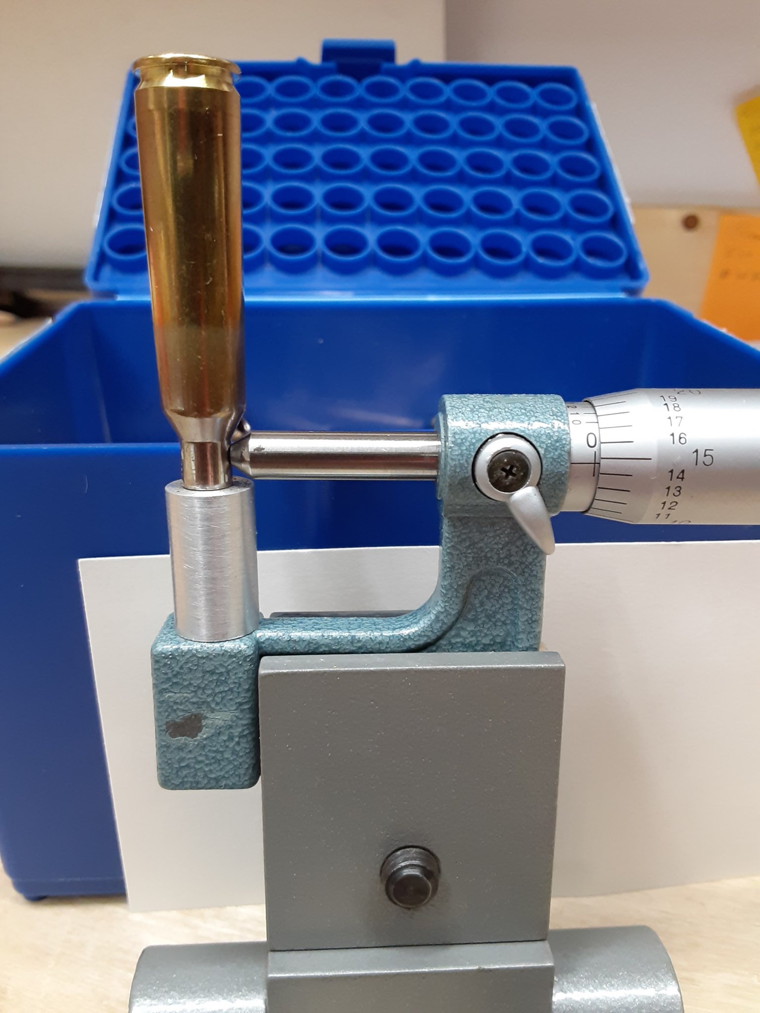

Nodakplowboy Going Forward Supporter Full Member Minuteman Mar 4, 2017 1,093 2,699 Nov 11, 2020 #2 Nov 11, 2020 #2 Here you go. Lot #2223217, purchased 10/18, zero prep, right out the box. Measured 3 cases every 90 degrees using the below setup. Results: High- .0146" Low- .0140" Avg- .0143" +/- .0003" is pretty good brass. Hope this helps. Reactions: 7P's and spife7980
