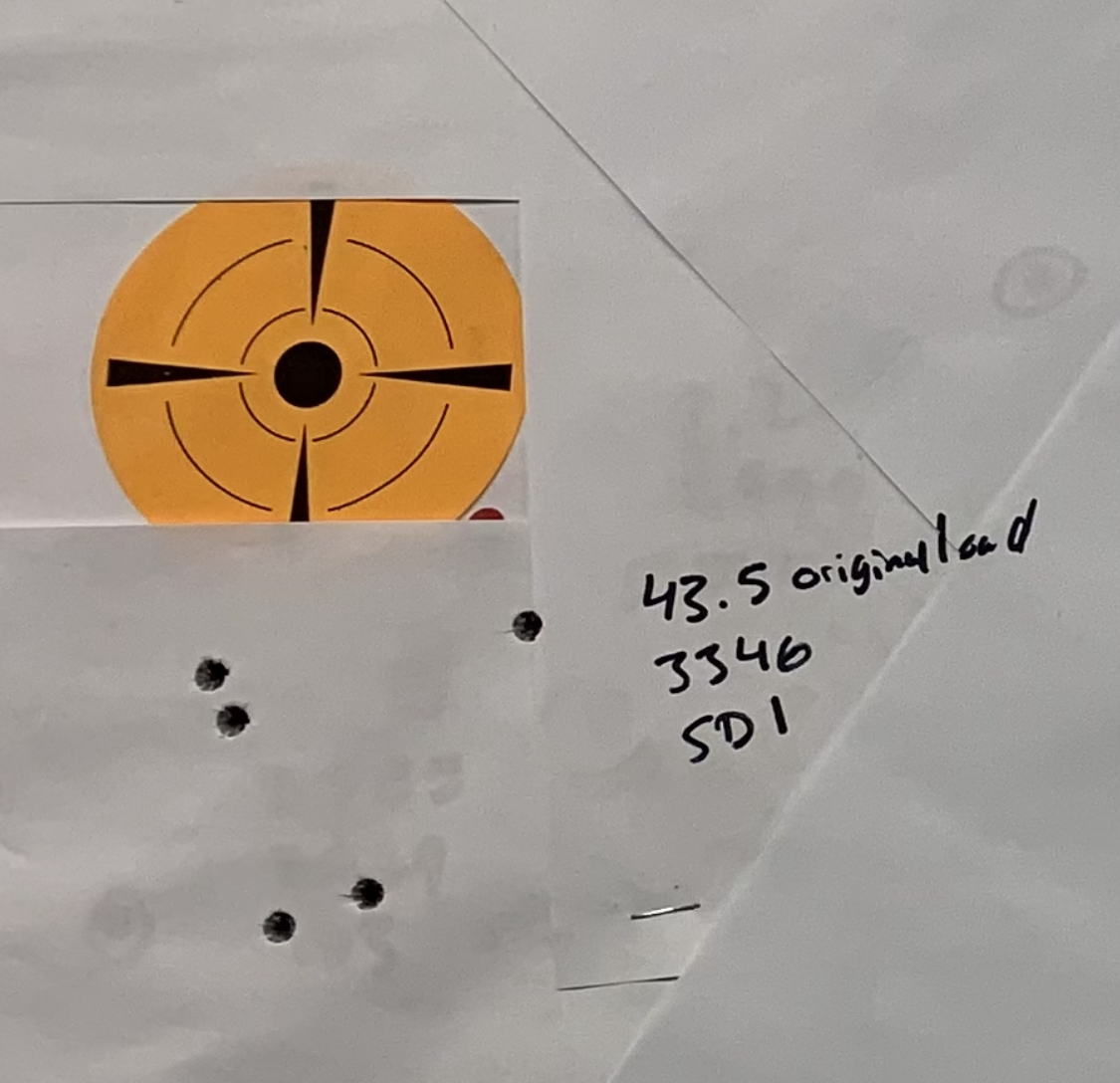

Im 26" 7 twist shooting 85 rdfs at 3400 when new and 90° during the summer and now its 3450 at 40° with alpha brass and rl26.
I have 700 rounds on this barrel and its still shooting 3" at 500 in 5 rounds groups during a load development check though just like it did at 100 rounds. Unfortunately Ill not be shooting it for awhile as I am out of small primers to use it with so I cant really speak to how much longer it will go at this point. But its awesome. :love:
